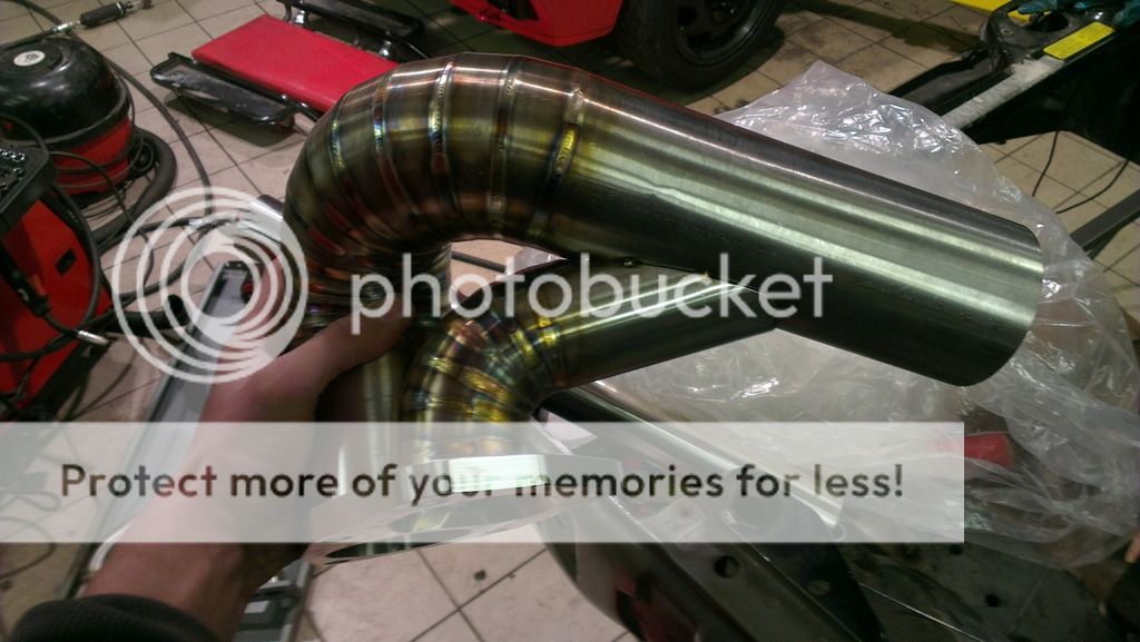

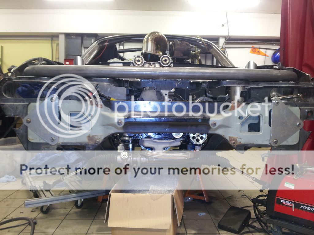

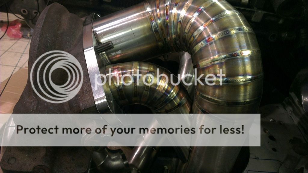

Not much in the way of an update I`m afraid, got the wastegate plumbed into the downpipe but forgot to take pics of the fully welded piece. I went from having loads of time to non and I`m not sure how it happened, small jobs took way longer than planned!

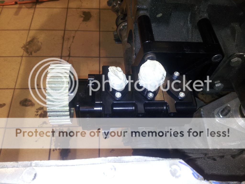

My dry sump kit arrived

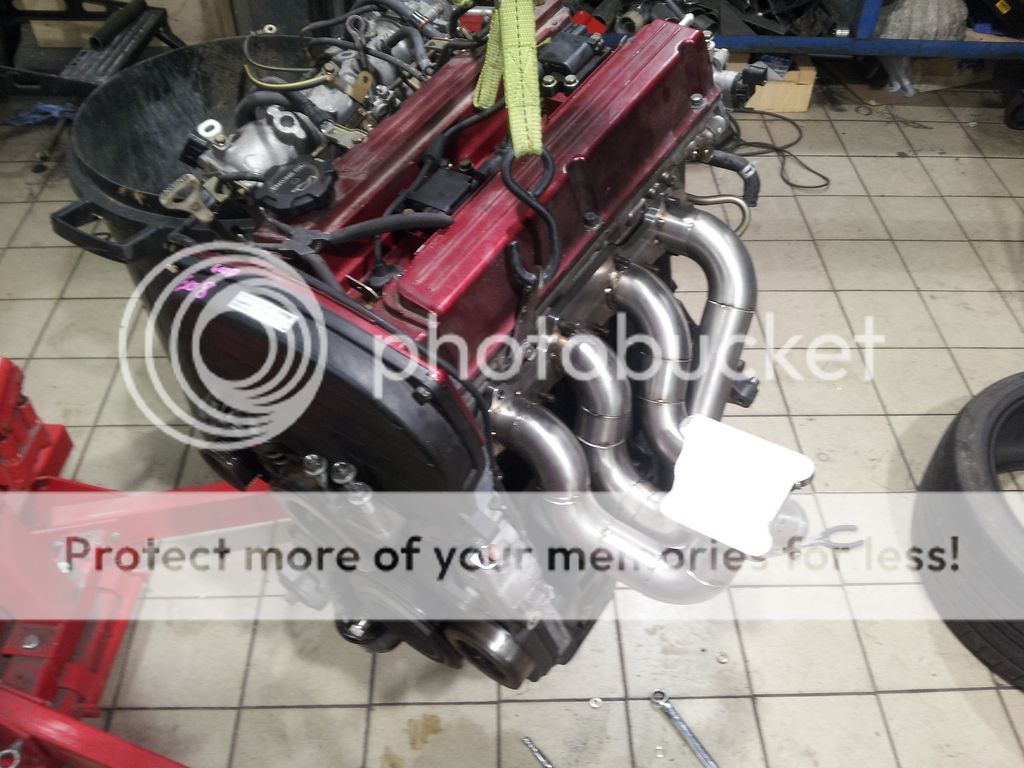

Whilst fixing the oil surge issues and simplifying some of the build its also added in some extra challenges. Part of the exhaust manifold needs tweaking, I`ve had to move the subframe brace and also relieve areas to run the scavenge pipes from the sump, plus moving the engine up so the sump cleared the rack was not something I really wanted to so. The only alternative is hacking into the nice new sump which is a last resort really. Moving the engine is a cheaper/easier option so I`ll try and see if this works. Crank centre lines of the new vs oem engine are withing a few mm so the overall impact on the package should (fingers crossed) be negligible

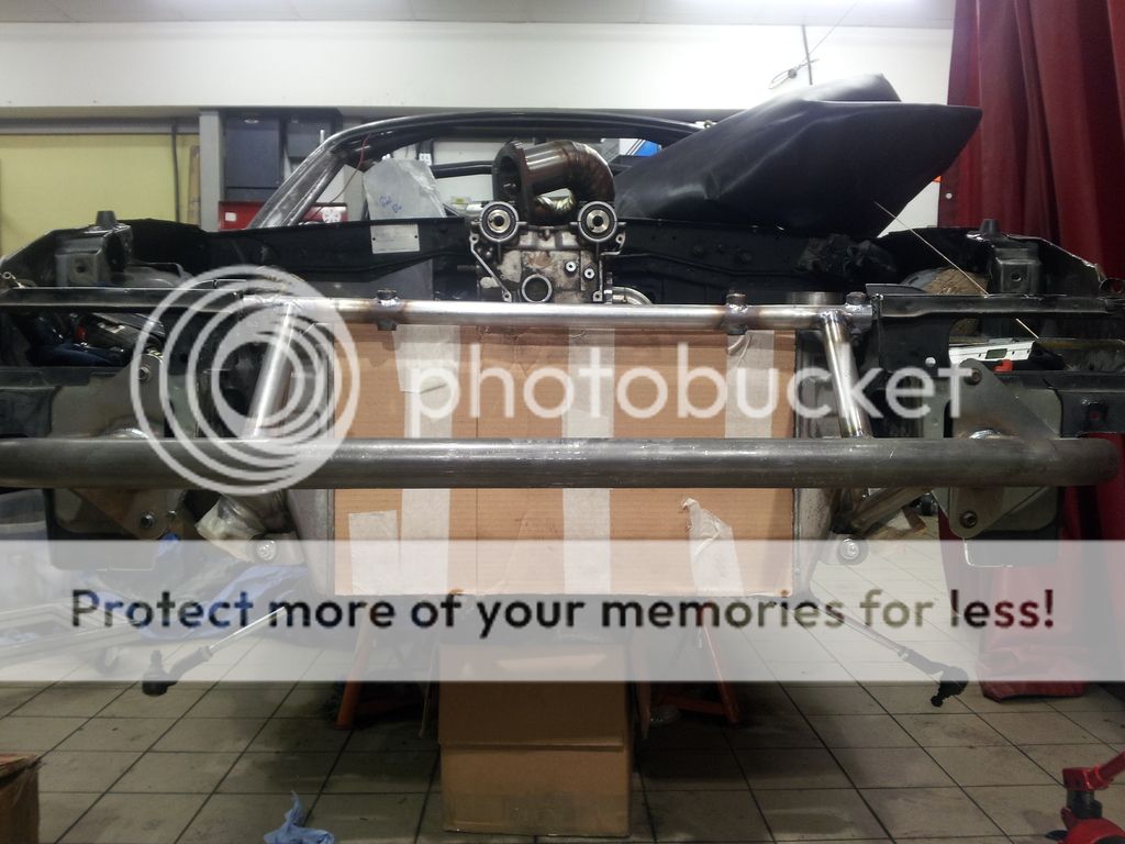

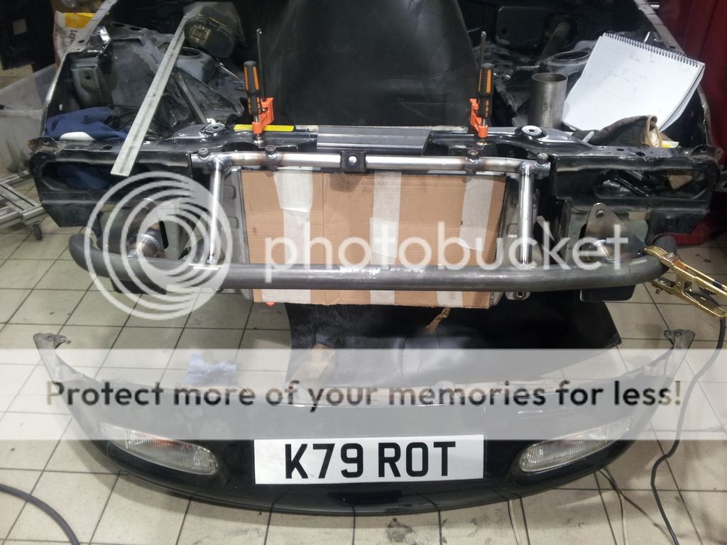

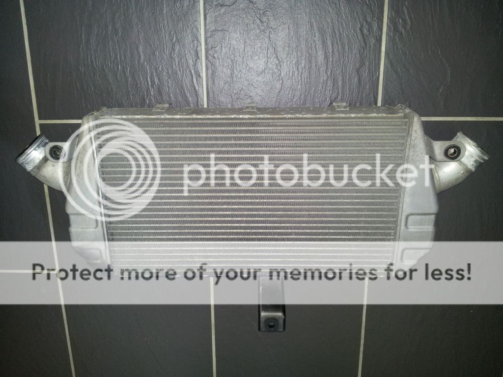

I picked up a standard intercooler for the evo engine and set about making a removable front end to act as a crash structure, bumper support and to hold the rad and ic
The ic is massive so the bumper is going to require so mods to allow decent airflow
Then last weekend I took a road trip to Jap Performance to pick up a low mileage evo 8 engine with ecu, loom and all ancillaries. It came out of a running car fresh from Japan about 12hrs before I picked it up!!
And thankfully the manifold fits

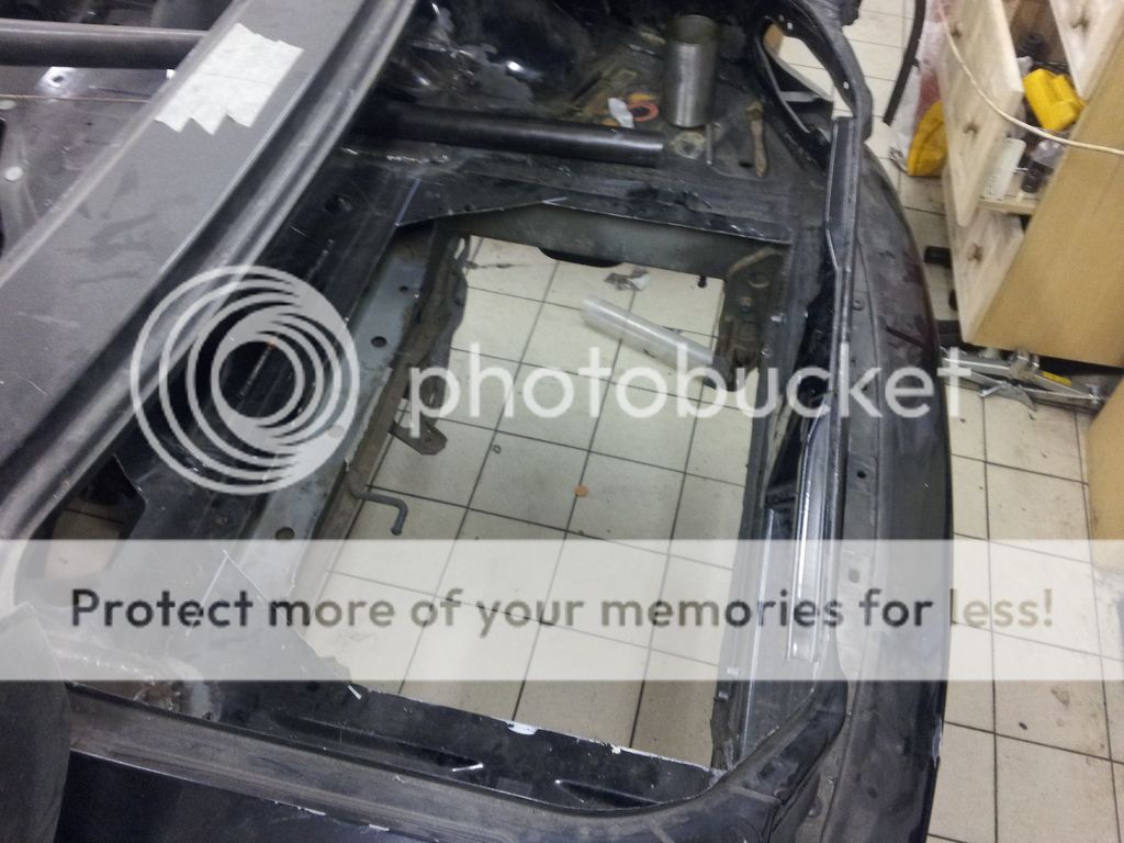

The gaping hole in the boot floor needed some attention so after a bit of after hours bead rolling at work I had a nice ali panel with added stiffness
I managed to tackle the time consuming task of installing the pedal box plate, clearancing the bulkhead and filling surplus holes, I hate grinding and mig welding!!
from this
to this

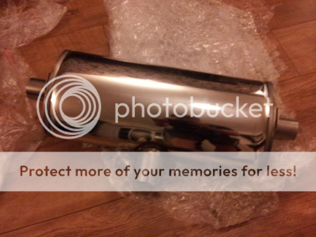

Theres also a fluidampr to fit, inlet manifold to make once the bits have cleared customs. I`ve also got this exhaust (well, this needs to go back as they sent the wrong config of inlet/outlet size) which will be mounted in the space where the spare wheel well was and the entire under car system to make. Plus all the wiring and routing which I am not looking forward to!

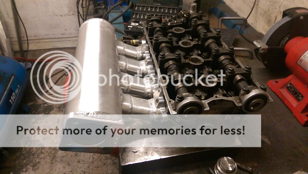

So 6hrs and 17m of rod later and I have an inlet manifold. Still needs a few bits cleaning up but its pretty much there, just need to drill the vacuum take offs

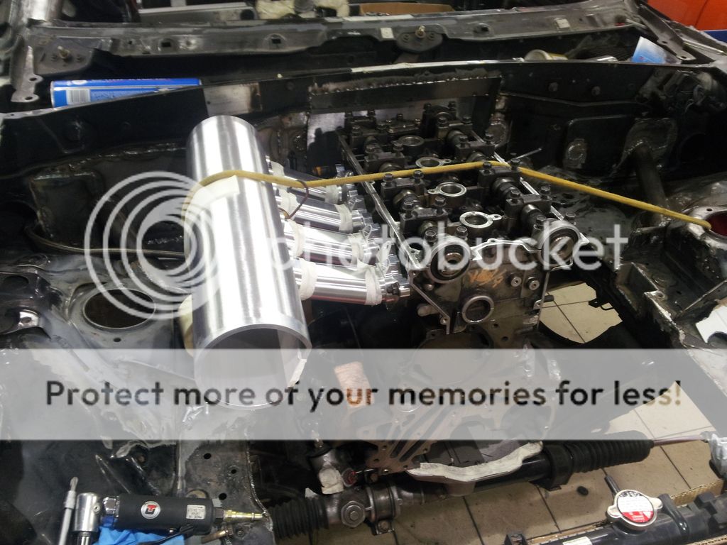

Mocked it up on the dummy engine first
Then started throwing the rod at it, the d shape extrusion is about 6mm thick so it it took a huge amount of heat and rod
