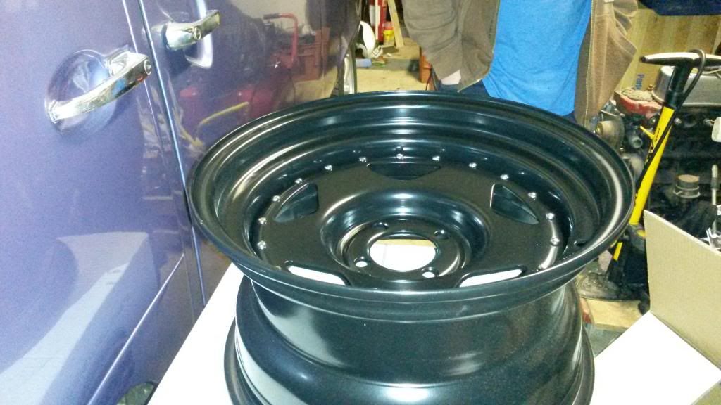

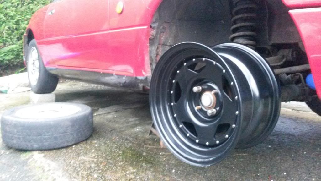

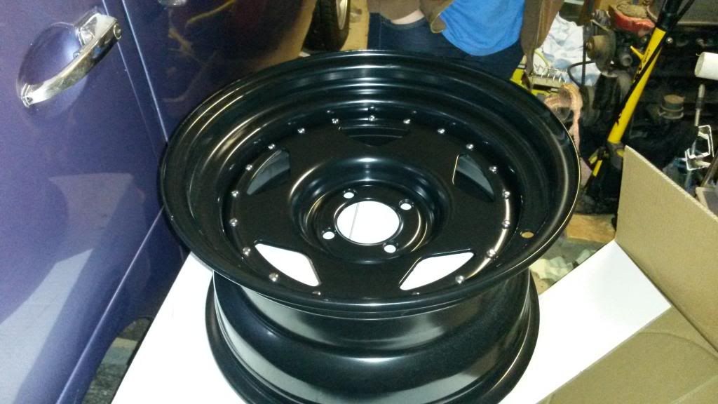

New wheels, woooooooooooooo :drool:
They are steel, so extremely heavy and function over form is very much my style. But I really had to have these, at ÂŁ240 a set brand new delivered I couldn't pass it up.
Also I need the ET0 offset for the latest project by a friend of mine...... billeted hubs, already started reverse engineering an original set, as to make some with greater lock and zero effects on geometry when lowered.
Wheels are 15 X 8 ET0, with a 3.5inch dish.

Don't be scared to run plenty of rubber on those bud, 8j et0 fits fine under the arches
See I haven't run stretch tyre thing before, whats the best. Ideally I want to maximise tyre width, 195/45 is what I was think, really I want 205 wide.
Happy to roll and hammer my arches around.
Discussion starter · #169 ·
Like the wheels mate seen the company on Facebook do some decent offsets and big dish :)
Cheers mate, a chap on here told me about them. You know, because Im to good for facebook :lol:
195/45 will give good feed back but 205 better. But with 205, if your running lowish you may need some arch work yes. Saying that I'm running 205 on a 9j et0 with just a small role

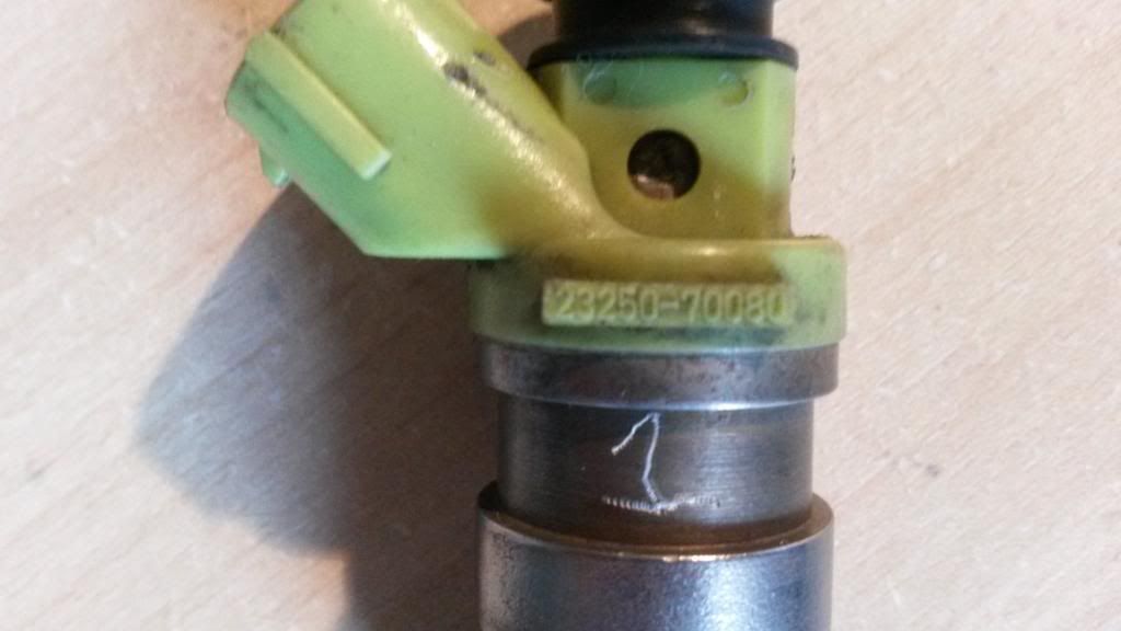

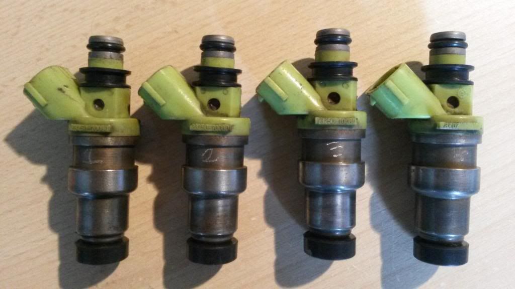

Nonetheless my injectors came back from Autotronix Developments, they went away filthy and I was doubting their capability, but they were actually flowing rather well.

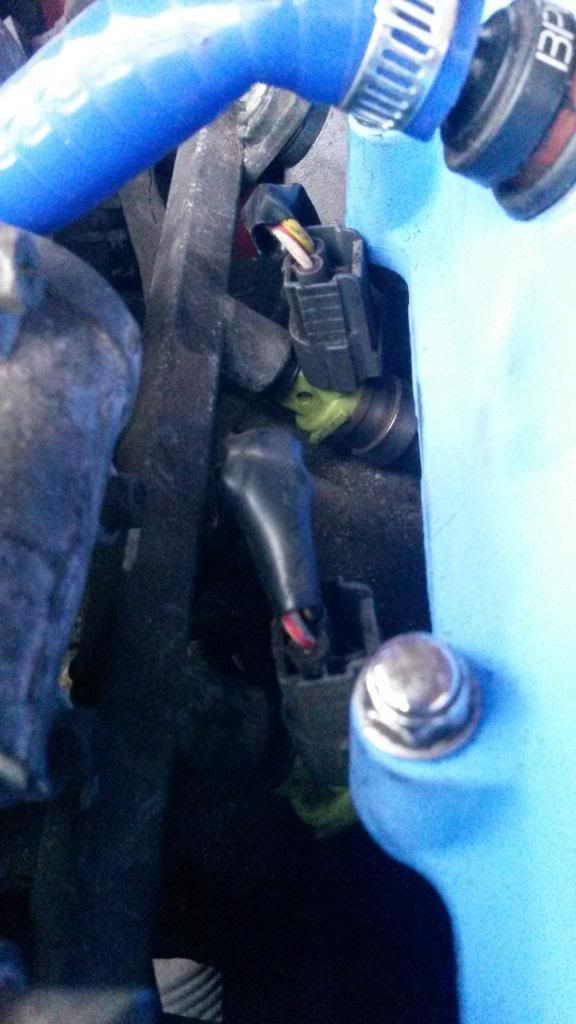

Being 320cc they are somewhat limiting now im running Megasquirt MS1, but its a start and will allow me to upgrade diff and clutch before winding the boost up.
Bit of a pain in the arse getting the old ones out that hadn't moved for 22 years, but in the end they are in.

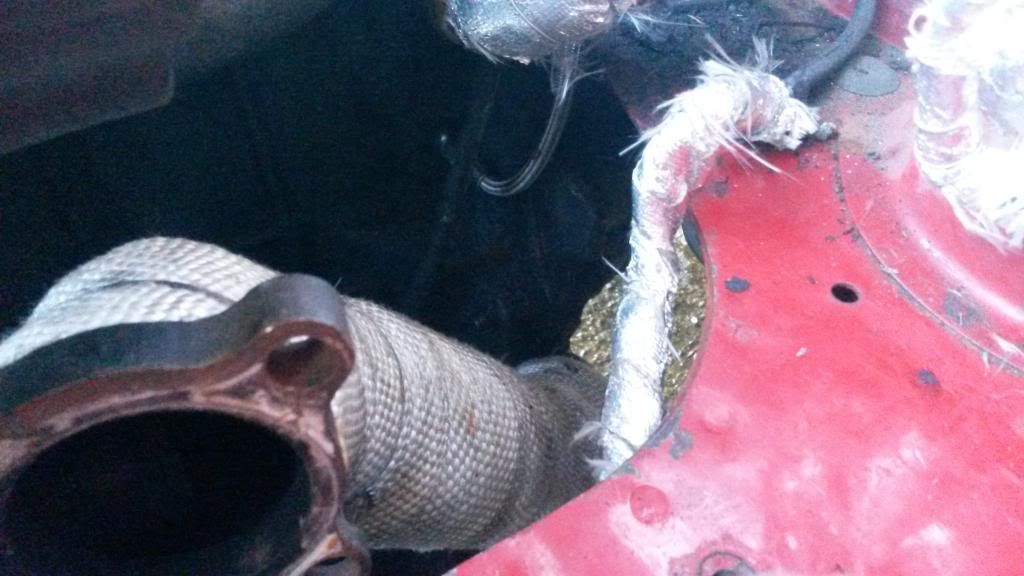

Heat wrapped the brake line seeing as it is so close to the down pipe,

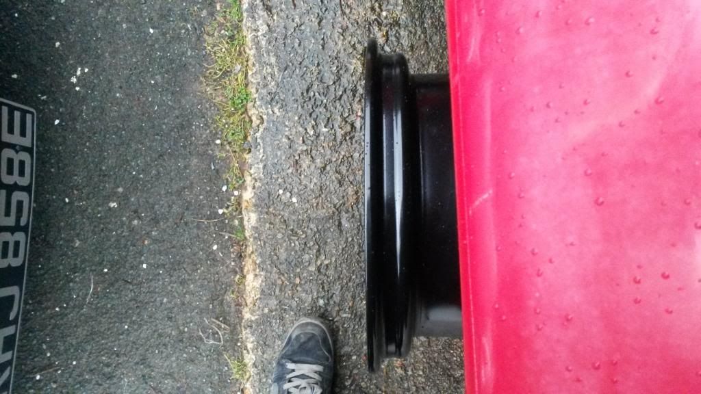

Eyeing up my new wheels

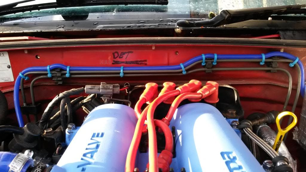

Also I neatly routed my vacuum points for the MS1.
Apparently stickers are for children.... so I use permanent pen :D

Also, how much was it to get the injectors cleaned? My unc is having issues with his oil burner and apparently it's injectors so I figured he could send them off for a good clean.
Just had a quick skim, sexual! I shuold probably get a build thread of my car up lol.
Cheers bud, basically page 1 is all drift photos and stuff, rest it turbo buildness.
ÂŁ45, for cleaning, flow testing, and replacement seals.
