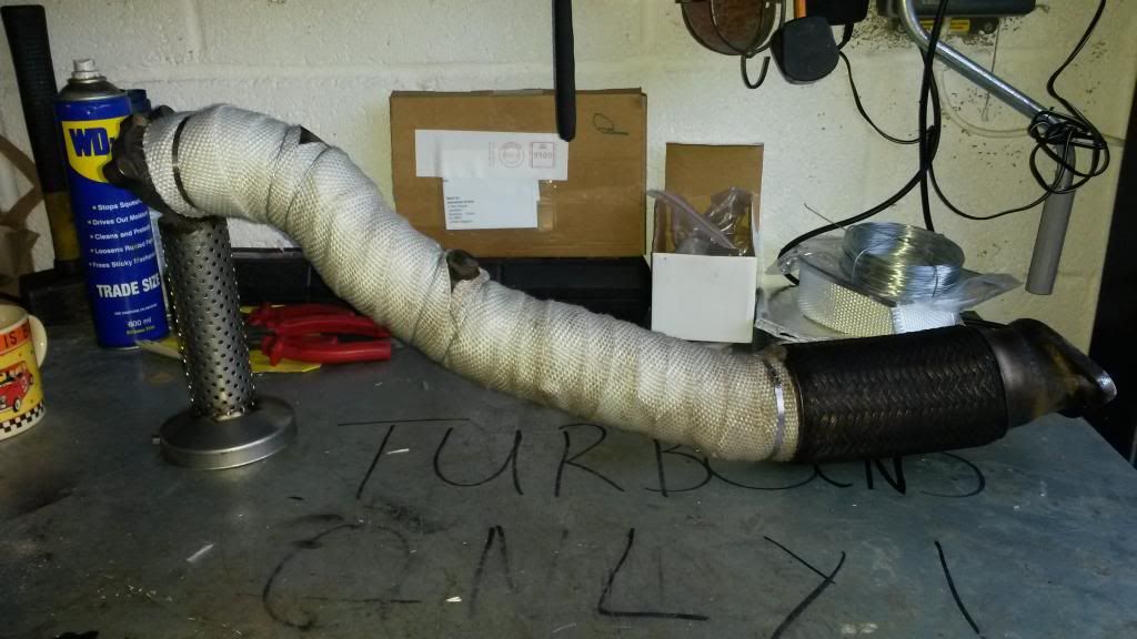

Yeah mine might touch as well, haven't checked that. I just like the look of it really, best to wet it when you put it on.
#104 ·
I've only wrapped a mild steel tubular manifold before, not turbo, and it cracked, and like bd said, with the chances of oil leaks sod having an oily rag wrapped round a toasty hot metal pipe.
I plan on shielding around the manifold and things that might get burnt.
#105 ·
I've had a group A manifold crack on my old rally car where it was wrapped. Hadn't seen the oil comment, and a good point... I think I'll fit a thermocouple in that area and monitor the temps and see how it goes.
#106 · (Edited by Moderator)
Ohh fuck it, looks like it coming off then
MT.net;
Wrapping the downpipe to reduce underhood heat will prove useless. 80% of the downpipe is under the car, not under the hood. The material of the downpipe will deteriorate very rapidly if insulated. If your downpipe is mild steel, I'd suggest it will not survive more than 2000 miles. Stainless, maybe 5000. It will actually "flake" away and break into pieces.

That's it its coming off, waste of ÂŁ12 :censor:

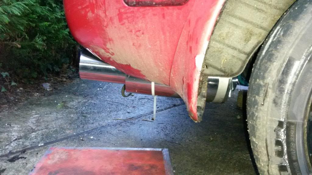

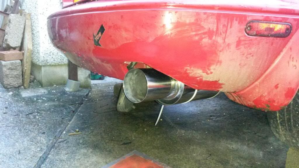

Nice work, that's quiet a short back box you managed to source as there isn't much room going that way, a matter of opinion but i decided not to wrap my downpipe as my engine loves to weap oil lol, looks good though keep it up
This is the back box http://www.ebay.co.uk/itm/221098551025?var=520104791565&ssPageName=STRK:MEWNX:IT&_trksid=p3984.m1439.l2649 Nice bit of kit really, I think the guy must make them as opposed to Made in China.
440mm long it is, will weld a 90 elbow on the end, short straight pipe to take it beside the diff, then 90 again to return all the way to down pipe. I have got the original exhaust lying out and a 12 tonne hydraulic pipe bender, so I can get all the little tweeks and bends spot on.
Comes with a silencer bung as well which is pretty cool, can quieten it down if need at track days. Seen holding my down pipe up.

#112 · (Edited by Moderator)
MT.net;
it looked pretty though lol

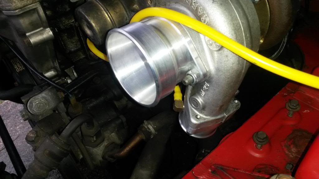

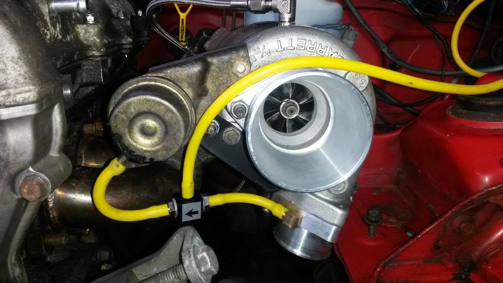

Intercooler pipe work on, went on real easy. I had to trim down some of the silicone 90's a little to keep it out of the way of the wheels on full lock.
Any reasons I shouldn't have the run touching a heater pipe and power steering pipe? My understanding is they wont get hot enough to melt silicone.
Cold side as per Dans' instructions;
Hot side, different to instructions (I think), swapped some of the Alu pipes around and it worked out really well. Didn't want to cut the Alu pipes as they had been beaded;
