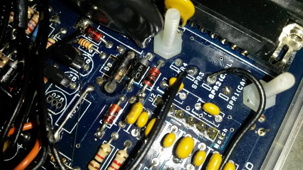

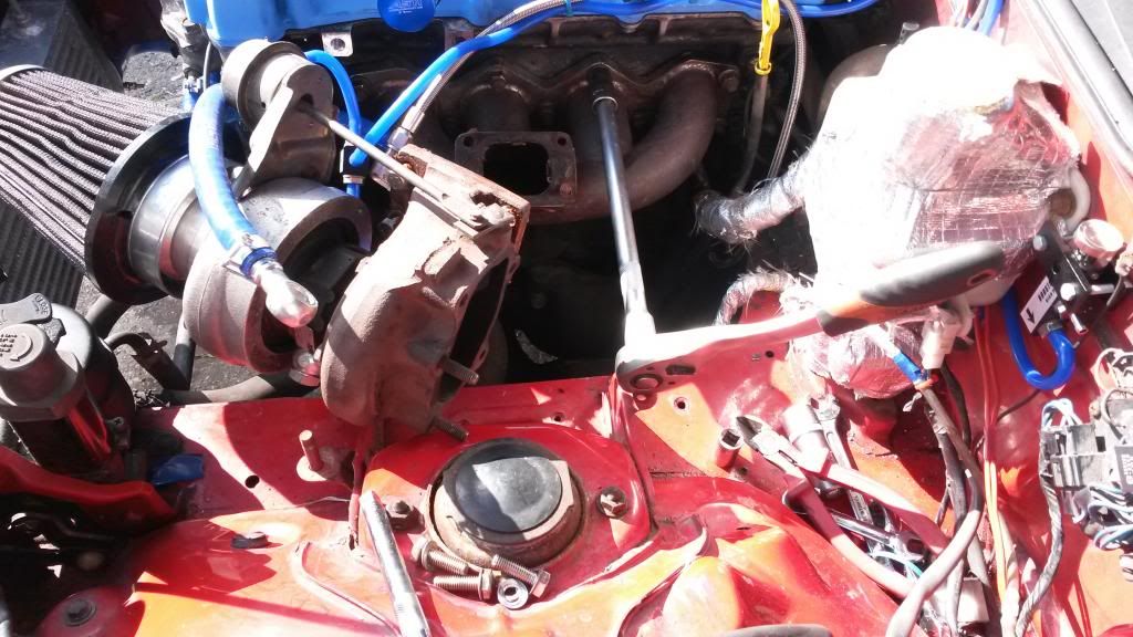

Soooooooooooooo....
Started with this;
Then got to this;
And that was it :cry:
All was going to well, then for some reason the megasquirt stopped seeing any RPM on the laptop. Then it stopped sparking... Tried a new coil pack the tuner had lying around, but still not luck. For some reason the megasquirt just changed its mind.
Managed to do a bit of research into the problem, and it seems to be linked and relatively common. Need to do some testing and more research into why this has happened. The tuner was pretty helpful and only charged me for an hour, and we did get a small amount done.
The quest continues...
#401 ·
Alex that's gutting!! I feel for you... You've got me worrying what might happen to mine on Sat now.
Had any joy since? RPM is fed from the CAS, then the ecu sends a signal to the amp and then grounds the coils. I'd start with your CAS, I had all this the other week, so feel our pain!
Yeah pretty gutted in all honesty, but its just a hiccup.
More enjoying was the ECU had a boost limit set at 0.1 for some reason. Hence it not liking any boost, so with that up it would of likely run rather well.
Just need to do a load of fault finding and see whats going, strange that it just dropped out????
