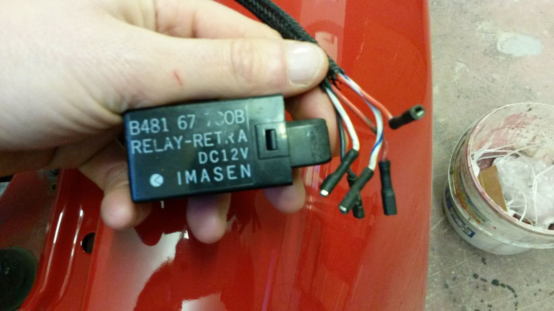

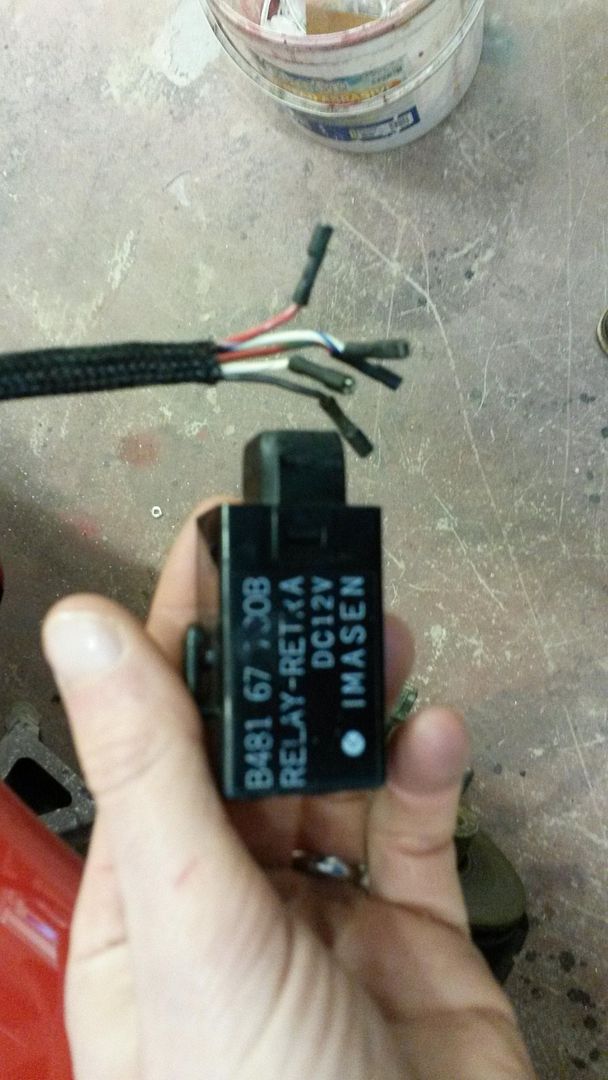

Hi guys
I pulled the wires out of this the other day... and now need to re-connect.
its the relay that pops up the headlights (i think)
anyone got a diagram to show / or picture on what wires go where?
there are 5 to reconnect into this..

Connector on the bottom has 6 pins in two rows;
R/Y XX XX R/L
W/R R/W B W/B
Where R = red, Y = yellow, L = Blue, W = white B = Black, XX = blank.
B = ground
R/L = power in from HEAD fuse
W/B = wire from stalk control
W/R = power out to console switch
R/Y = power out to popup actuators
R/W = (flash to popup?) wire from main beam headlights
Those are actually Miata wire colours. I'll cross check with Roadster colours but it may take me a while to decode the Japanese.
Anyway, I hope it helps a bit.
<edit> Checked. 1.8 Roadster diagram has the same wire colours.
