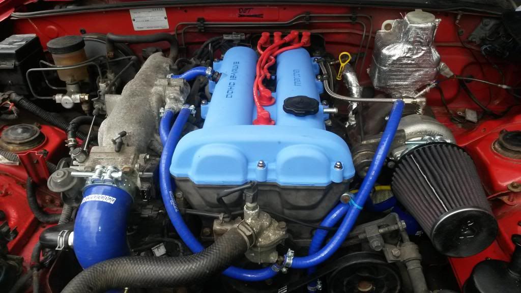

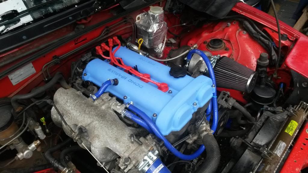

Not much to report today, turbo fully bolted down to manifold now with hi-temp gasket sealent.
Also fully installed the MBC, not really intending to use it to up boost massively, more as a check to reduce creep;
