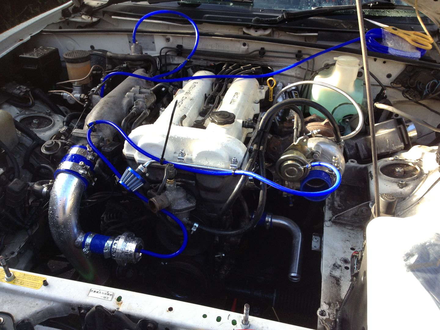

That's a massive elbow! My turbo inlet is 57mm, so got a 57mm 180deg ally elbow then a 57-76mm reducer for the afm. Will prob need to cut bits down once I have everything to get it all to fit.
I need to wire up my map sensor and make a turbo brace this week.
Engine bay looks a bit like this now.
7091DDEF-EE9E-4F94-B18A-7D451A94B2DE_zps

That is looking very clean I have to say, i'm liking the hard piped bends. Got a build thread link?
Also where did you source that vacuum tubing?
I have a build thread but there's nothing in it lol. Haven't touched it since this time last year... Will take me hours when I finally get round to it.
This is the auction 190893549922. Got 5 meters worth. Ironically I ordered it on wed and it was delivered fri. Cam direct from ASH. Going to call them tomorrow and find out where my reducers are.
