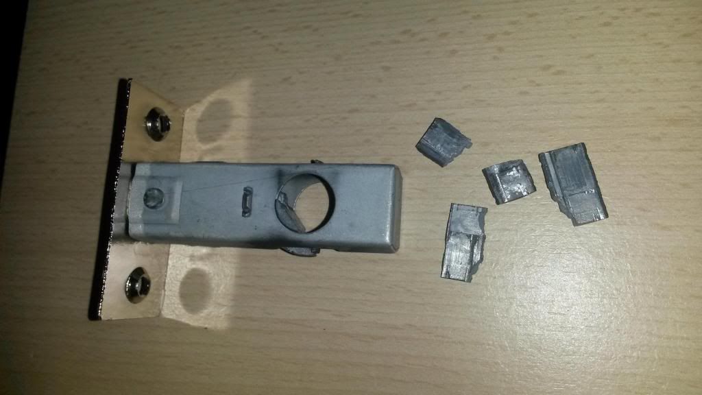

Also so bored, my door handle wasn't working... reason FUBAR barrel all broken up. So replaced that... now what to do.

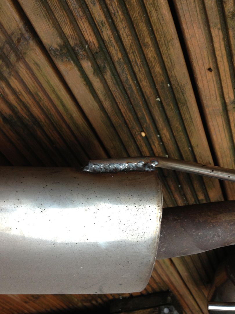

440mm long it is, will weld a 90 elbow on the end, short straight pipe to take it beside the diff, then 90 again to return all the way to down pipe. I have got the original exhaust lying out and a 12 tonne hydraulic pipe bender, so I can get all the little tweeks and bends spot on.
Comes with a silencer bung as well which is pretty cool, can quieten it down if need at track days. Seen holding my down pipe up.
