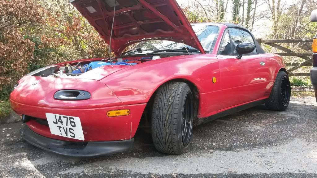

Installed one of MX5Dans radiators.
Grrrrrrrr, look at me and all my boostings.

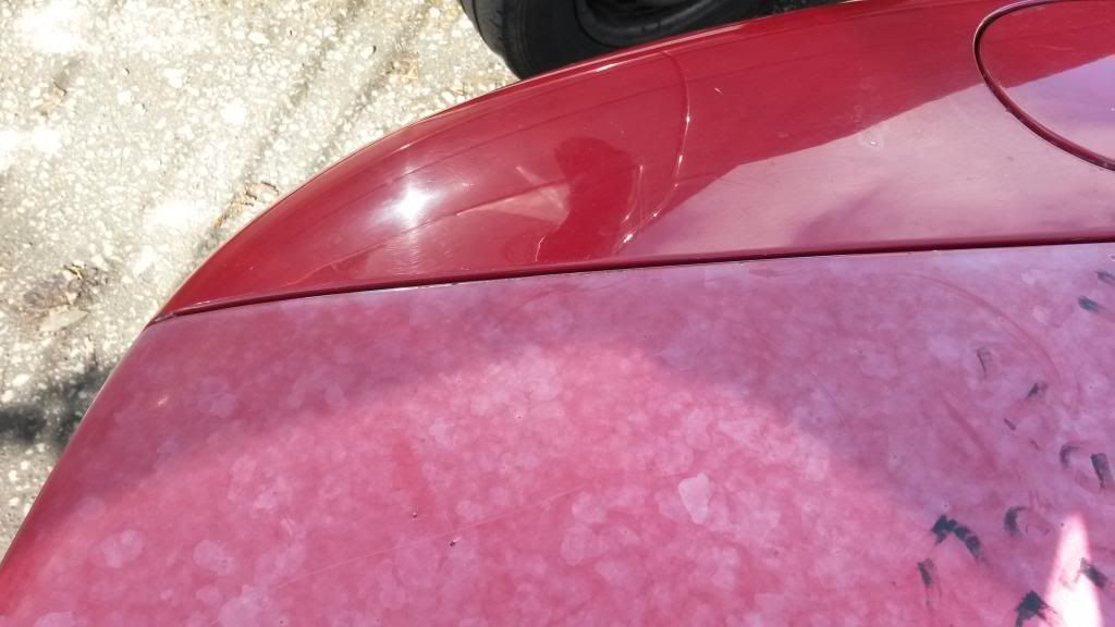

Not sure if I want to attempt to repaint it before the summer or not, this shows how bad the boot is.

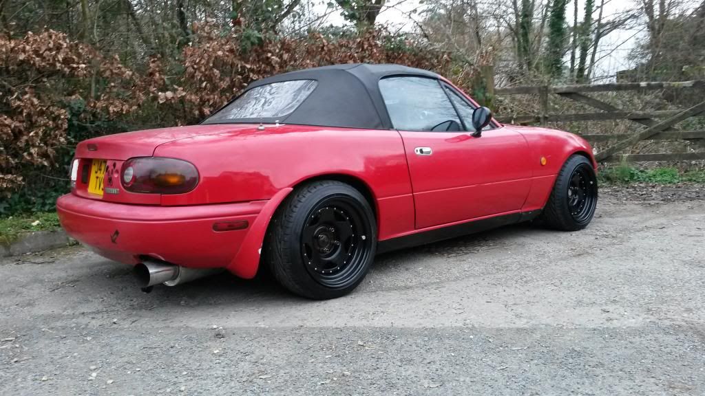

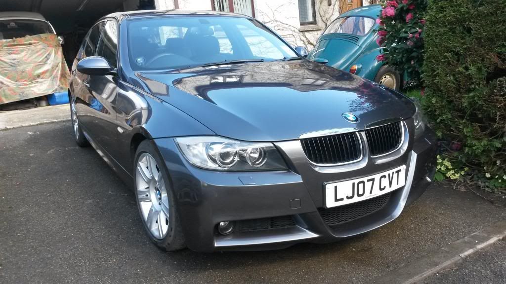

Real men have boosted RWD daily drivers as well :D . Gave her a well deserved clean.
I have been speaking to some local garages about getting some dyno tuning done, hopefully next weekend I may have a complete running set up. Unless I can find anyone local who knows what they are doing.
Looking good mate. Will a machine polish not bring that paint back up?
I like your bmw aswell btw, what engine's in it?
Discussion starter · #367 ·
Nah tried that its well and truly gone, just equals out the colour but remains just as pink.
Cheers bud, 320d M sport.

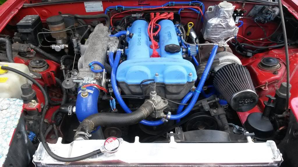

I got mine started on Friday, need to weld the join on the downpipe as the slip joint leaks like a mofo, and need to redo my compressor outlet adapter I made as it's leaking. But it was idling just fine!

Have you got the correct size U clamp on the slip joint? Mine dont seem to be leaking, well there is only one that I didn't weld up.

Hmmmm. more than likely. Probably the piping run as well as the AFM. My compressor is literally spinning with only a small bit of mesh in front of it.
It's a hodgepodge of bits of pipe I had in the garage. I cut the last bend from the 2.5" exhaust/downpipe that used to join up with a hks manifold/turbo, then cut up a screamer pipe from a 200sx, had to flip the main pipe as it's 180 degrees out, cut up the flange so it's one big hole rather than 2, then chopped up a bit of exhaust and added that to make it bell mouthed, this then fitted inside the downpipe after I cut slots and opened it up.

What is the fluttering? Is it air returning out the air filter?
Sounds like it, bov-less or hard bov spring.
No blow off valves here.

Just running waste gate pressure currently through a MBC, in an attempt to reduce creep. I do need to relocate the take off point for the waste gate to after the IC.
I do need to look into EBC, I think MS1 has the facility. Just more for my reading list.

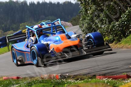

Managed to get the job of lining the cars up at the start point within the timing lights, which was a pretty good job. Some very nice cars indeed;
I got sunburnt like a ginger does :lol: hence the stupid face, borrowed one of the parents camper as well.
This was actually at Wiscombe Hill Climb;
Some of my particular favourites of the weekend;

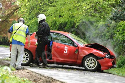

There was some big crashes which where not at all pretty;
