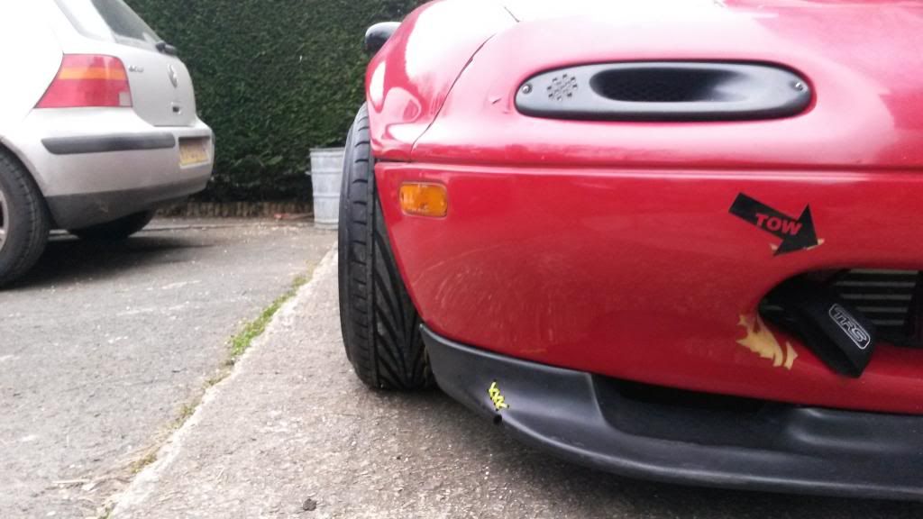

Look she's not on the driveway for once

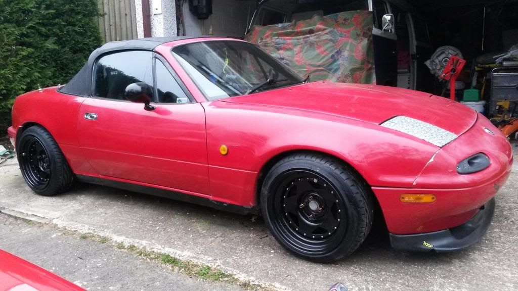

Not sure if I want to attempt to repaint it before the summer or not, this shows how bad the boot is.
Real men have boosted RWD daily drivers as well :D . Gave her a well deserved clean.
