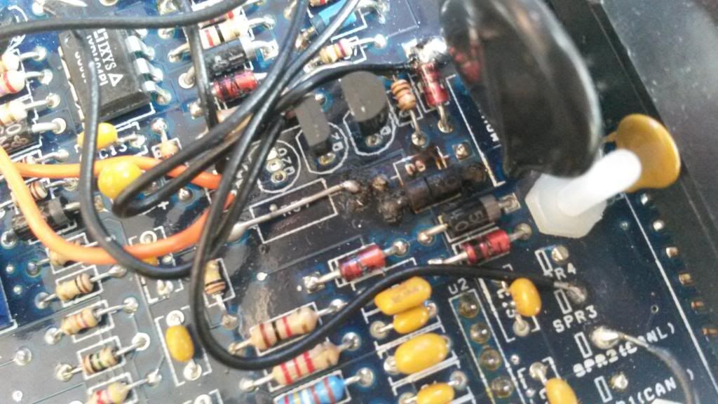

Got it started on the original ECU, lovely plugged the MS1, started. Sweet........ oh is that smoke, yep thats smoke, yep thats smoke from the MS1. Left the fuel relay in!!!!!!!!!!!!!!

Dude! I put a note on it saying pull it out.
Think it just toasts some diodes
Yeah I know, but in my tracing the not starting issue I had put it back in to run the original ECU. Forgot to pull it out.
Photos to come of electrical toast......................

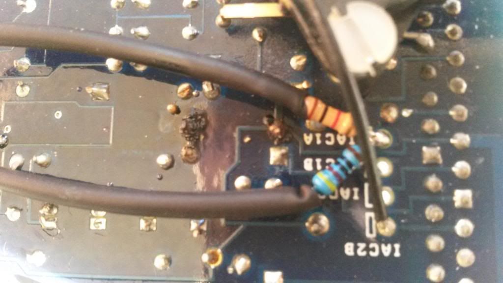

Right then
What have I broken?
Can it be fixed by a ginger ape? Or does it need to go off the Scuzzle or alike? I do have a soldering iron, but it still unopened in the box.

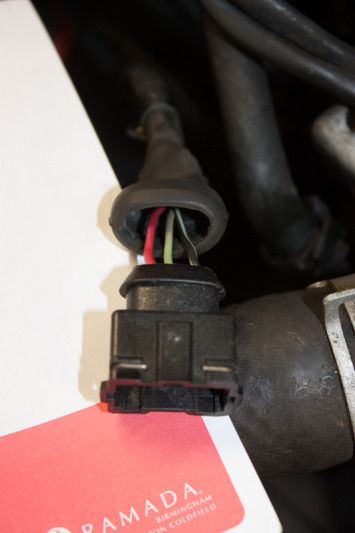

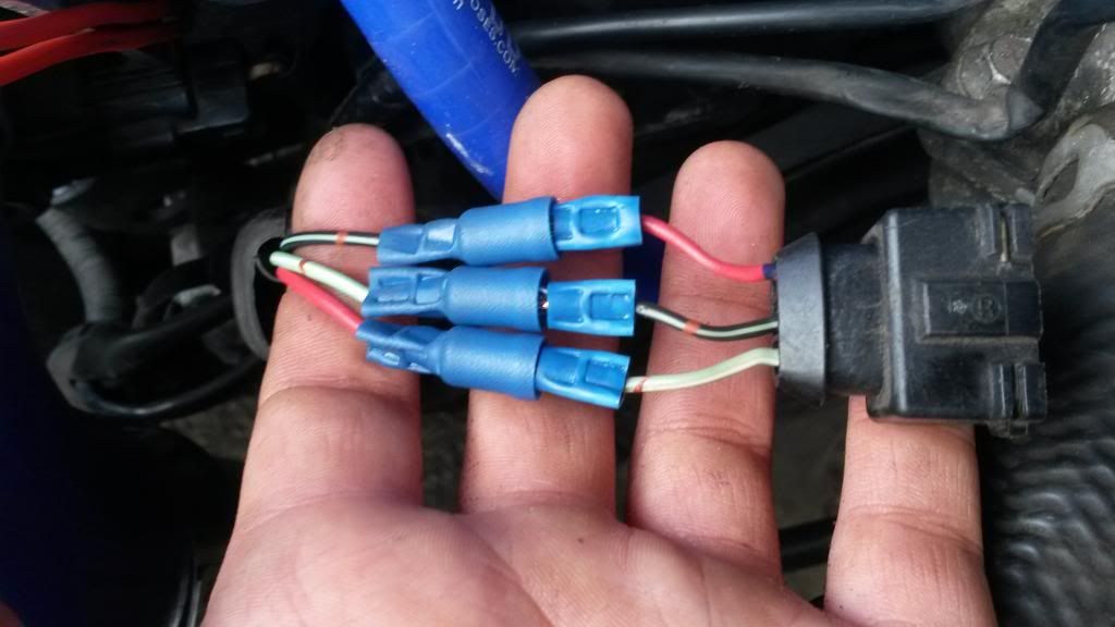

Following this thread here http://www.mx5nutz.com/forum/index.php?showtopic=1311&page=4, I think I have wired my TPS correctly???
From the thread
Mine

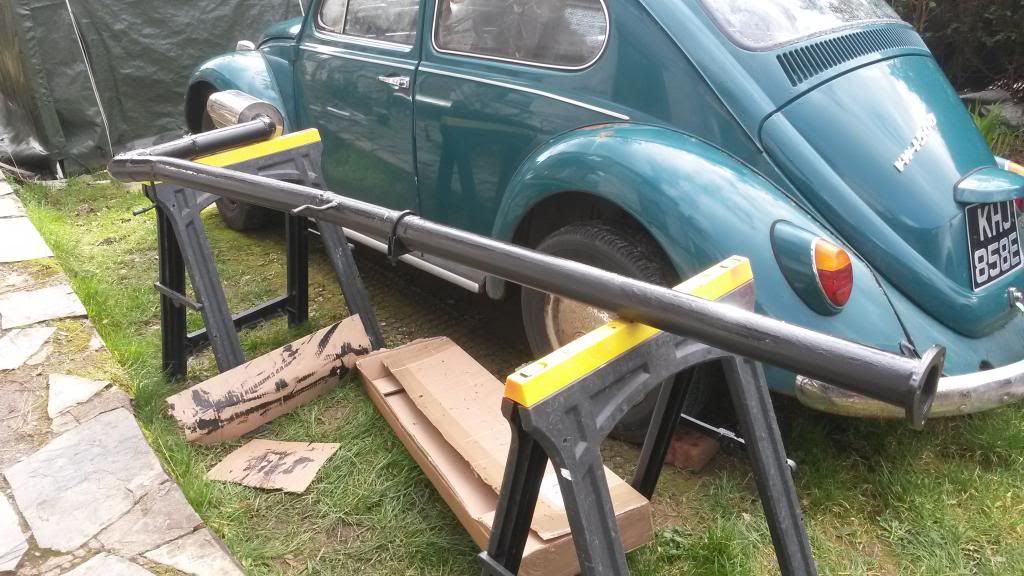

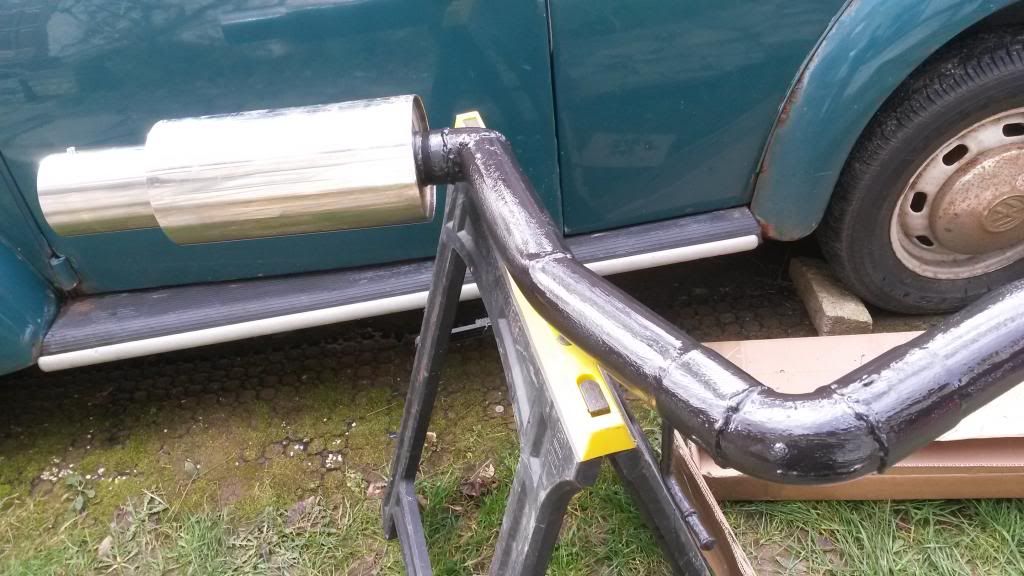

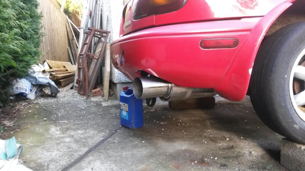

Also I painted the exhaust;
Which now finished, sits like this;

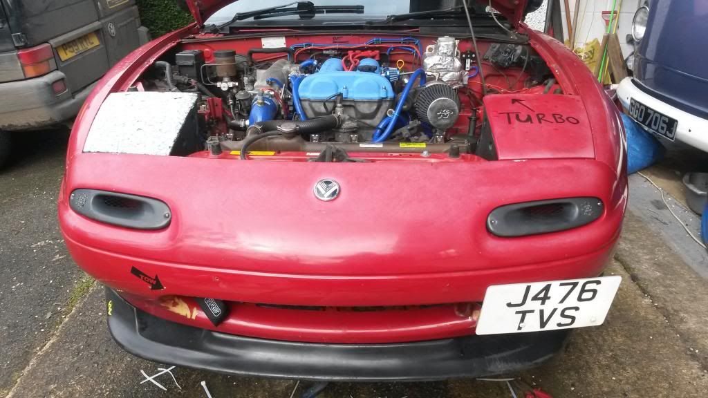

Fitted my old GV lip back on, I feel off a track back in November and I managed to run it over :doh:
A bit battered

Is it a stock ecu or after market. remove the diode from the board see what number it is then contact either the company that make that ECU and find out what value you need or contact mazda if its stock. Most likely a 1N004 or similar. it probably a protection diode
Discussion starter · #257 ·
Megasquirt MS1 bud, burnt to shit so can't see what diode it is. It must have have some link to fuel regulation.
