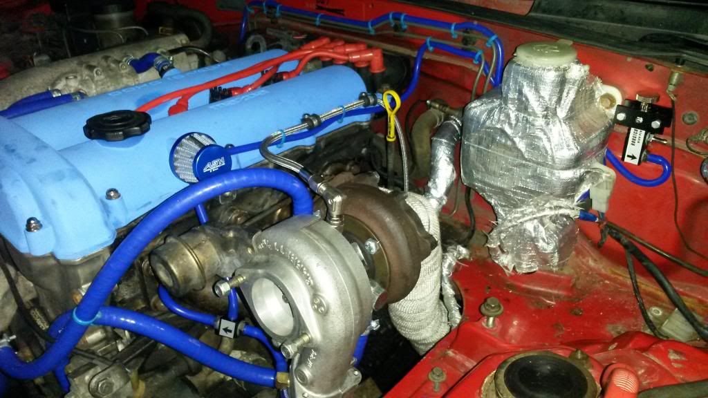

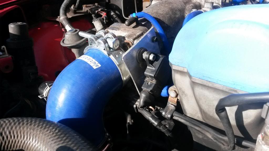

Not much to report today, turbo fully bolted down to manifold now with hi-temp gasket sealent.
Also fully installed the MBC, not really intending to use it to up boost massively, more as a check to reduce creep;
Just figured out I have a T25G turbo (bought it not knowing what that was), and my said Saturday night Interweb trawlings have found a 'G' has a bigger compressor housing over the standard T25. Apparently an inbetween of the T25 and T28.
Happy days :D
I've been doing some reading up on them aswell recently and from what I can work out most aren't ball bearing, only some are. so you may be lucky, but it may also just be journal bearing!
When are you going to make it to a dyno? I'm interested to see what you get out of that turbo! I found some specs on that turbo somewhere and it seems to have the same dimensions an a/r's etc as a gt2554r. which according to flyin miata's website will make 200rwhp, so approx 220 at the fly(not bad).

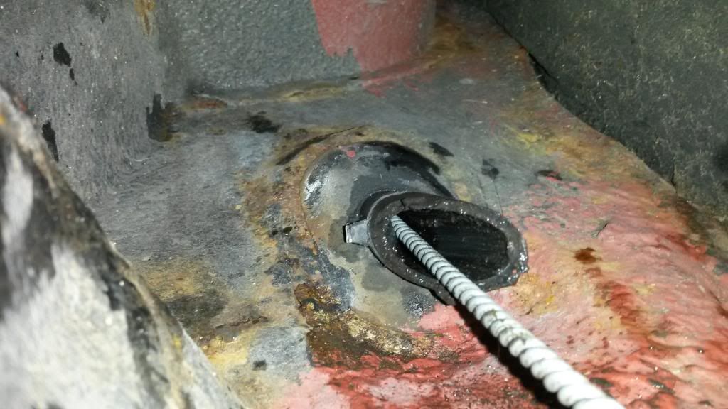

A bit of general maintenance on the car, cleaned out the hood drain pipes. I hate being under my car, lets me see how rusted it has got since I last welded it up :sick: .

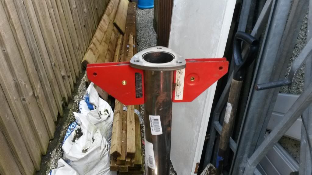

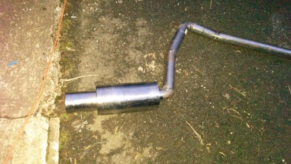

My main goal for the today was to fabricate my exhaust, 2.5" mild steel mounted to a 6" back box with a 4" tip.

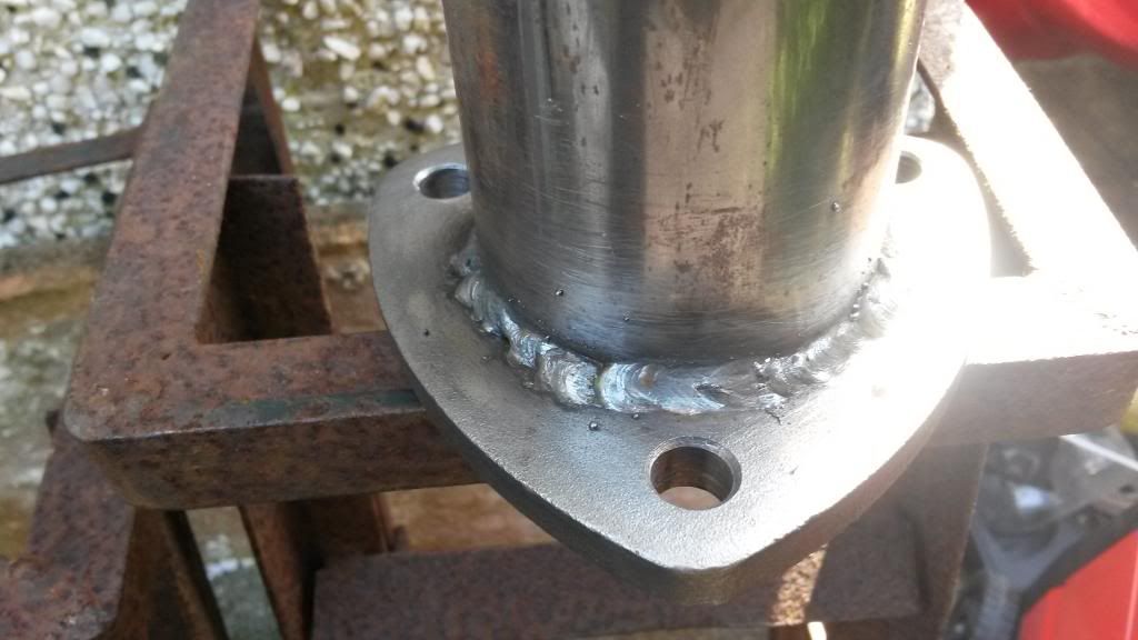

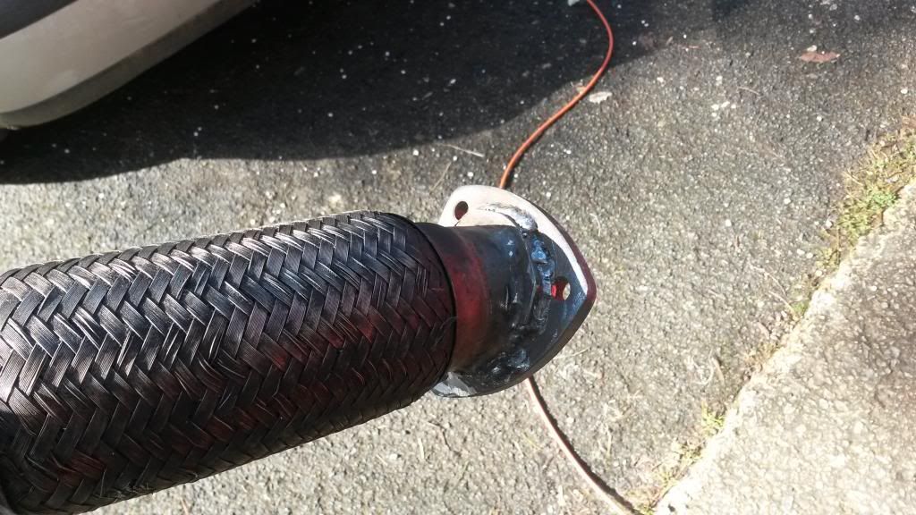

To start I welded a new flange to the downpipe as I am using a 3 bolt type, not the best of welding but it was the morning.
The start of the exhaust, checking its level and good to go.
See I can weld.

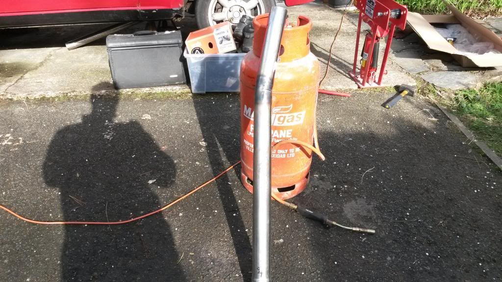

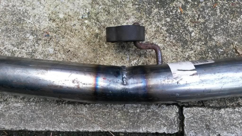

I had a problem with the pipe bender as I didn't have the correct size die, which causes the tube to crush and oval out. So I had to cut a slot, and then heat it up prior to bending.
There we go welded back up, also I cut the mounts off the original exhaust and re-used on this one.

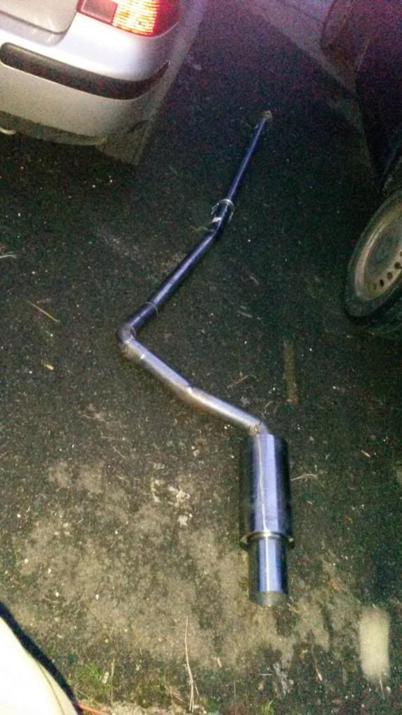

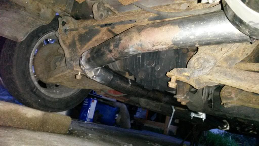

This shows the bend, I had 2 on this length in different directions, and 1 on the cross over pipe.
I spent a lot of time making sure it wasn't to low, as I didn't want it crashing into everything.
This shows the cross over pipe, photos makes it look crap for some reason.

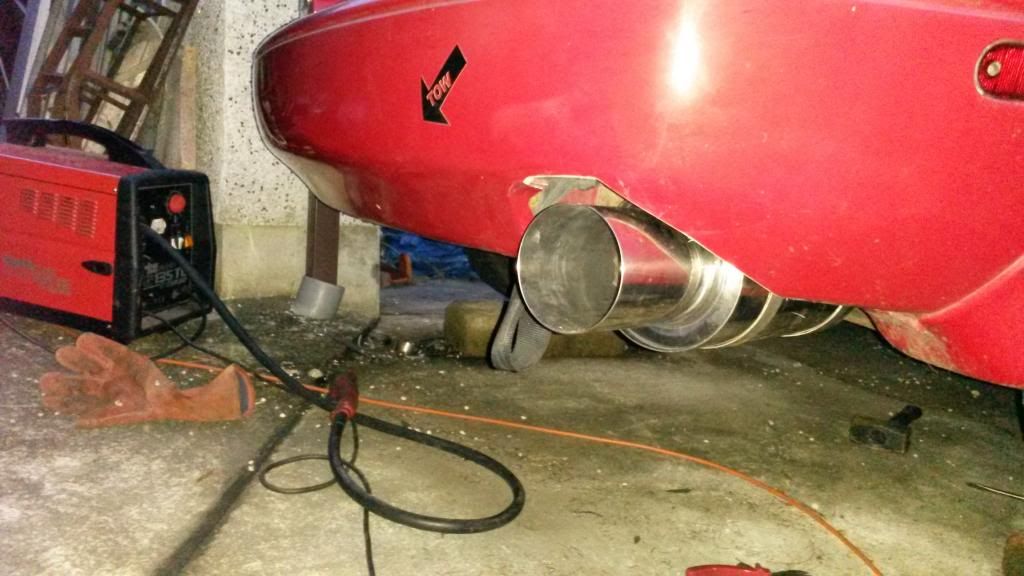

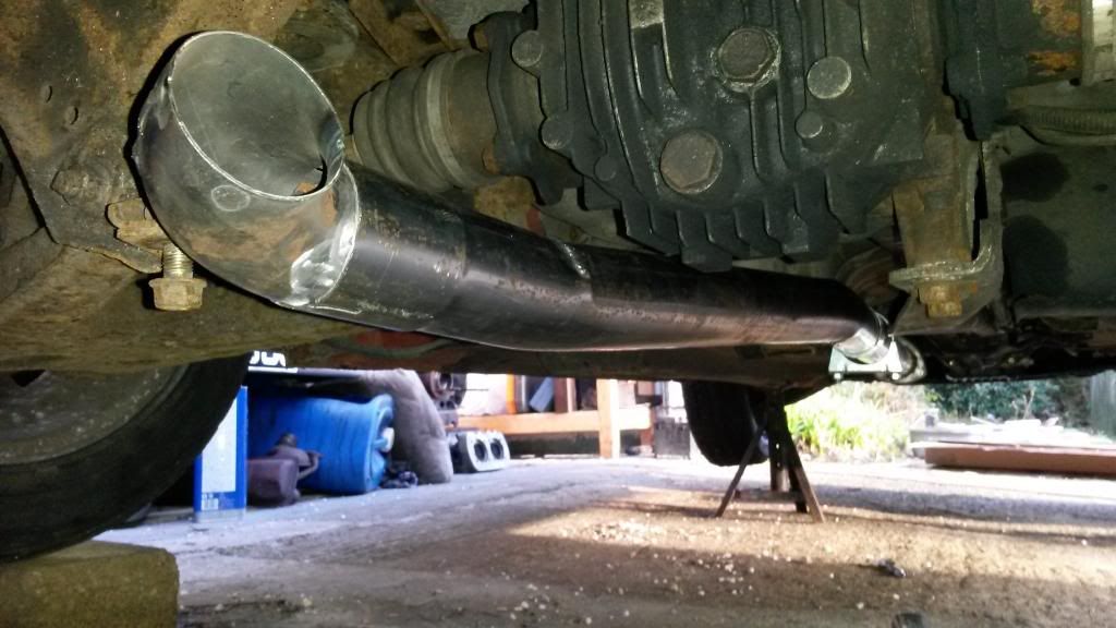

This is the can mounted on its own weight, I used the stainless wrap around straps you can buy.
By this time it was getting dark and my photos went to shit. But its done :banana: one exhaust system, I will add some extra photos went its light.
