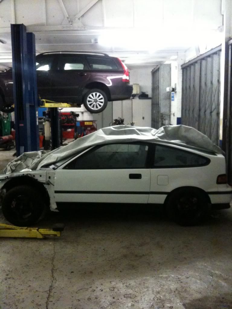

Fact was, I was sick to the back teeth of chucking money and time into the inanimate Honda shell. The car I had dreamed up at 18 was now seriously lacking appeal at the age of 22. I no longer had the motivation to spend my weekends messing about with the tiny dull details of the build (and there seemed to be thousands of 'em). I was also was really beginning to hate shelling out ÂŁ100s on inane parts while never really getting closer to the end result. Worst of all, I didn't even really want to achieve the end result anymore... It would be highly strung, super impractical, probably unreliable with lack of parts support and eurghhh FWD...
The more I drove the 5, the more my interest in the Honda faded.
I'm into cars cos I like driving them. I'd attempted to build a top spec race car despite never having done a single track day. I'd fallen into the trap of looking at mags and blogs and attempting to copy the cheque book builds that you see all the time. And in the 4 years I'd spent chasing that dream, pouring blood, sweat, tears and thousands of pounds into it. I'd lost sight of what cars are all about...DRIVING!
And I was having more fun driving the 5 than any car I'd ever owned.
So to cut an already long story short. The decision was made to flog the Honda and associated clutter. The Golf would stay on daily duty. And the 5 would become the 'project car' :D One good thing about the CRX build is that I learned a huge amount from it. Not just mechanics wise but also how to approach a 'project'. This was going to be very different.

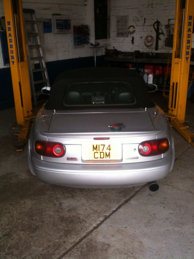

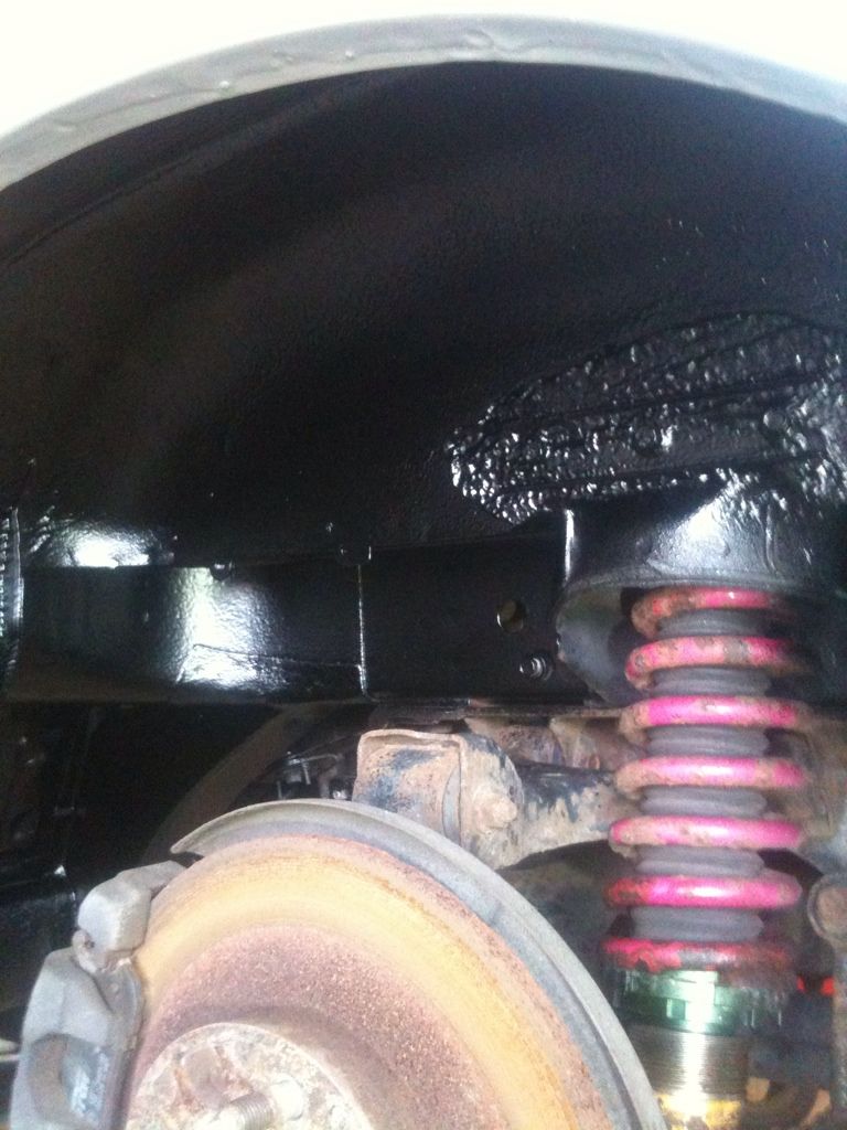

But first came maintenance. Did a full service and underseal.
2F12C0D2-093B-404C-BCAB-821560E55610-442

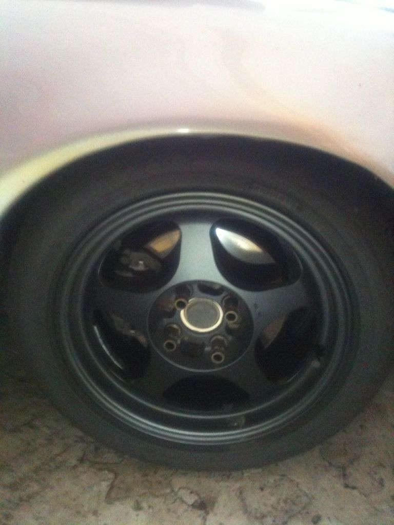

-Rota Slipstreams (off of the crx)
-Buddyclub wheel nuts
56A59D3A-C98A-46E8-A896-5E6ADFCE5F82-442
B3B2257C-8071-46C6-AB4A-56D460EF291C-442
F6951E0E-5480-467B-91C7-F960DE2F4E9A-442

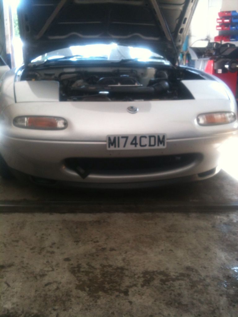

With those fitted I turned briefly to the engine side of things.
MX5Parts silenced decat
5B5852A4-1199-4E37-98E3-30ACDFBE0AFC-442

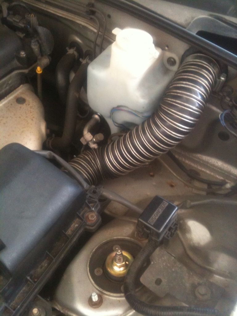

DIY cold air feed
B5FD8971-B45B-4E5E-A528-C563C3614160-442

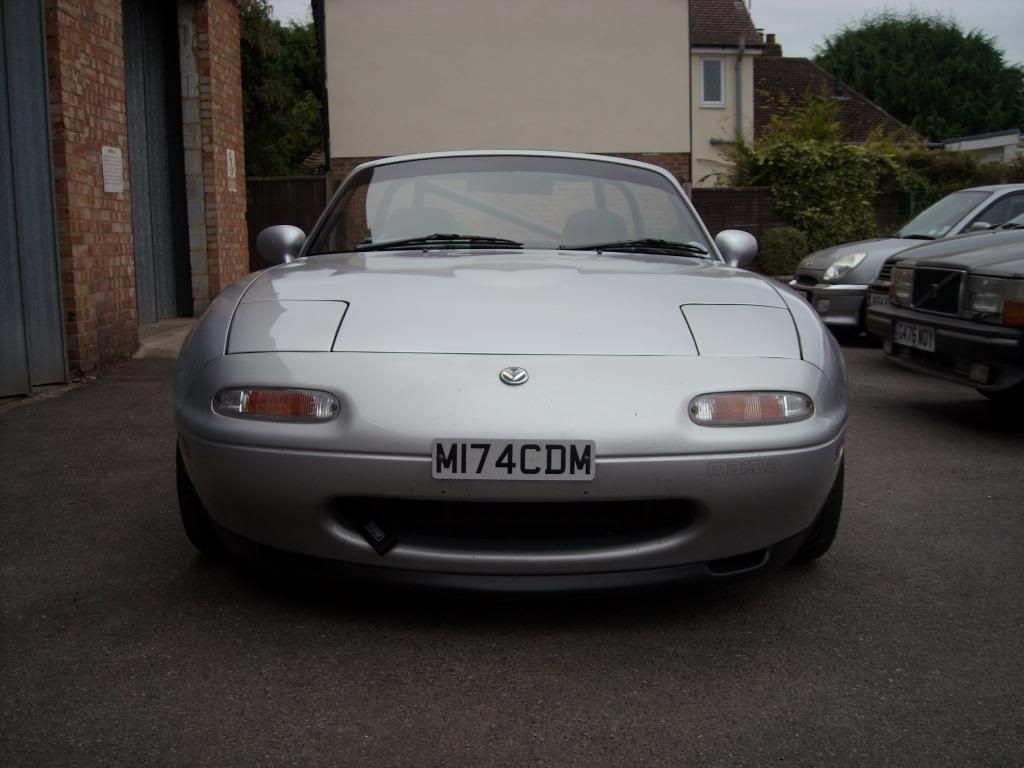

I was happy with it at this point and got on with driving it and went to a few shows and various jollies. Shameful lack of quality/quantity of pics continues...
A58E5DC7-3BA0-4718-B6B1-6F70AC08EEC7-442
84CF0769-6379-4837-B4FA-098BC527192B-442

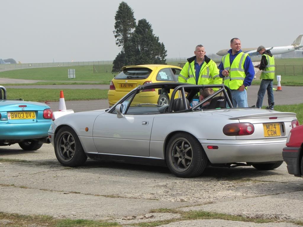

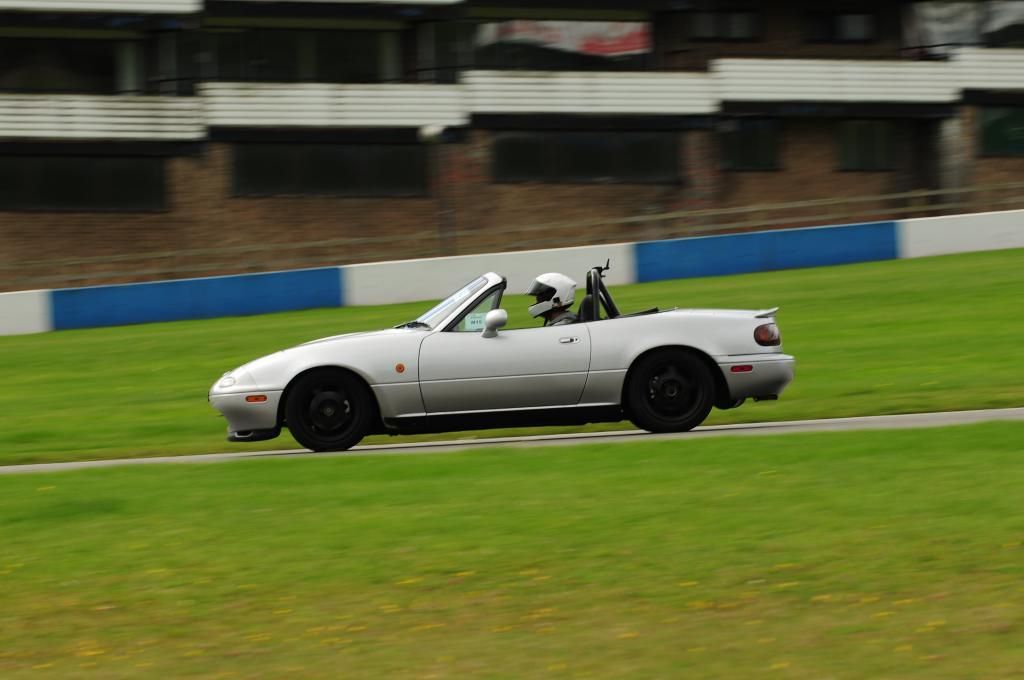

Track time!
I went to Keevil and had an absolute blast. It was my first ever trackday so I wasn't entirely sure what to expect, but I loved every minute and was definitely bitten by the bug. (Which was lucky seen as I'd started building a track car :p)
The car performed faultlessly and I was so impressed with its ability. Through the corners only the caterham type cars seemed to be able to go quicker. The straights aren't the mx5s strong point but still I went past a number of cars I wouldn't have expected. The list includes a couple of 200sx, a scooby and all manner of bmws (only the M3s were quicker but only just!) It was awesome.
The only issue I had was with the tyres. T1Rs don't hold up too well on track. Lots of squirmy, squealy sliding begins to occur after a few laps. The brakes got pretty spongy by the end of the day aswell.
I came away with some notes:
-MX5s are epic
-T1Rs are shite
-No roll over protection is slightly unnerving
-I need more seat time!

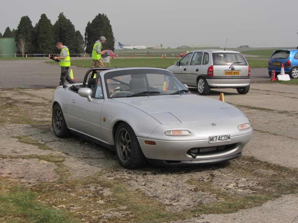

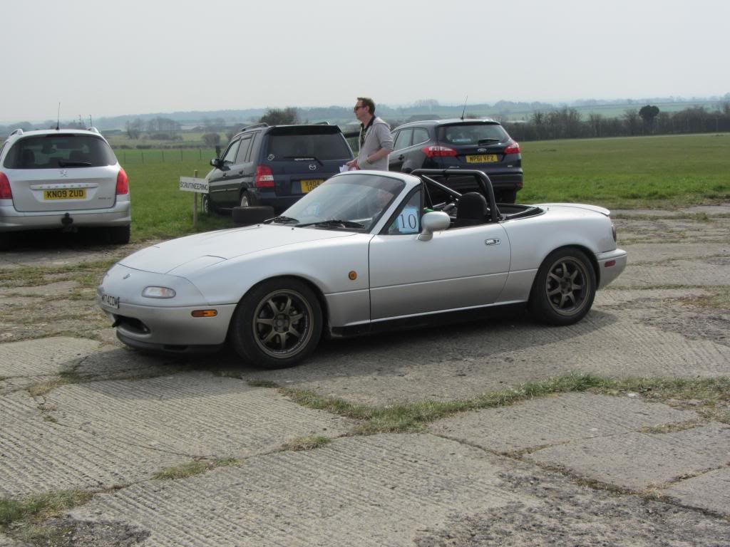

Typically I only have 1 crappy picture from the day. A stationary one at that. Next to my mates 200bhp Civic.
C5D00A15-B374-4AF4-803D-A9F5EDC4A9D5-442

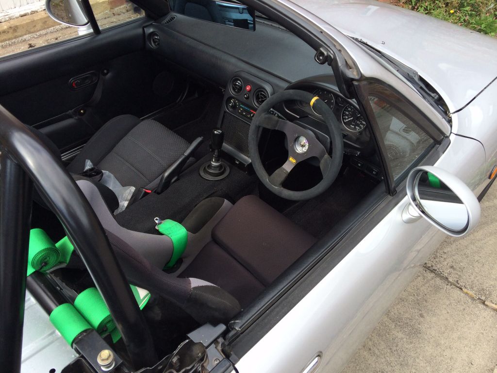

On return to the workshop I began the task of improving the car.

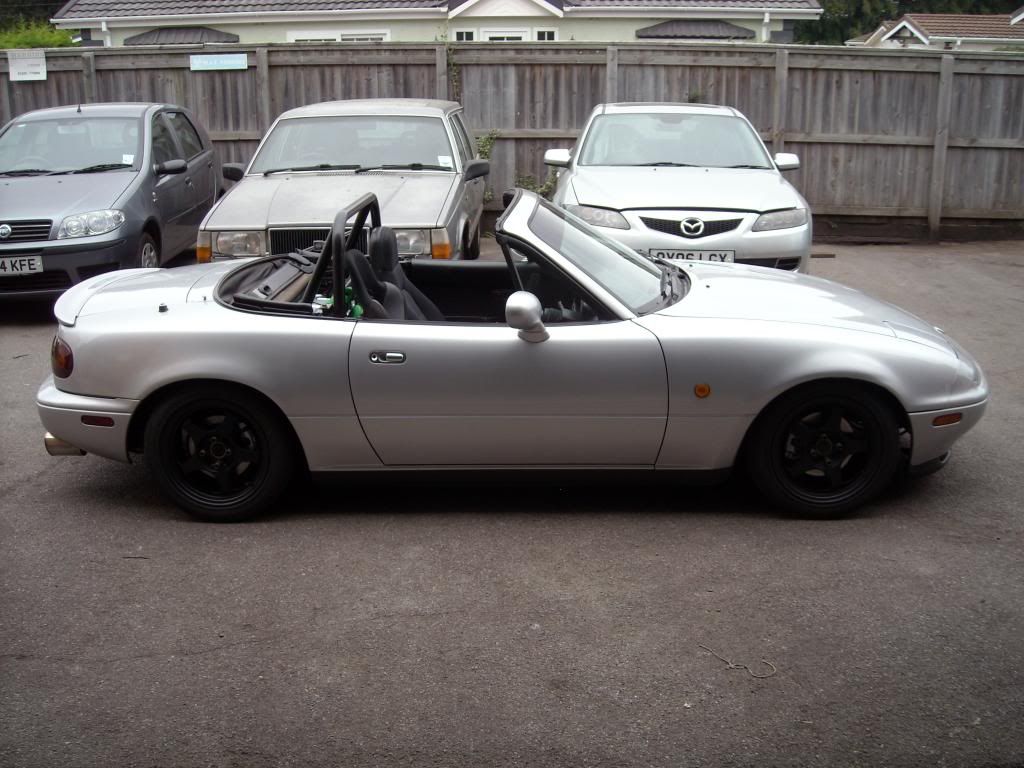

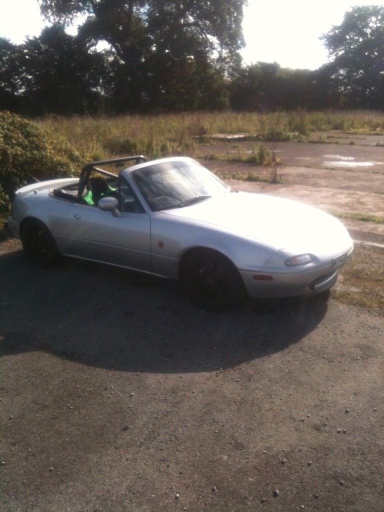

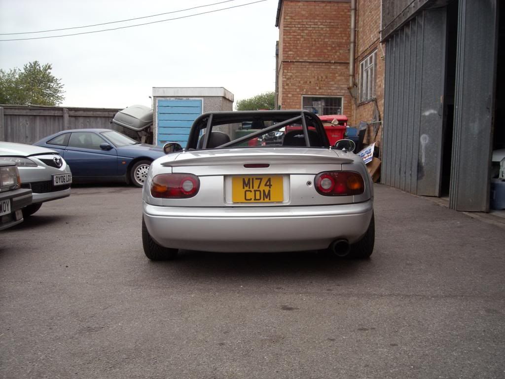

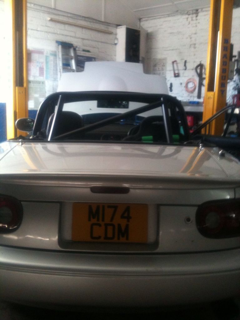

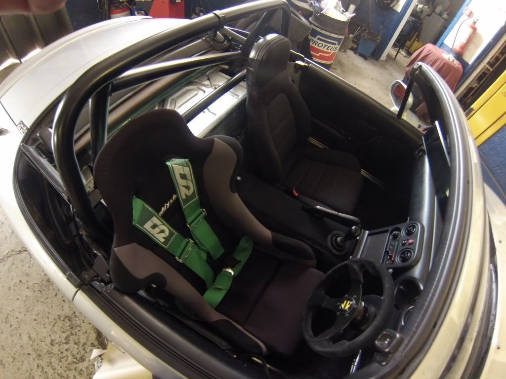

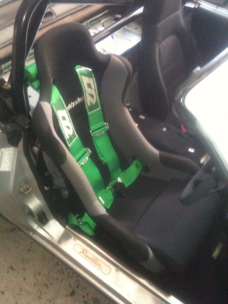

A roll bar was top priority as I really didn't fancy being upside down without one. I ordered a TR Lane TD bar as its about the tallest one you can get whilst retaining a roof. I'm 6'3 so need all the space I can get!
6D614874-B43C-43C7-9232-FA052ADEA30F-139

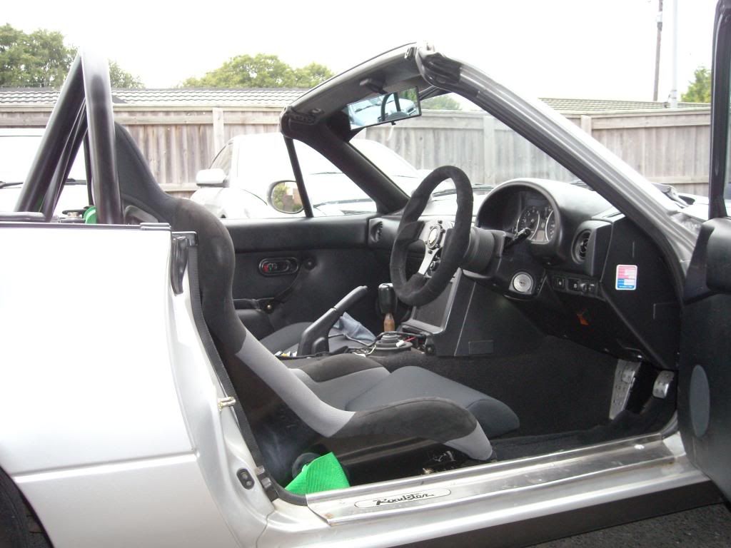

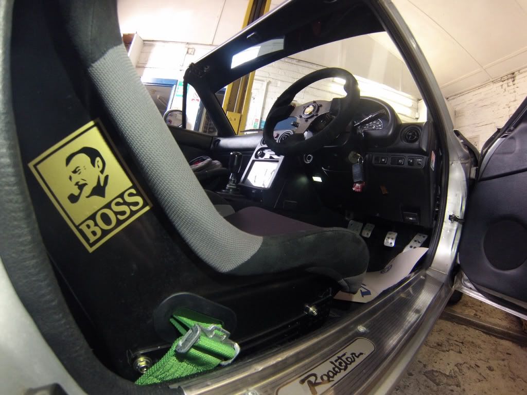

You may also notice in that pic a different seat has made its way into the cockpit. I had a Buddyclub seat and D2 FIA harness left over from the CRX so they went in with the help of JB Fab rails and a TR Lane harness bar.
E16203E2-0505-4CF3-B468-B788B2E5FD80-442

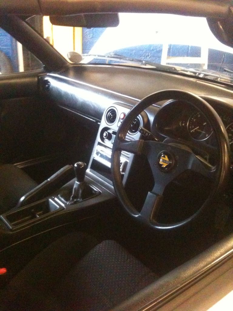

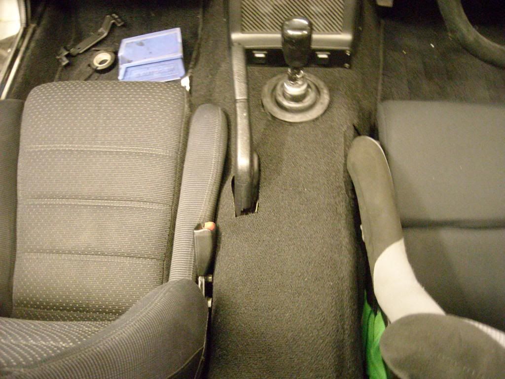

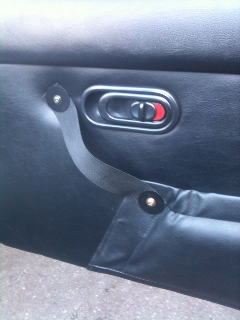

I needed a bit more room so I removed the centre console and made some race door handles :p
E1C8760C-87B9-41C2-AD54-23FB047812B0-442

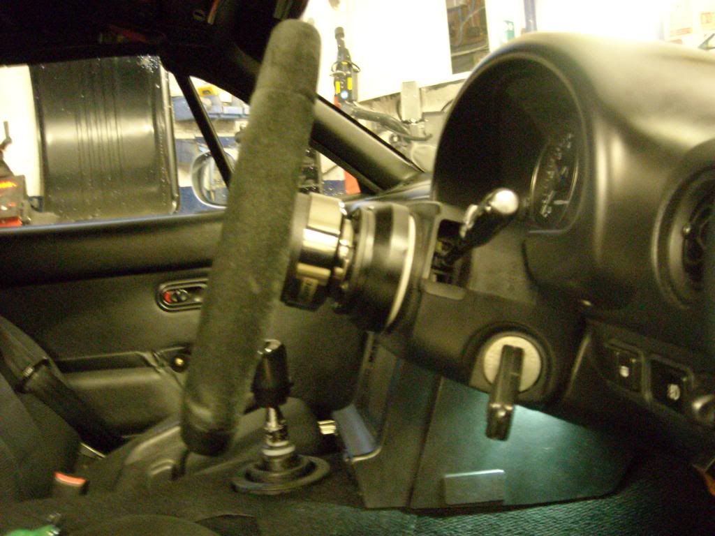

I also got a 330mm steering wheel and D1 Spec quick release. Going to replace the wheel with a Personal Grinta soon. Will also look into getting a shorter hub as the wheel is a little too close for my liking.
DEE00A7B-6EF0-4C14-9D78-18329985B48A-442

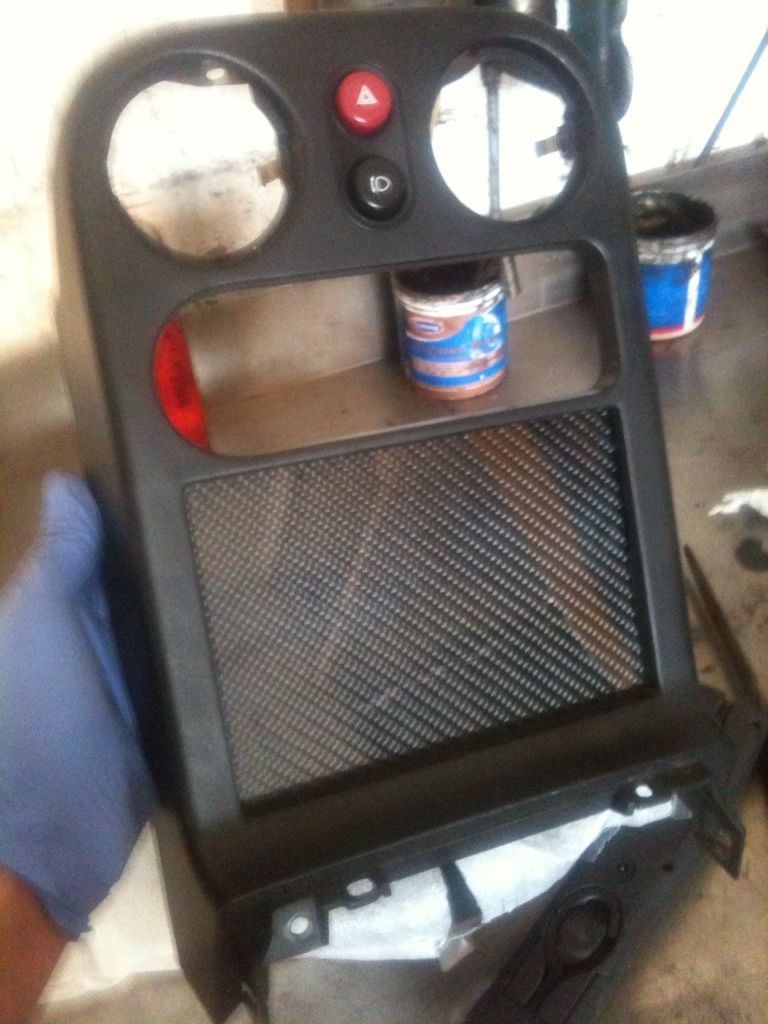

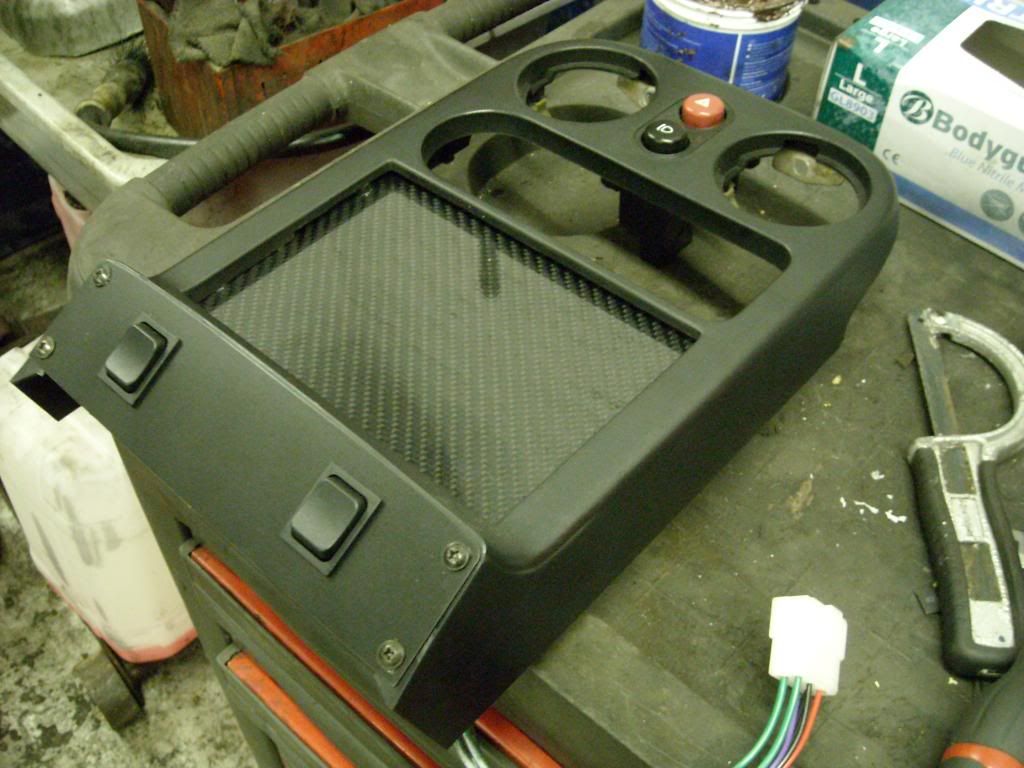

I removed the radio and made a carbon blanking panel. Going to relocate the window switches onto this panel at some point.
BDBE476F-299F-4D41-BEBB-322AAFF9CAD7-442

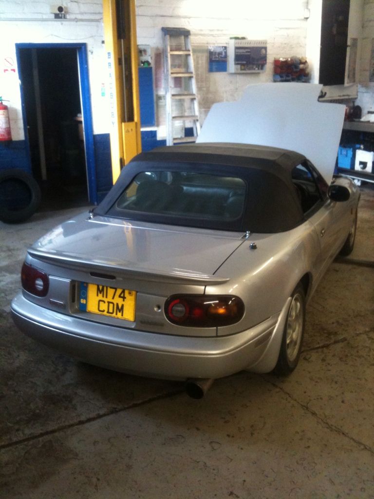

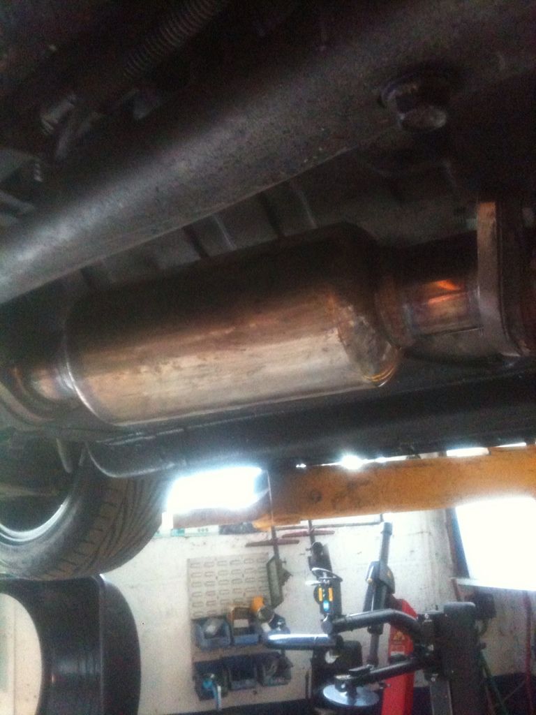

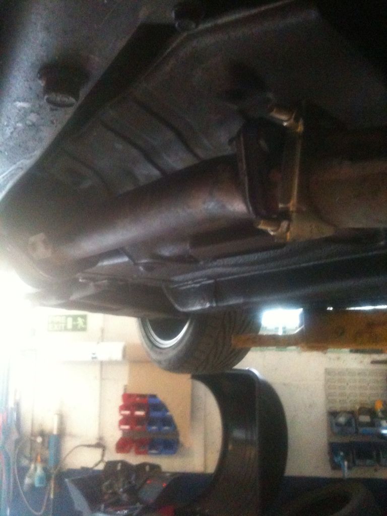

There was a loud exhaust rattle from underneath. I assumed that my cheapy decat had blown to bits so I bought an unsilenced one. However the problem turned out to be a loose heat shield. I fitted the new decat anyway (Extra ground clearance, more noise :p) And temp repaired the heat shield as a new manifold is among future plans.
EC01DDF1-5866-4683-8607-ADF747B420F6-442

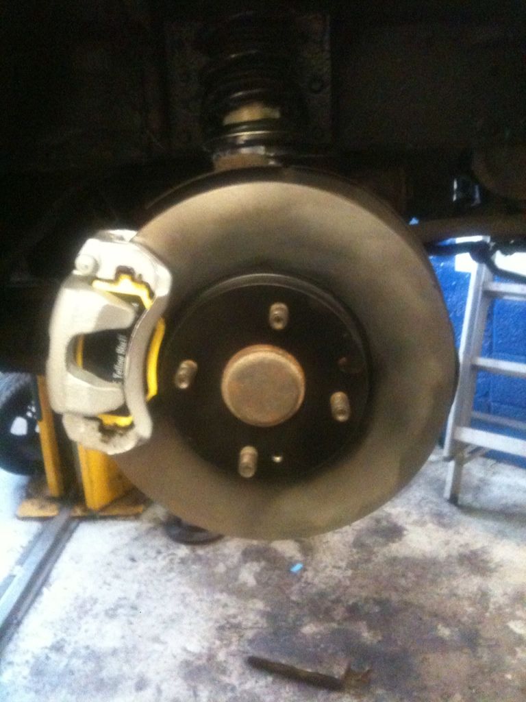

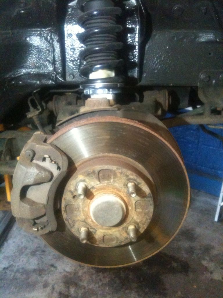

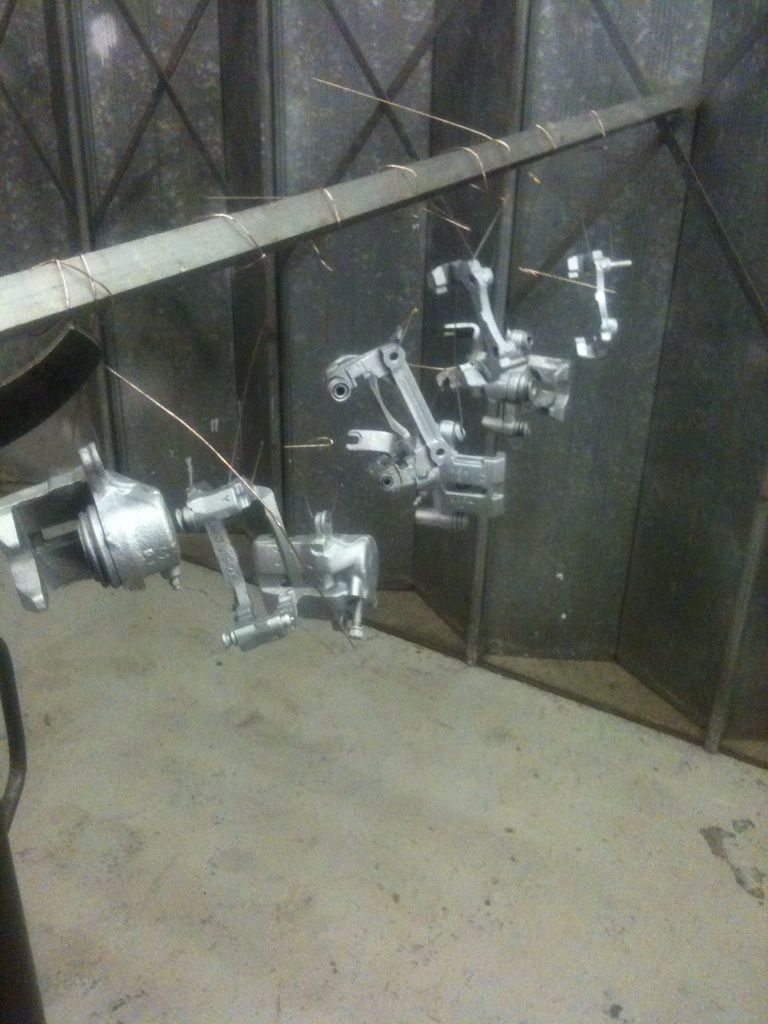

The brakes felt awful. All the components were pretty shot so it was time for a refresh.
Purchased-
-Yellowstuff front pads
-Blueprint rear pads
-Blueprint discs all round
-ATE Super Blue fluid
Before:
EC9DE7A2-8171-4B6A-AE70-525A8190C741-442
During:
B139162A-D57F-46CE-963C-97A9DB61229E-442
After:
006ADC43-31B6-4275-AE1B-E1C385C6339F-442

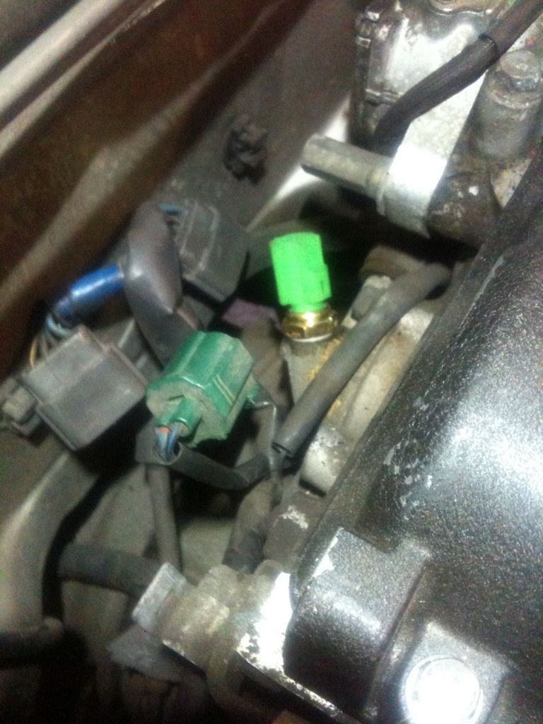

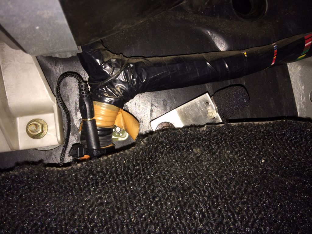

Next on the list was my faulty radiator fan which had stopped working. Fan and relay tested ok so it was time to replace this little bugger:
CEDA841C-5CC7-4049-BBDD-73526A8F6317-442
62087D9C-8EDE-48A0-BF77-21981B1FDCC4-442
It wasn't as bad a job as the Internet had led me to believe. I had a working fan again :)

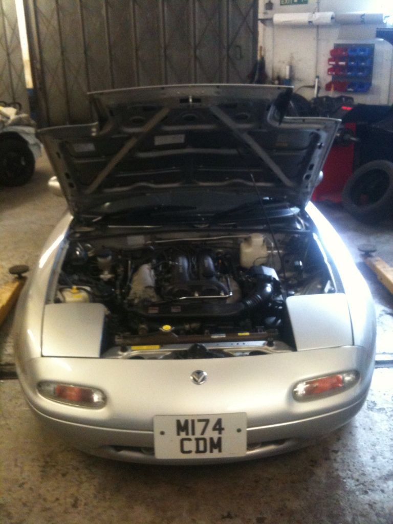

That brings us up to now then! Before the weekend I've got an alloy rad with slim fan to fit. Plus a few other small tweaks which I'll post over the next couple days. Excited :)
In other new I took some photos with a proper camera the other day :shock: So I'll post them up ASAP!

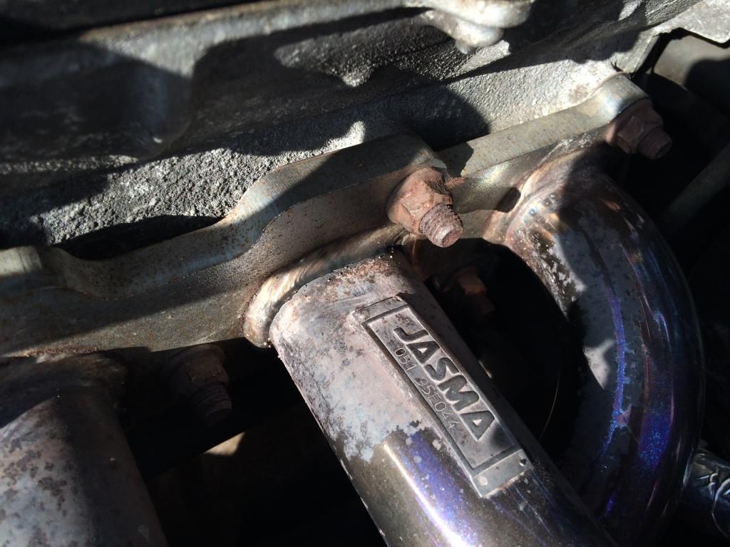

NRG Short Boss - Lot's more room now, however the horn contact broke up after a couple hours driving so horn is currently out of action...
The eagle-eyed amongst you may be able to pick out from that blurry mess above that I've also tidied up the centre console delete.

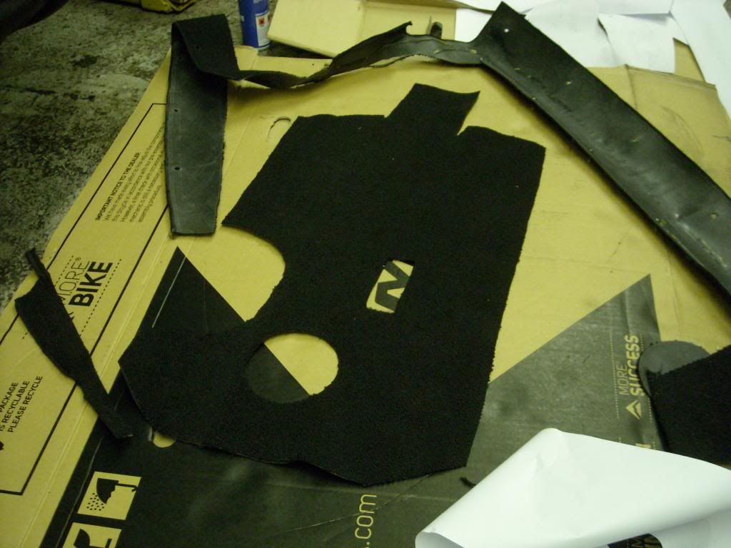

Used a switch panel from OMGPham and a parcel shelf carpet cut to his template. Really pleased with how it turned out.

Biscuit, I originally made the intake to try and help free up the top end of the rev range. There's a nice increase in noise but I don't think it makes a major performance difference. Despite that, I'm sure it's better to be getting cool air from the scuttle rather than hot air from the engine bay. The top end still feels a little 'choked'. I'm hoping the lightened flywheel will help to create a more eager engine character similar to the 1.6.
#16 ·
Very nice, I like what you've done so far! Ashame about the CRX that looked lovely but I can see why you'd done it. What was it you used for the scoop on the scuttle panel? Any more pics of the intake setup? I'd like to do something similar on mine :)
#17 ·
Thanks mate.
There's no scoop on the scuttle just the standard rain cover which I had to trim. Legend has it that the entire scuttle on an MX5 is a high pressure area being force fed cool air from above the bonnet.
I cut a hole in the bulkhead and then tiger sealed a random plastic pipe flange thing into it (I'd had it lying around for years thinking it would come in handy. No idea what it is or where it came from though lol). Then just some reinforced heater ducting off ebay roughly 70mm which fitted onto the flange and air box perfectly. If I was to do the job again I'd probably relocate the washer bottle to allow a straighter path for the ducting. Not sure it would make any real world difference though.

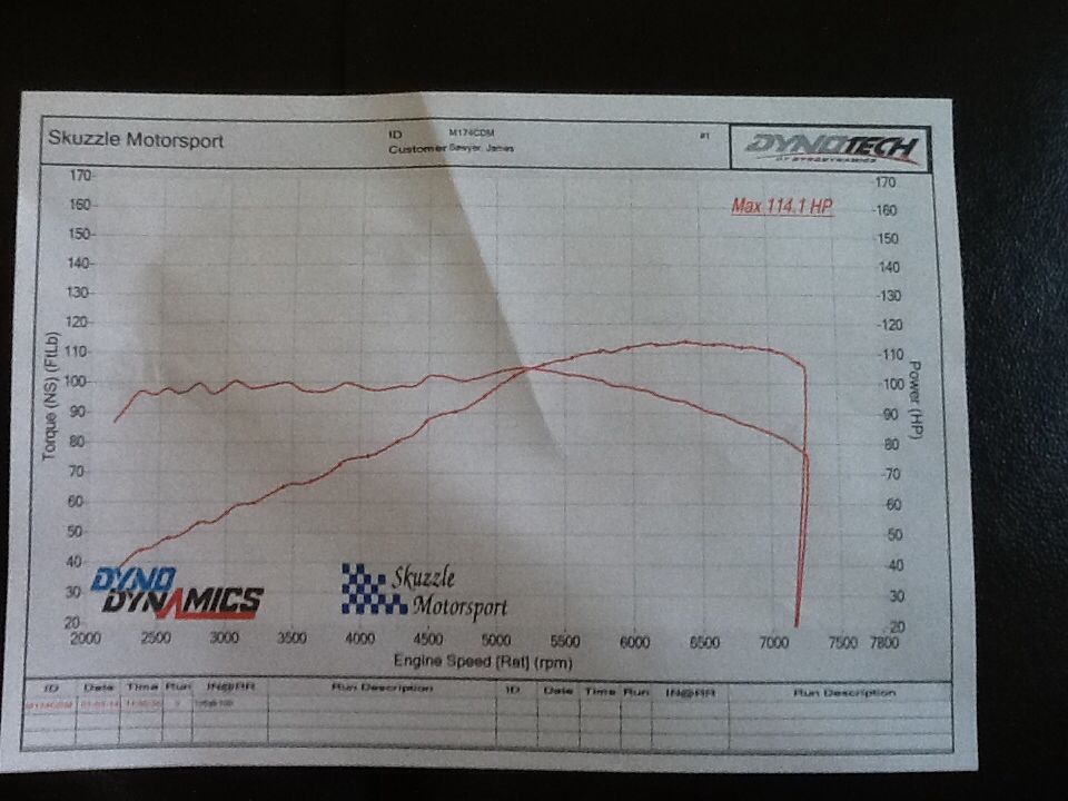

Went over to Skuzzle this morning for the Nutz Dyno Day. Was a really cool day, lots of awesome machinery and lovely weather.
So what were the scores on the doors? Well my original prediction was 120 at the fly. When I found out that power would be measured at the wheels I realised my prediction would be way off. Or maybe not....
Really really happy with the result. When I left this afternoon it was still top of the board for N/A Mk1s. That may have changed though :p It would seem I've got a good one!

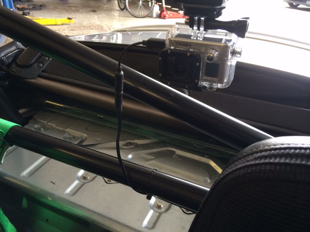

Got some nice pics from the event. I failed to get any GoPro footage because in between driving and marshalling I was more interested in hiding from the elements, drying off and warming up than messing about with the camera. Kicking myself a bit now though. At least I've got these pics :)

Is the hood still properly functional with the roll bar?! Great build and introduction to!
Cheers! Yeah the hood still works fine apart from the window is hard to unzip. Been told that a cable tie or similar through the zipper would help but my roofs so fooked I just don't bother unzipping it.

Went up the garage and did a bit today.
Changed the oil and finally removed my AC compressor.

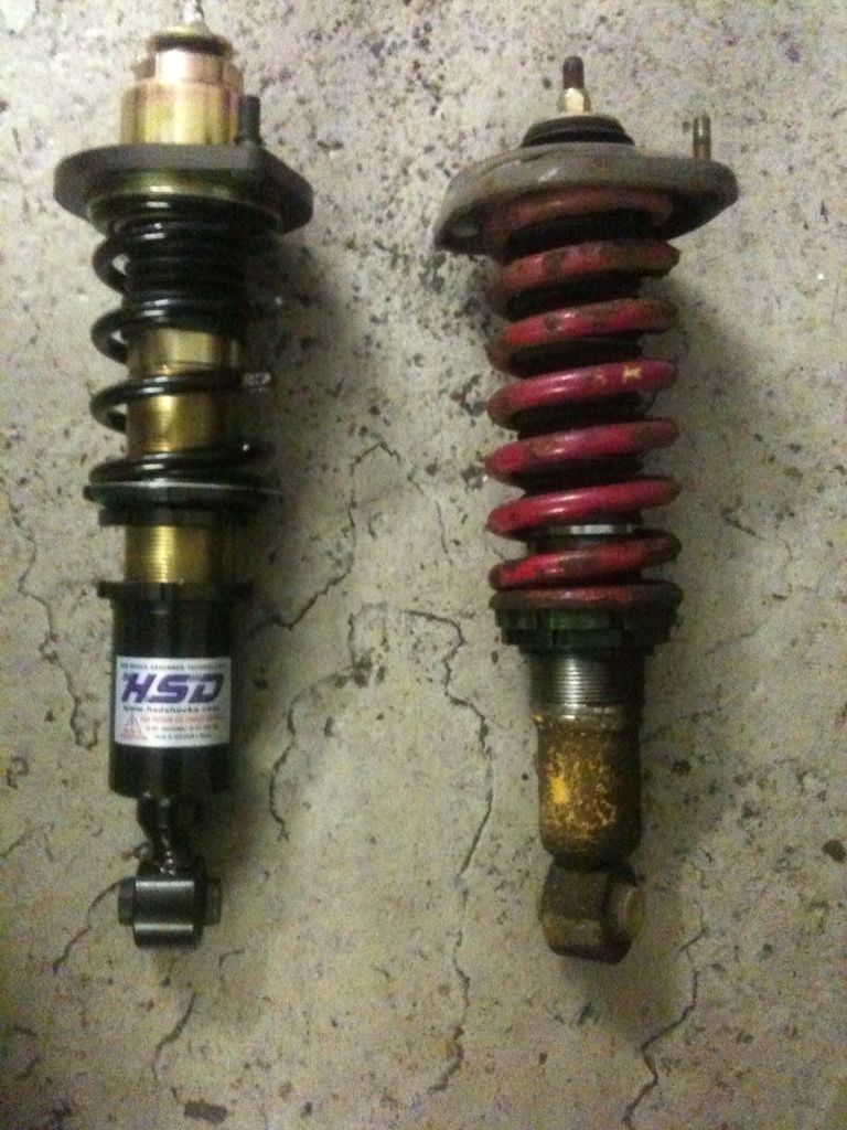

Then in an incredible display of old age I raised the car 15mm and set the HSDs to full softness. The idea was to get rid of some of the mega natural camber I had due to lowz. The next job is new TREs and alignment bolts before laser alignment so this should help out in that respect.
To celebrate I took a particularly gnarly B-road route home and I have to say, the cars real-world road holding ability has been significantly improved! The cars lost a little form but gained a shed-load of function.

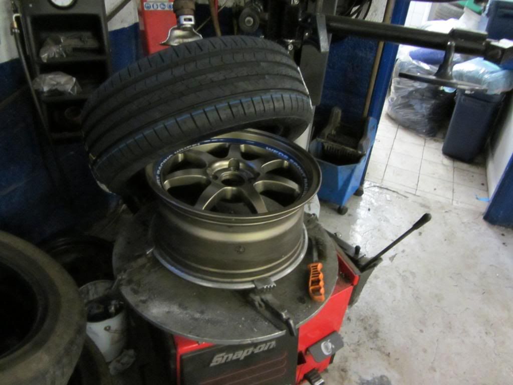

After alignment it's time for the new wheels :D
I fitted a lovely fresh set of 195/50/15 Vredestein Sportrac 5 to them today. The wheels are WedsSport SA90. Little preview:
Also took a few cliche fish-eye interior shots with the GoPro.
Thanks for reading!
#25 ·
interior looks so good. has the centre console just been removed and the console blanked off. Looks great
Thanks mate, just needs a decent steering wheel and I'll be happy.
Yeah centre console removed completely then used a window switch plate from OMGPham on here. The carpet in the centre is the parcel shelf carpet cut to shape.

Early start on Sunday, 04:30 in winter time and it was off to Kemble Airfield for the next round of the ASWMC Autosolo Championship.
Absolutely brilliant day was had. Weather was beautiful and the courses were huge amounts of fun. The tests were a lot more open than at Mendips, speeds were higher and there was actually run off available too. So I was able to fully concentrate on the task at hand.
There were four tests with three runs on each. I tried to do one gentle sighting run and then two flyers. I made a few silly mistakes on the flyers that cost me but when all was said and done I managed 17th overall out of 40 so an improvement on last time! I know I can iron out the mistakes and improve further!
Car was brilliant all day, it handles superbly on the new set up. Really can't fault it. The power steering struggled at times. The fluid boiled over on a couple of runs. American autocrosser's swear by Redline P/S fluid so I'm gunna give that a go.
Anyway less waffle more pics. Here's a couple of static pics that the mrs took. They give you a good look at the new rimmage. Action shots too follow.
