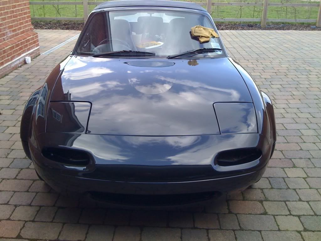

I have just done mine.
2x Holes holding the plinth but you can use the plastic screws to fill the hole or repaint as i did
