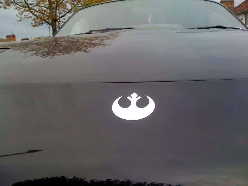

A sticker! Hey it's my midlife crisis and I will include stickers in that if I wanna!

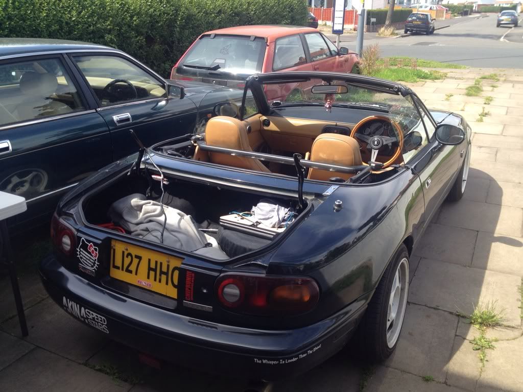

C

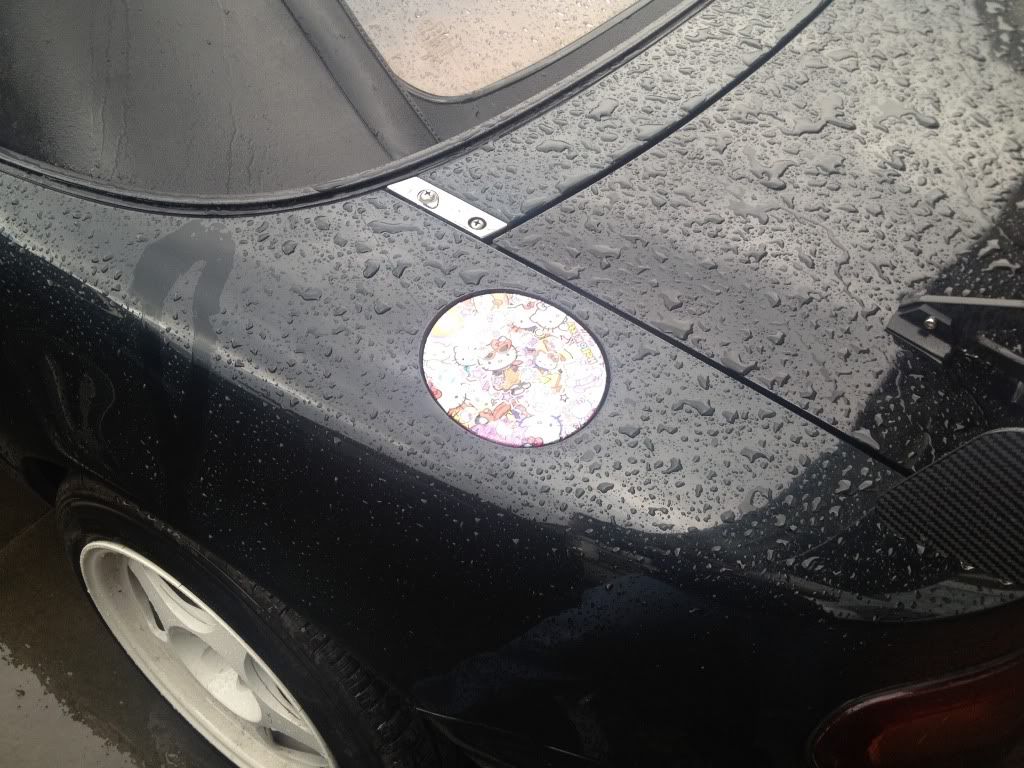

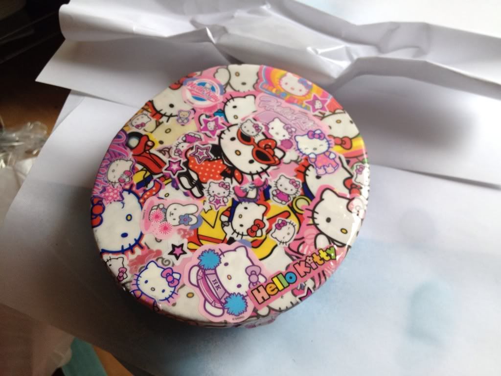

Remember the HelloKitty fuel lid?
It was made of awesome and winning. Hand stickerbombed, 3 coats of PVA and then 3 coats of UV resistant lacquer. It lasted a month and then the whole thing faded to white.
I haven't even taken a picture of it. It is that awful looking!

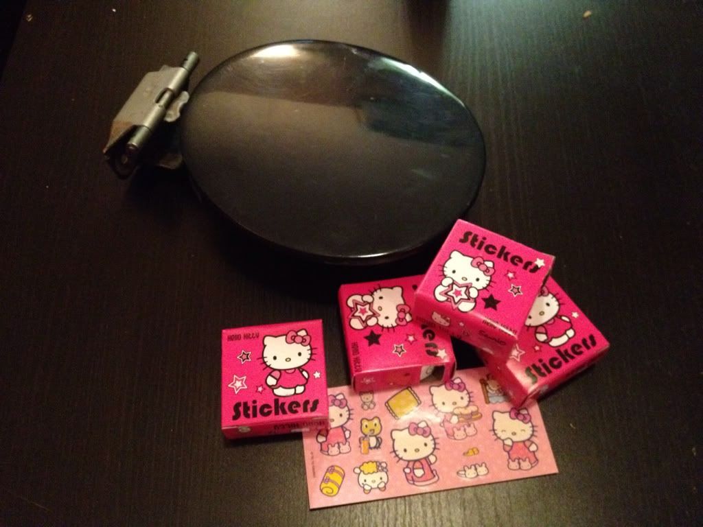

Quiet Sunday night in, Bottle of wine, good film on telly, a third fuel flap and 10 bags of Kitty stickers.........
Seems rude not to eh...
Needs to be lacquered.
With a lacquer that actually DOES resist UV rather than one that pretends to! If you know of such a lacquer then please do give me a shout!
