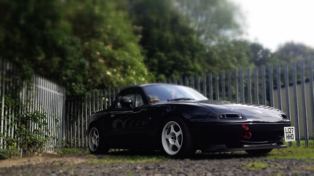

The weather was cheerful enough the other weekend that I could get the suspension swapped. The much beloved went off to of her Steampunk Markets so I had some quality time alone with my spanners. I'd read
plenty of horror stories about the lower shock mount bolt on the rear arms. Captive nuts escaping, cutting holes to get to them, odd shaped spanners, swearing, pleading and crying.
So I broke out the windy gun, sprayed some penetrating fluid on anything that looked like it could do with a squib, and attacked the lower shock mount bolts.....
Straight off the bolts came. No mess, no trouble, no tears. What is all the fuss about?
Potenza On Street! How frikkin JDM is that! Y0! But unfortunately they are made of granite. I sent them off to have the Kanji Translated and it says "Silly Englishman, these shocks will break your spine"
For curiosities sake I stripped the bits off the first HSD
It wasn't that interesting to be fair. A spring and some washer things and some locking collars. Big whoop. So I gave it all a good spray with copper grease. Then I made a bit of a guess at the ride height setting and
slapped them on the car.
The only tricky part was the two nuts on the top mounts on the nearside. Access is very limited due to the two pipes to the fuel tank. I struggled for a while but then gave in and removed both pipes. Then it was easy.
A slight downside is that I can no longer fit my spare tyre. The extended top hat mounts of the HSD's get in the way
I seem to recall there is an offset bracket for the spare tyre for just such a problem? Or did I
make that up in my own head?
Getting the fronts changed was also spectacularly easy.
What wasn't so easy was guessing the front ride height. The first attempt was ridiculous. Far far too low. Looked cool but would have been totally unusable. I aimed for 310mm axle to arch and after three attempts I
got 290mm. I was knackered by this point and couldn't be bothered jacking up the car agaiiiiin and having another go.
Instead I spent a week grazing the bottom of the GV lip on the slightest bump.
It annoyed me a little bit. I know It's totally unreasonable to expect.... but why can't Driftworks include some measurements in the instructions that set you to 320mm rear and 310mm front?
They had a car with a set of HSD's on. I know they did, I've seen the videos. I guess when I get the settings right I will take some measurements and send them to Driftworks.
Thankfully I got an hour to myself this weekend so I took the C spanner to the fronts and got myself back up to 310mm at the front. The rears have settled to about 300mm so that will be a job for another weekend.
It only took a few days to run up the 100 mile run in period on fully soft. So I have set the rear to 8 clicks from soft and the front at 6 clicks from soft. Seems like a good place to start. The improvement over the
Potenza set up is obviously night and day. I'm really happy with the way the car rides and handles. I wouldn't mind some dry weather so I can push it to ten tenths on my usual test drive circuit!
