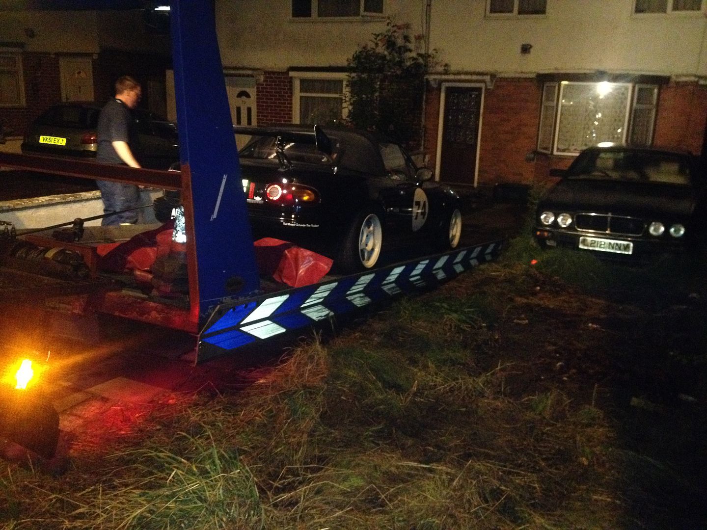

The conditions I brought her in. A masterclass in breaking every rule of car buying. Dark, Raining, Car with no history, Test drive to the end of the road and back.
Oh well. I'm handy with a spanner. I'll forgive myself for buying with my heart on this one.
Back home. Managed 87 miles before the snow descended and she got parked up for the Christmas break.

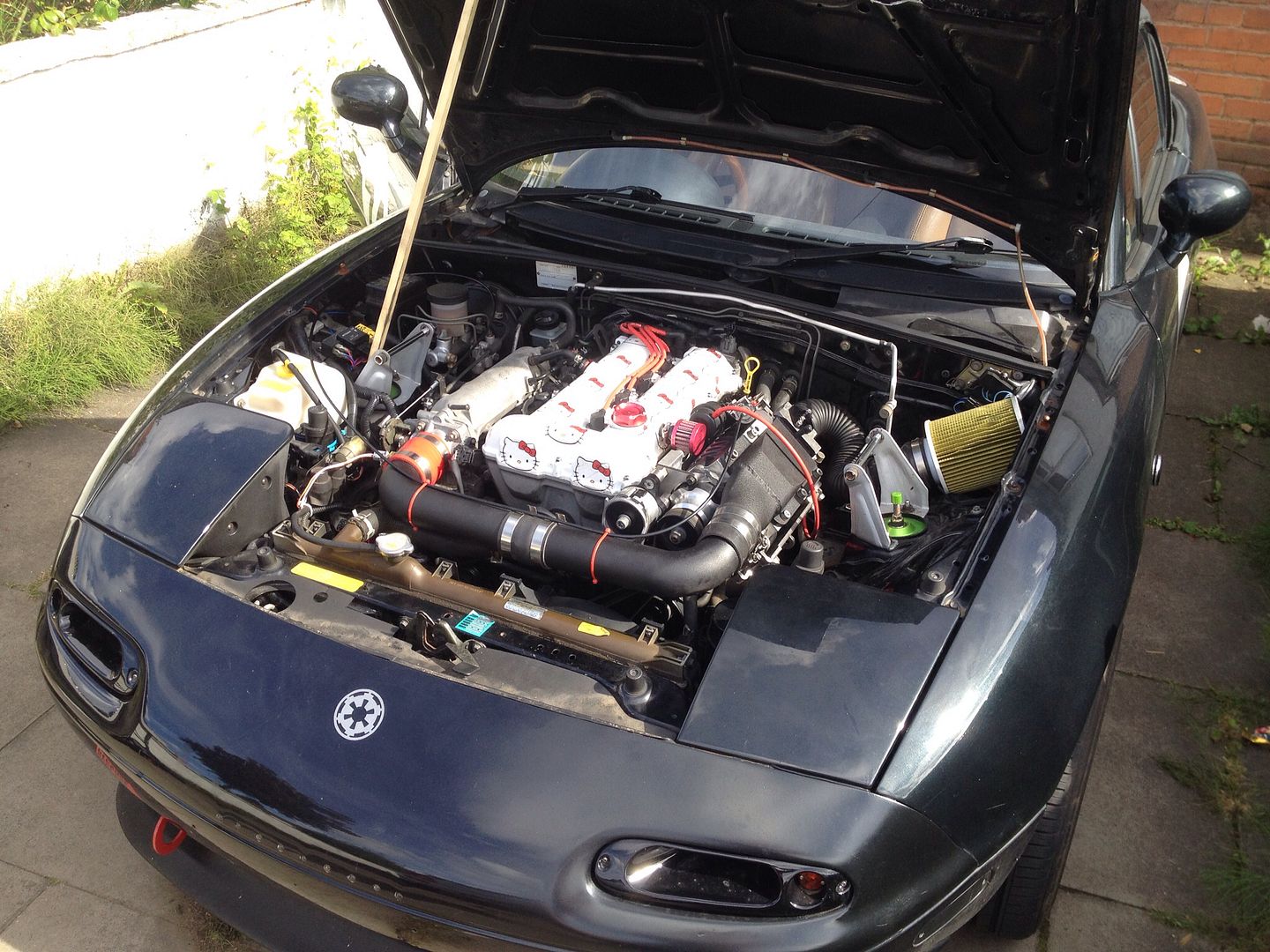

The final numbers are in..... Well, final, for now....
You may remember from an earlier update that Whisper went to see Dale at Bailey Performance and came away with 215bhp at the wheels. But she also revealed herself to have a failing fuel pump. This meant she wasn't maintaining fuel pressure at high rpm and the mix was leaning out horribly at 6500rpm. Not a good place to be. So at the last visit a spark cut rpm limit of 6200rpm was imposed.
Dale came up with the solution to the pump problem. He knows a guy who does a lot of work on Nissan GT-Rs. The fuel pump is the same form factor as the one used in an MX5 and in the GT-R it's good for 700bhp.
(Available here - http://www.mx5nutz.com/forum/index.php?showtopic=206866)
Problem solved :thumb-up:
(Fitting video will be part of the next episode of Garage C :yes:
Pump fitted, fuel pressure problem solved
COPS fitted, spark blowout problem solved
Back to Bailey!!!
The final scores....
219bhp at the wheels. Which I shall, of course, be rounding up and quoting as 220bhp at the wheels.
244.3bhp at the flywheel. Much more than that and the rods will cry 'enough!'. So until I go forged, that's a good place to be.
While she was on the rollers she did develop a slight driveline vibration. Which we think we narrowed down to the drivers side rear wheel bearing going a bit grumbly.
A little job for the winter during the subframe swaps I think :thumb-up:
We also, while we were there, added a little bit of timing between 1500 and 2500rpm. Which has taken out a slight flat spot.
As well as adding a copy of the first fuel map into fuel map two. But with all the fuel taken out of the bottom row of fuel map two. So now I have 'Everyday sanity - map1" and "Hooligan pops and bangs on the overrun - map2" :whistle:

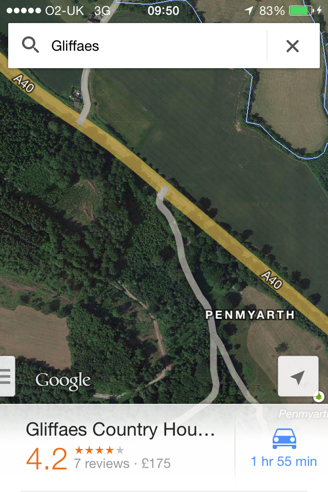

We went home via the 'scenic route'
