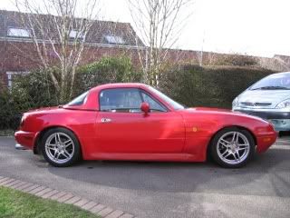

Heres a pic of my car with 15" alloys on -
Notice the gap between the rear arch and the tyre, a bit excessive I think. The tyres are 195/50/15, if I put 195/55/15 on, would that reduce it?
Or is it a case of lowering the suspension, and spending shed loads of money
Anyone any ideas?
Thanks, Rob.

spending a bit of money is the way! if you dont want to shell out the cash for some coilovers (which would be the best option!) just buy some lowering springs, if you got some coilovers which come up second hand ocasionally then you could set it at whatever height you want, other than that, as iv said just get some springs however if your going to the trouble of taking the shocks off you might aswell buy something nice to replace them with.. dont bother with the tyre idea.. hope that helps

What will solve your problem Is suspension, not tyres.
Definately get some new springs. The tyres will only make minimal difference.

Don't go fitting different sized tyres to alter the gap, you'll just balls up the handling.
Lowering springs are the cheaper option, avoid cheap ones, and you may want to fit new bumpstops too.
Best option is some adjustable coilovers, either with adjustable perch settings, or a threaded body to adjust ride height.

If you don't have the money to buy decent shocks then my advice is just to leave it as is.
If you fit lowering springs you'll need to either replace the bumpstops or cut the ones you've got.
Problem with this is the shock seals and shaft will be well worn in now, if you start using a part of the stock shaft that's not been used (because it has been protected by the bumpstop) then almost certainly you will pop the shock seal.
If on t'other hand you start fitting higher profile tyres you'll start loosing feel from the car.

I'm on Oz 15's with Marangoni 195/50/15's - Koni 1020-6072 sports springs & Koni 8041-1203/1204 sports Shocks - lowered the car by 35mm but if you go for the coilovers you'll get up to 40mm lower.....car came over from Japan with the springs/shocks already fitted & she turns like a go-cart.
You were right to choose the 15" wheels - general consensus for over all best handling

Ok folks, I have listened and learned to all the comments about this,thanks very much but, just hear me out...........
Currently on the car I have 205/50/16 on the rear, on the front I have 205/45/16. The ride quality is, in my opinion hard,and bumpy, and every time I drive over a bump. the CD skips
Surely if I put 195/50/15 on the front, and 195/55/15 on the rear, I would get a better ride quality, and not feel every single bump in the road, plus reduce the gap between the rear tyres and the rear wheel arch? (And also go better with the side skirts so the wheels don't look lost!!!)
I know all you guys are telling me to get spending on coilovers etc, but the ride quality with the 15" on must be better????????
