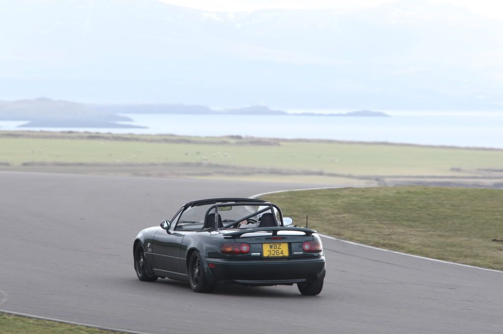

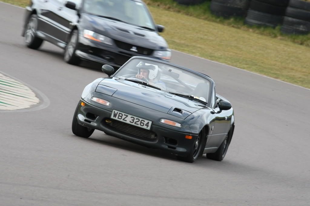

My last trackday was the first truely dry day and it showcased how much my car leans, compared to my old mans setup, (FM Springs KYB AGX FM ARB's), his car corners much flatter.

If thats a picture of your car as is is now then its more than likely that you are bottoming out and whacking bumpstops, indeed as Dave says you could have punched out the foot valves.
I had no idea that people were running that low on track use cars.
I should point out that we run 250 to 300lb springs on the rear of most of the Mazda race cars at a lowest height of 115mm to the lowest point of the sill and you look way below that point.
