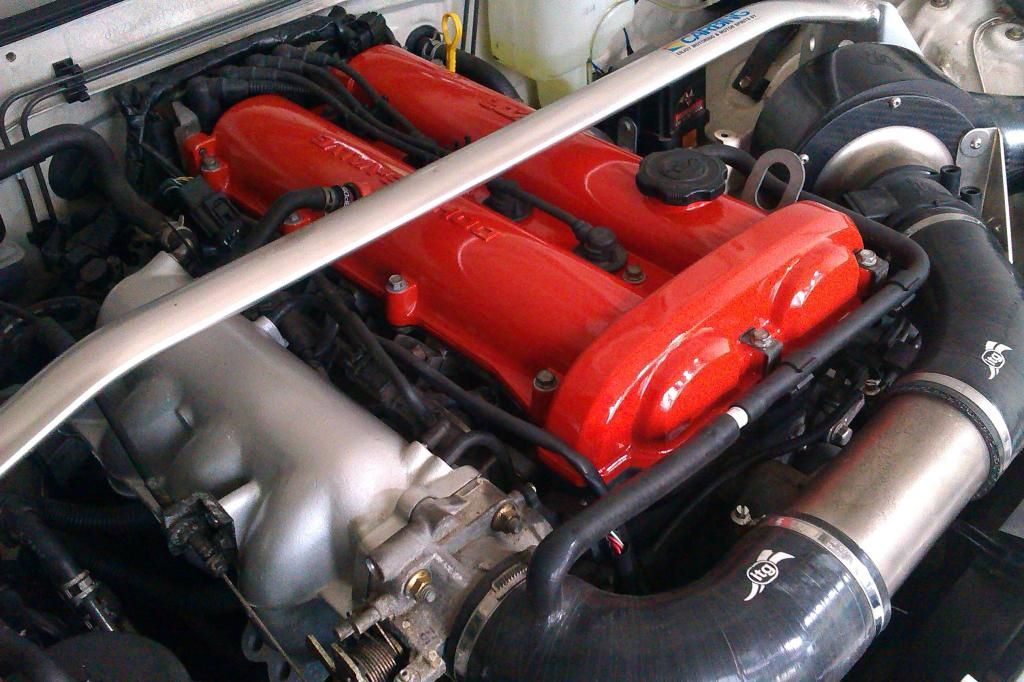

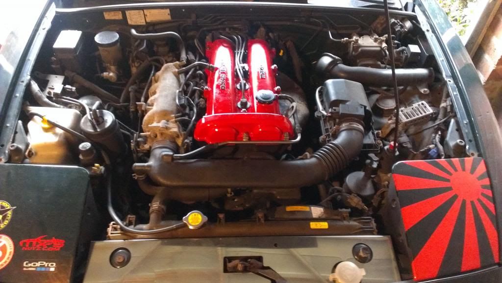

So spent the day sorting out my rocker cover. Stripping the old crappy paint job off, cleaning it up and repainting it.
This was the mock up that my other half made for me in photoshop..
This is what it looked like before. The paint was horrible and it would rub off on your hands if you touched it. Honestly not sure what paint it was, it wasn't flaking or anything but if you were handling the strut brace or the rocker cover the black / red would come off on your hands..
White spirit and steel wool later..
Base coat to clean up the surface (using anodise paint).
Then masked down the middle and sprayed the red anodise paint.
Masked up the red bits very carefully to get dead straight lines. And out came the black paint. Then Lacquer over the top.
Let it dry for 2 hours fitted bit back on and took the car for a blast to cure the paint off.
Thinking tomorrow about doing my intake manifold all red. Bit dubious about removing it though as I dont think I'll be able to get new injector o-rings, or a inlet to head gasket (if I need one).
and these are the paints..

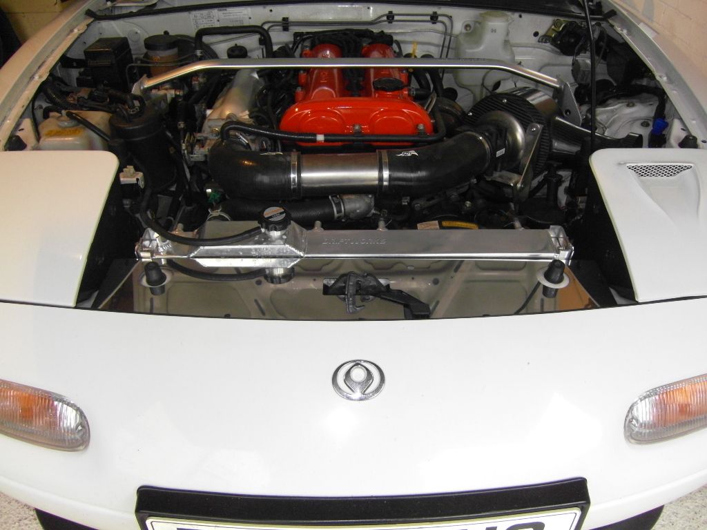

Here's mine :
434118D8-2A59-4432-8841-DEF058051198_zps
#6 · (Edited by Moderator)
And this is it in place with the painted inlet manifold to :
3EC77350-11E9-4200-A07C-BEF1DE28D989_zps

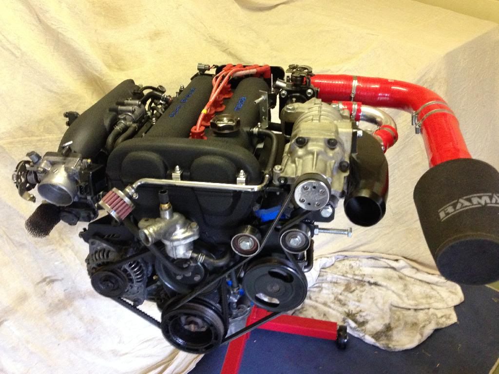

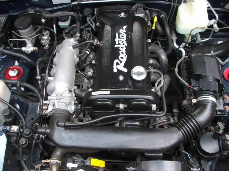

I'm trying to think of what colour to do my rocker cover, inlet manifold and lettering in my black car.
Red wrinkle looks nice but it might be a bit overplayed. Also I have Red HT leads so it might not work.
I could do them in black wrinkle with red or blue lettering, that might look good. I'm going for a bit of a retro style with the car do having blue highlights everywhere might not look right.
What's the best combo?
How do you plan on doing your lettering?
I'd imagine the best way to do the lettering would be to spray your cam cover first. Put masking take all over the area with the letters, then just cut out each letter from the mask with a sharp knife and spray your letter colour.
That's what I'd do.
