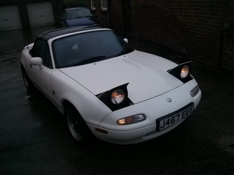

This bit works fine:
Looks lovely outside:

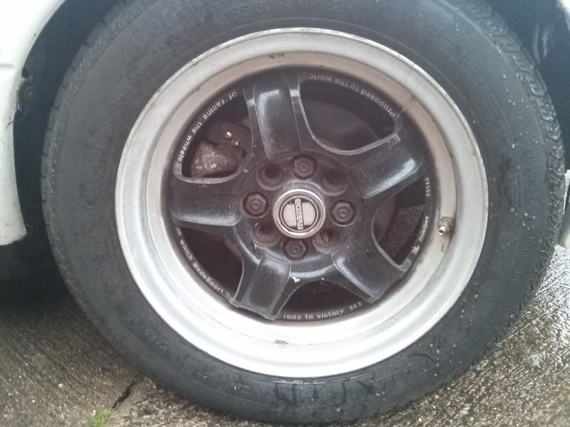

Wheels need spit and polish but must be fairly rare as I've never seen a set before, shame they're black as they're not to my taste:

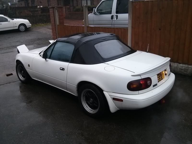

Threw a bucket of water over it while I'm waiting for various parts to turn up.
Staggered 14s look ace
The hardtop is supposed to be chaste white too but is a slightly different shade, no biggie though. I acquired a set of gaz gha coilovers today, they came with a car attached as a bonus!

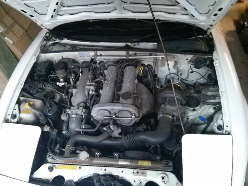

and engine bay boringness
I've also since bought a greddy eManage ultimate and some other bits for the turbo conversion, still need to get a wideband so i can make a start on it.
