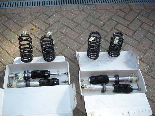

Hi all, i`ve just bought these
and i`m not sure what top mounts to use, i have tein ha pillow ball, fm rear, and standard mk1, any suggestions welcome.

i used mk2 mounts when i got mine
what springs are those they do not look anything like mine (i take that back just had a look at some of my old pictures )

Pat, would i be right in thinking that you fitted yours to a mk1, if so what ride height did you set them at, i was hoping to set mine at twelve and a half inches front and thirteen rear, cheers tony.
Hi,
Mine's set at 300mm front and 310mm rear with 195x50x15 888's.
Tis mostly a track car though.
As for clicks, 9 on back and 8 on front seems to work well as a base point.
Pat...

Nice one Pat, i`ll stick to those then.
