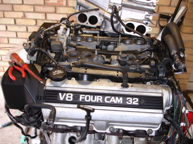

The engine being cleaned, wiring identified and generally being sorted out ( hopefully)

There is no deadline, just fitting it inbetween everything else sadly. Started in March when i bought the pimp mobile, spent ages marking up the dash wiring and engine wiring. Then found that a lot of the wiring falls by the wayside as you get into it. Ive ditched the a/c compressor which was easy, finding a shorter accessory belt to fit wasnt. I also ditched the radiator fan pump on the front of the engine and the traction control. Ive identified most of the remaining wiring. All ive got left on the engine at the mo is to degrease it, refit a tensioner pulley ( had a dead bearing), clean and spray the crankshaft pulley black ( its rusty and is annoying the hell out of me!) and fit the shorter drive belt. But to get to the engine i have to move the red mx, swap the battery into the silver mx and move that and then pull the engine out on its stand- all of which is a real pain! But ,hopefully if the silver mx sells life will be easier

Thanks everyone . Im not the first to do this conversion by any means, if you search for " Andris" on lextreme ( loads of lexus info and conversions) and the mx5 miata forum you'll see his amazing work. I bought the Lexus as an mot failure for ?510 from ebay. The engine is a lot heavier than the mx5' s one but they are 250 bhp as standard. Hopefully with a decent exhaust, no cat ( deliberately bought a 1990 mx5 and lexus ) and decent induction will be a few bhp higher. Then if you have really deep pockets, you can supercharge it , twin turbo it or have individual throttle bodies. But space under the bonnet will be a limiting factor. The wiring does look a bit scarey to begin with, but with lots of reading is beginning to make sense. Im hoping other people on here give it a go- it has been very time consuming and will be quite expensive. Im keeping a running total on what ive spent so ill let everyone know from time to time where im at on the money front
