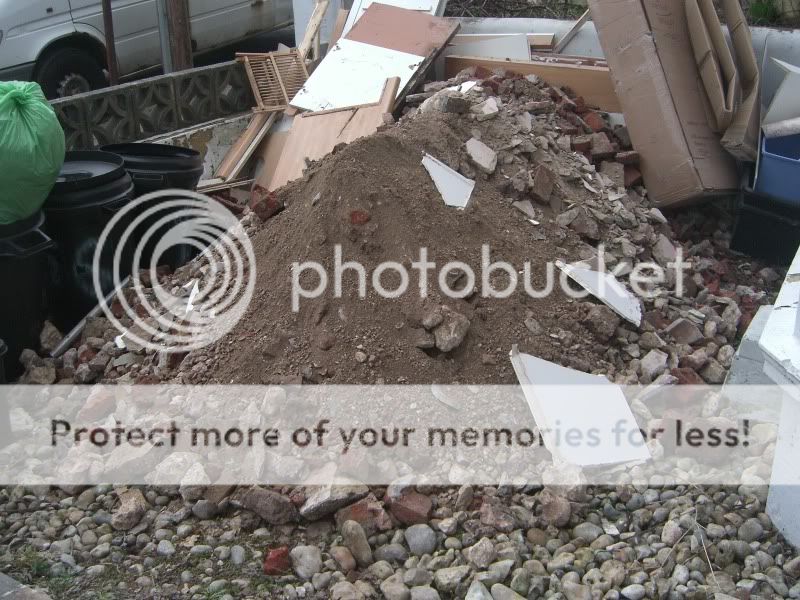

The mess in the front garden

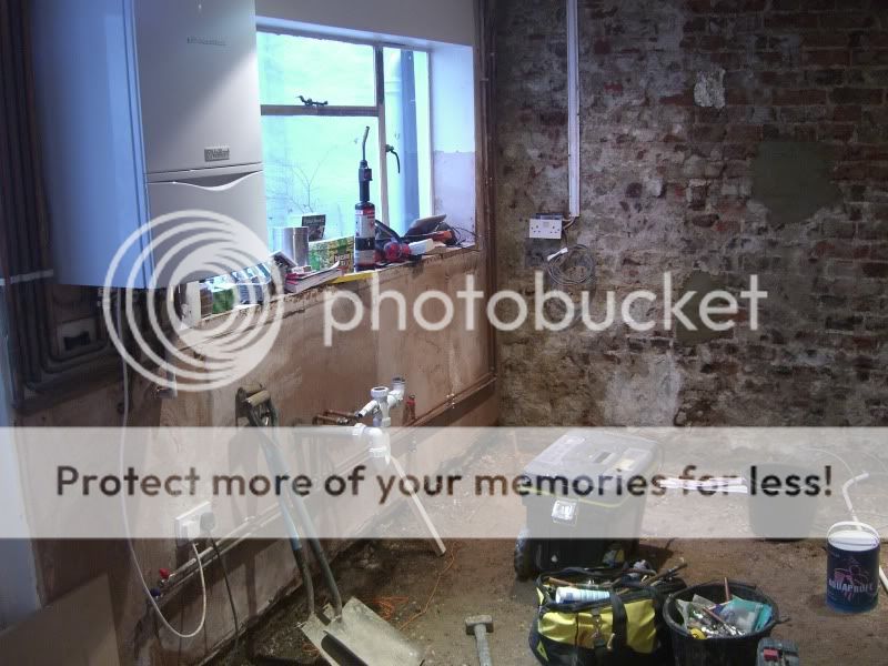

Bit of wiring & plumbing work

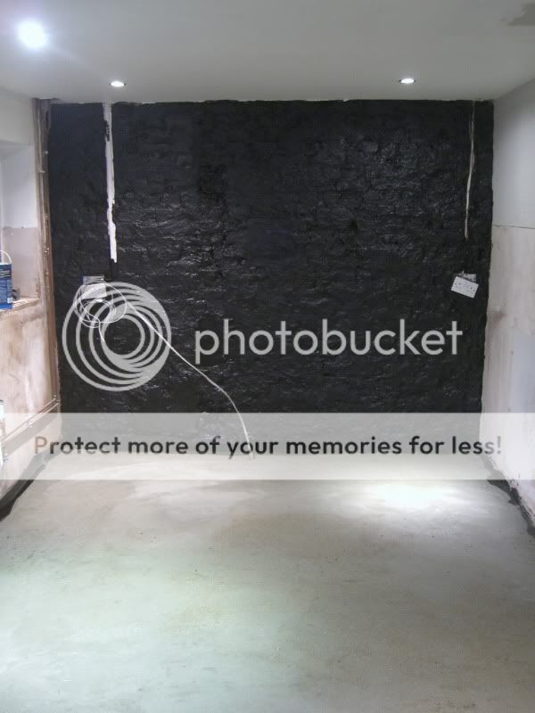

Back wall synthaproofed and a new concrete screed floor
I worked out that that floor took 2 tonnes of sand and cement!!!

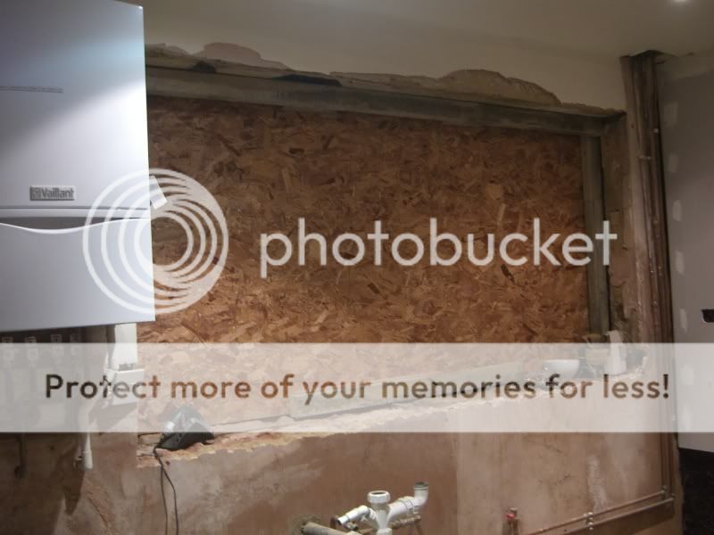

Old window removed and boarded up while the new one is made
New door in, awaiting glass
Back wall plaster boarded

What's the idea behind the synthaproof? That's a new product to me. Whatsitfur??? Does it dry 'sticky'. Does it paint on? What goes on the top? Etc. Share your wisdom.
Synthaproof is a paint on damp proof membrane. It is bitumen based and VERY sticky when wet but not so when dry. I believe you can plaster or tile over the top of it but we put a plasterboard wall to aid ventilation
