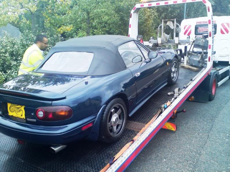

And here is my S-special 97, a rather ignoble shot of it being loaded due to a bad ground.
