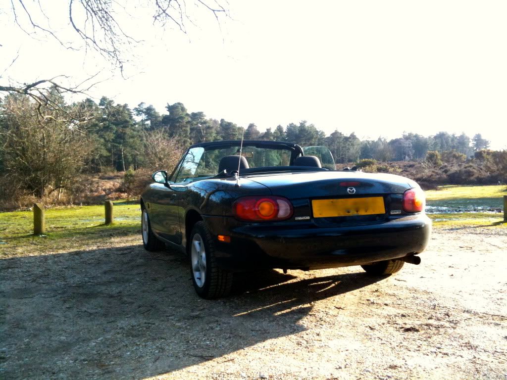

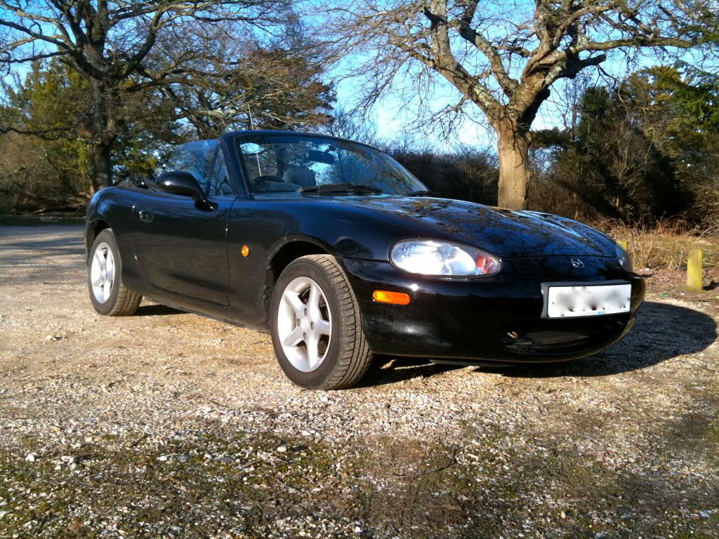

I just thought I would stick up the first few pics of my MK2. I was out on the New Forest for a relaxed drive round yesterday, it was fantastic. Please excuse the dirt, but I was enjoying driving it rather than washing it!
My first weekend with an MX5 and I'm rather happy!
