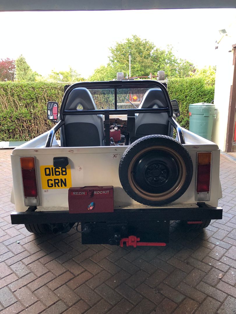

But the rear lights and splash guards were fitted, changed the screw in bracket to two pairs of Studs in order to make seating and tightening a lot easier.
Ultimately, the wiring ended up entering high and on the opposite side, so original access now surplus.
Should make a huge difference to splatter and keeping things clean out back.

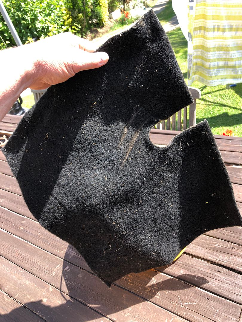

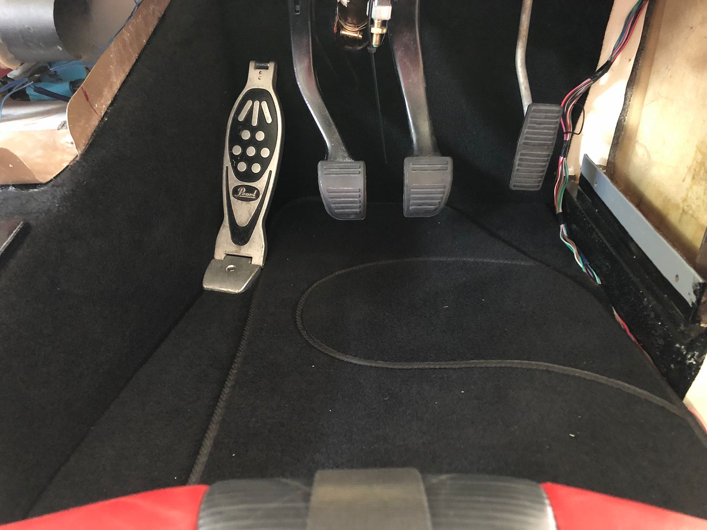

One of the jobs that kinda stalled was to get some automotive carpet in behind the pedals and onto the firewall, to cover the high density foam I previously added.
I was not going to buy a roll of carpet just to use a 500x500 piece.
So I rummaged in the bits of carpet from the original floor and found it……..
The original piece.
Bucket of fairy liquid, washed followed by three rinses and set out to dry, it was a hot day.
Edited and cut to fit as footwell dimensions have changed slightly.
Brutal contact adhesive and fitted.

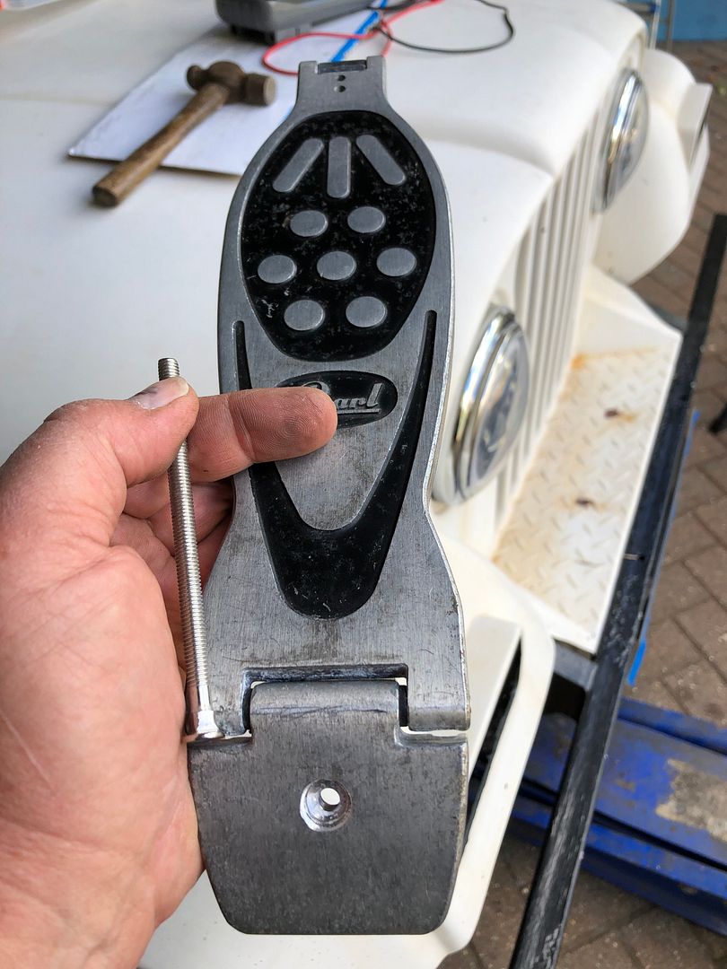

Next small job I needed to do, which had waited for the carpeting to get completed was a left side footrest.
I had desperately wanted to use the one GRIZZ footrest that Andy in Oklahoma had cast for me.
Only problem it turns out, was it was a right foot, so only good for an accelerator pedal.
So I went to plan B which has laid in the wings for years.
Can you tell what it is yet? ( I used to have a coffin shaped one too, gave it to,someone)
Some planning, finding a long enough bolt to go through the floors etc.
Remove the carpet before drilling, as you know what happens if you don’t.
Job done.
Nick holding the i side down while I tightened up the Nyloc underneath as my arms would never reach.
Really happy with the result.

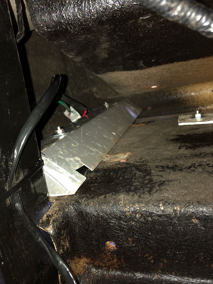

While I played with these cosmetic finishes, Nick continued to make up magical wiring harnesses, extending non extended, 10mm cut off wires etc to give us a pair of these……
Working.

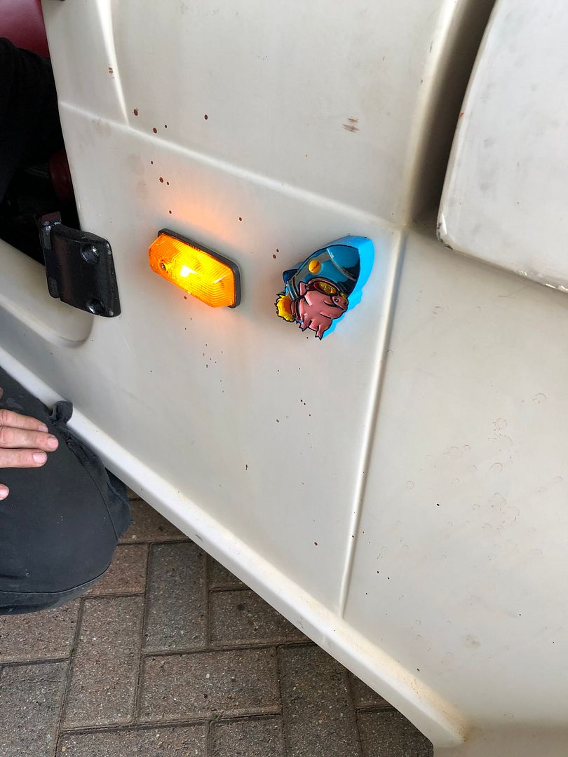

In the mean time again while he was measuring up the handbrake for missing parts that need custom making, I did some woodwork, after finding some solid Oak.

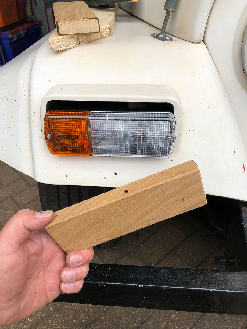

Supports for the front indicators and marker lights to rest on when fitted.
The new lights are slimmer by 20mm than the originals, so some filling in will need to be done.
Part one.

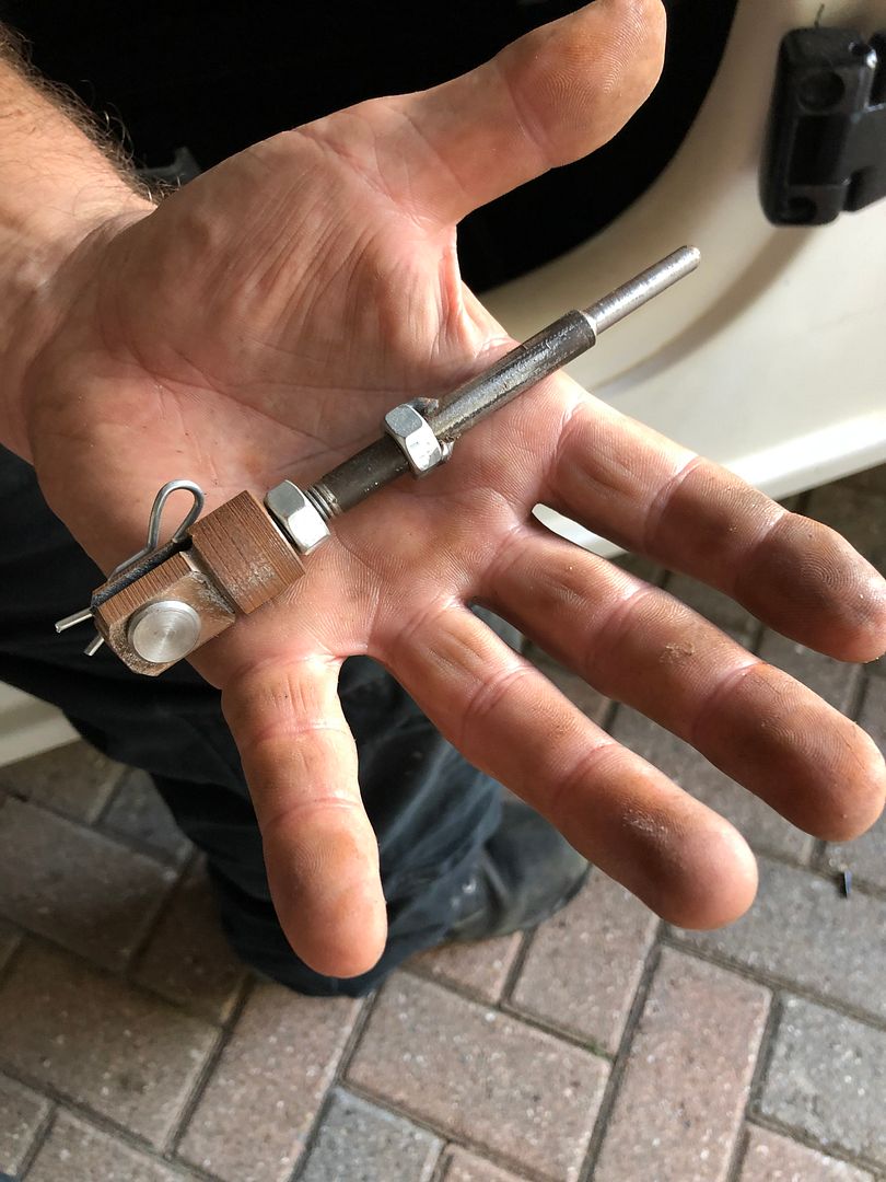

Back to the pedal box and clutch pedal.
A 3mm change is needed to make things work more smoothly.
No way we are adjusting the firewall etc.
So out came this guy.
Watch this space.

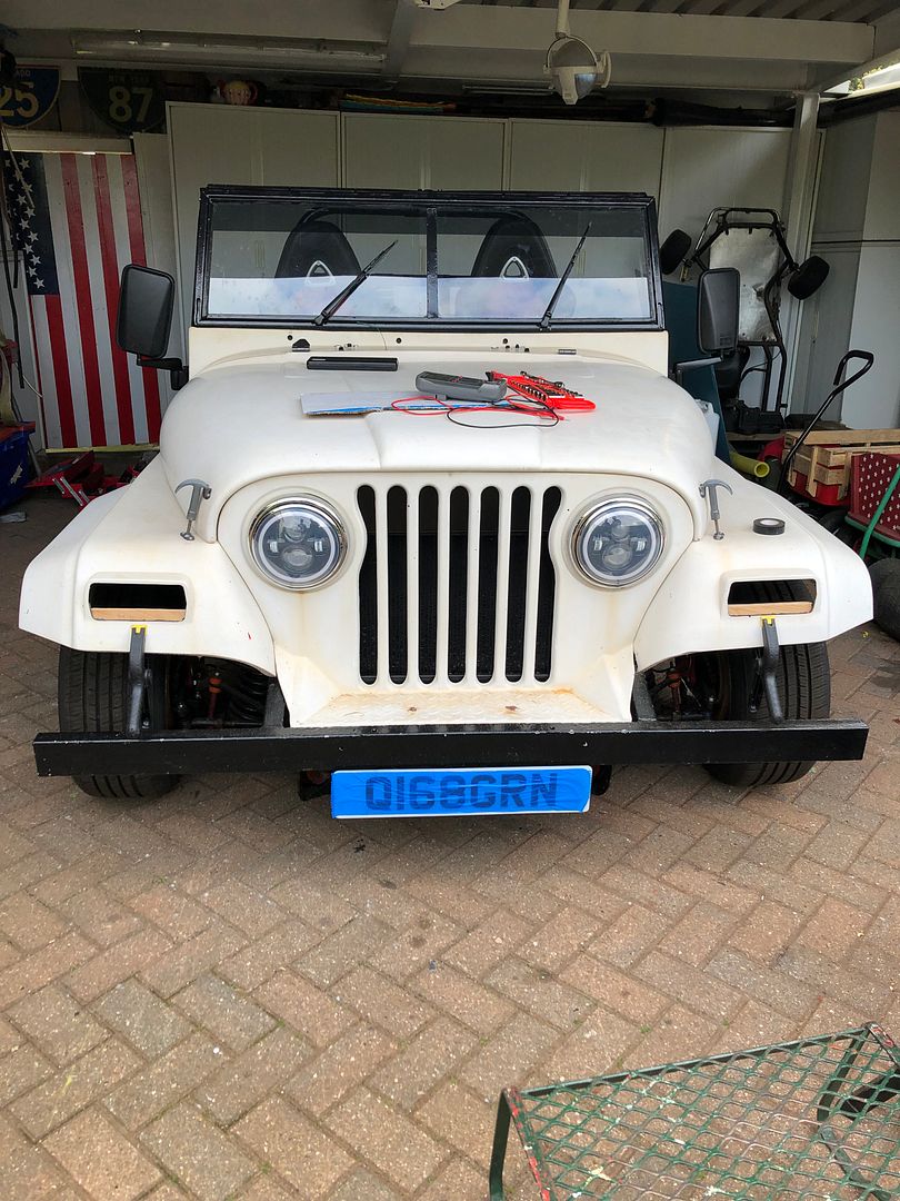

Bought some relays for the headlights.
Seems I bought the wrong ones.
Need the other type.
Bugggerr.
Nick suggested….. They need to be double 'make or break' and not 'changeover' like a lot of 5 post relays,
But I still managed to get it wrong.
Seems the MX5 has some or other positive earth or whatever, I don’t understand.
So the LED headlights need some cleverness.

So John and I went and started on the side lights, under the carport by 09.00 ( I had been up before 06.00 and run through a load of admin before 8.30 )
It took us nearly 4 hours to find a fault in the drivers side, including disassembly and checking of the rear lights that @nickwheeler had previously sorted.
Mate Martin called around 12.30 to see how I was enjoying the heat as his company had shut for the day, speaking with John, they narrowed it down to a duff earth as the side light was acting as indicator and various tests showed passenger side was fine.
One shortcut earth and it was all good.
So wiring was soldered in place and I bonded both the side lights into the fenders for the final/first time.
Once these were done, it was time for a cold celebratory beer for John, water had been flowing all day.
Using 4 different sets of instructions and Google, replacing one blown 15 amp fuse (possibly just a wire touching and shorting at some point) we proceeded to decipher and get the relays I had bought previously to work.
At some point the one side tested like this……..
A few hours of work found both headlights, the halo’s and side lights all working.
A lot of forward and reverse went on through the day, neither of us are electricians, and Martin’s advice helped John understand the intricacies more clearly.

Nick had come bearing gifts that had been burning a hole in his pocket for a while, but with,certain situations out of his control, it was the first chance to get over.
Remember the clutch actuator he took away a few weeks ago?
Replacement made with offset lever, and paint….😉
Also some custom nuts for the brake light switch and a spacer for the handbrake on the rear axle.
Christmasses all in one…..
Looking forward to fitting these parts of the puzzle.
Thanks a lot Nick.
