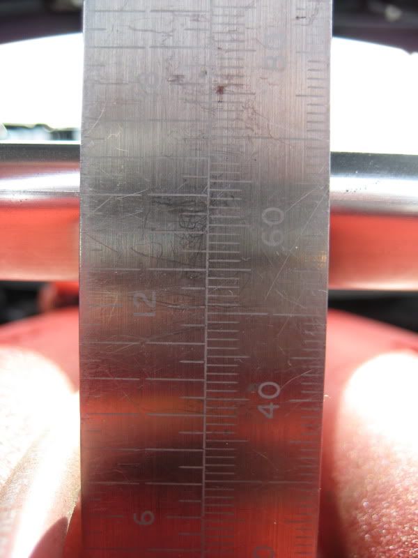

Before camcover against strut brace.
Jack the car up on to axle stands (not ramps).
Place jack with block of wood under the sump, just to take the weight of the engine at this stage.
Undo these 14mm bolts (one either side)
One the passenger side you need to remover three 14mm bolts.Easy through the wheel arch with wheels on full lock (can't do that with ramps).
Now these bolts on the drivers side. I struggled on the MK1 with after market exhaust, but stock seems OK. Again access from wheel arch.
I had to jack the engine up more and remove the plenum support to get the mount assemblies out of the car.
Remove the mounts from the brackets by undoing the one 14mm nut.
Heres old and new for comparison.
Reassembly is the reverse
And the result engine now sits 5mm HIGHER!!
I'm guessing they will settle down and will check back later.
Engine is absolutely rock solid at idle with much less rocking when I blip the throttle.
