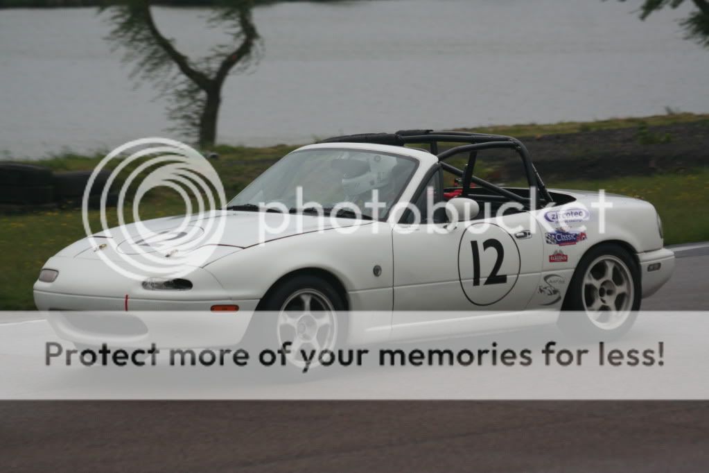

Then I had my white MAX5 car which we had great fun in. This picture is from Mallory and we got our best result of the season with 3rd overall that day. Damp and twisty circuit just played into my hands. Now sold.

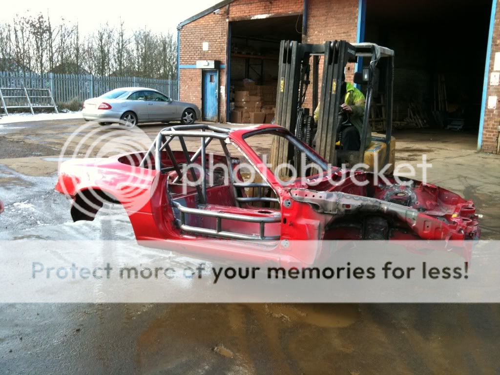

Getting back on track with this thread, here is a picure of my car as I last saw it at Surface Processing Ltd. They just lifted it of the trailer! Not very heavy then.

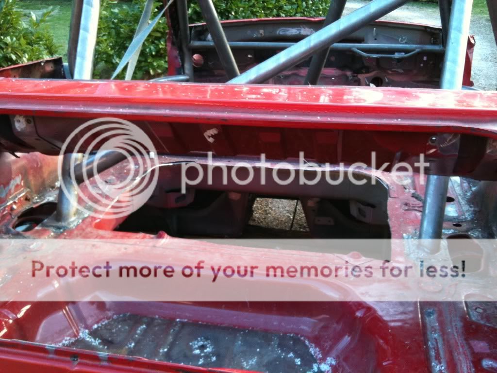

Then the most current shot of the car

Yes once I have have the car back to bare metal, it will come home for some work to be done on it and then go back for a secondary dip to remove any new crud and surface rust that reoccured and then go for what they call e painting. This is a dipping process not a spray on process. I have had to drill holes to ensure proper drainage and these will have to be welded up later. Kinda defeats the object of dipping and painting if you then have to weld up holes but because the process is a hot dip process it sucks liquid into holes that are really tiny and so if it got into any tube or enclosed space it then causes issues later. You have to use 4-5mm holes to ensure proper drainage as otherwise the surface tension will retain liquids. Because the e paint is really a sealant/undercoat rather than a finish coat welding up some holes is annoying but not the end of the world.
If you go to the Surface Processing web site you can watch videos of the whole process. They are pretty much the only guys in the country who do this. I looked quite hard and couldn't find any one else who did this proccess. I stand to be corrected! :)

Andy Robinson Racing did the cage for me. He is a specialist in this field and also on committees for the MSA with regard to Drag Racing but also advises on roll cages. This cage is an FIA/MSA approved cage to suit my needs and purposes. It is designed to go under my hard top (which is a lightweight hard top) and the cage is also responsible for holding the roof onto the car as well. Therefore no heavy fixings as per standard roof fitments. 4 * M6 nuts and bolts for me. I am not as worried about water tigtness as some might be so no rubber seals used except for the front leading edge of the roof.
I had bought a Safety Devices cage to use. A bolt in design. That weighed in at 52kgs. This one is big smile inducing lighter! And I think a far superior design. We looked at the cages used in the states, other custom cages used in some drift cars, the safety devices item and then picked all the best bits and features, combined that with Andy's huge experience of cage building to come up with this cage. Andy prices his cages according to the number fo fixing points and extras, eg I had the hard top mounts built in and also a drivers net fitted. I consider safety a high priority so the investment is worth it to me. But it was not shockingly expensive, so Russell, phone Andy and talk to him. If he is outrageous in pricing now then I got even better value for money than I think I did!
The side impact bars do mean you have to gut the doors of your car. Really gut them. Doors are heavy so I was really happy to do this and am still looking at them for ways to reduce their still heavy weight (in my eyes) some more. I have discounted carbon as the quotes were too high for now.
This cage also required the complete removal of the dash board and cross bar, plus the rear parcel shelf and other bits and bobs of metal around the place. Being welded in and stitched to the shell in numerous places, not just up the windscreen frame, should mean overall stiffness is well up. I did think of going through the front bulkhead to the top mounts of the front suspension. I did not as the gain was percevied to be slight compared to the cost and effort. But it would be easy to come back to that later if I think it neceesary after testing. All that I have spoken to with cross bracing in the engine from one top mount to the other have said it had only a small effect. And their cars would not be as stiff as this one will be as a starting point. So I am leaving it there on cage and struts for now but you can see some seam welding has been done, in accordance with the FM recommendations, but having the car dipped will allow me to easily get some extra seam welding done in places not normally available for it. Trying to seam weld pre dipping was difficult.
Being six foot tall did create problems in meeting regulations on head clearance to the roof and cage structure. I had a custom carbon seat made, based on one from a Panoz so I am told, with ali mounts so that the seat touches the rear bulkhead and the floor at the same time. I also moved forward the chassis rail that OEM seat mounts bolt on to forward by about 8 inches. This allows fitting of runners to the seat so that when in multi driver mode the seat can be slid back and forth but without lifting the driver. This may not be that clever a decision as short drivers not only have short legs, but shorter torso's so when checking that the wife can drive the car she was so low down that she could not see the bonnet at all. Ooops! Might have to put legs on the front of the mounts after all. The seat is very comfortable and stiff, and also very light. The carbon element was about 2.7 kgs but haven't weighted it with seat mounts on yet. For now using OEM runners when needed.
As to final weight of the car, that is a bit of guesswork right now. But my MAX5 car was 865 kgs ex driver and so I should easily beat that figure. Currently the car weighs 248kgs but there are a few bits missing......
