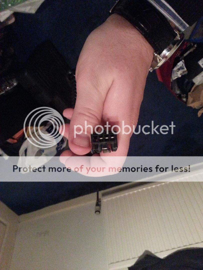

Right I forgot about this until I tried to sort it again yesterday but still no luck.
Here is a pic of the loom on the hard top with three connectors.
The wiring from the car has two separate female spade connectors.
How would I wire this up to work?

#13 ·
I gecha your fiting a mk2 hard top to a mk1? The third wire on the mk2 is to the aforementioned switch completing the circuit back to the switch. Test the 3 wire harness 2 of the wires will be spliced together these provide a common earth (so it doesn't matter which you connect) the other is your live feed.

#17 · (Edited by Moderator)
This is the back of the MK2 connector car side. Blk/red is the +12v , blk is your ground, blk/ wht is the return ground to the switch.
The blk/wht is the one that would earth through the hood up/down switch and needs to be earthed for the switch to trip the relay supplying the +12v feed.
On the hard top harness the blk and blk/wht wires are spliced together completing the soft top switch circuit. The resulting single wire is the earth to the window.

#19 · (Edited by Moderator)
Sounds like it's been botched to buggery, splicing the 2 wires together to get around the missing switch. In which case as long as you connect the middle wire and one or the other of the outer wires on the roof side to the 2 wires car side it should work? Don't think the polarity matter with a rear screen?

#21 ·
does the light come on at the switch?
#25 · (Edited by Moderator)
Yes red/blk is your live, but you need to have 2 other wires both black? These both need to be earthed. One provides the earth for the window and the other the switch (as your light comes on I suspect this is fine). If you are getting no power from the red/blk wire you may need to be looking atnthe relay. You need to get a dvm out and check continuities. Check defog fuse (the switch is a different fuse).
