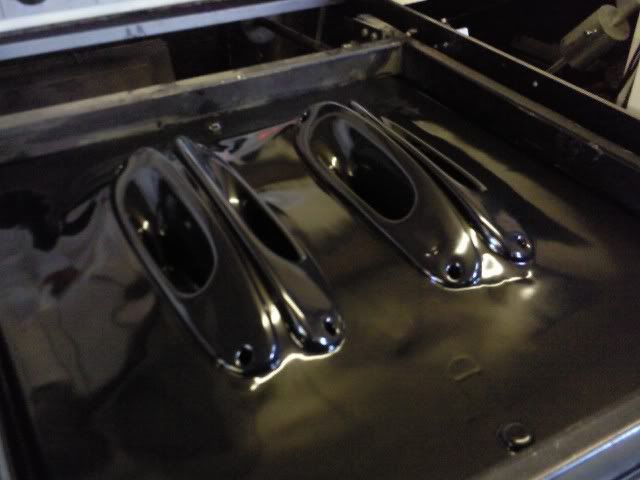

Baz whatever you end up doing mate dont forget a fresh roll of this...
