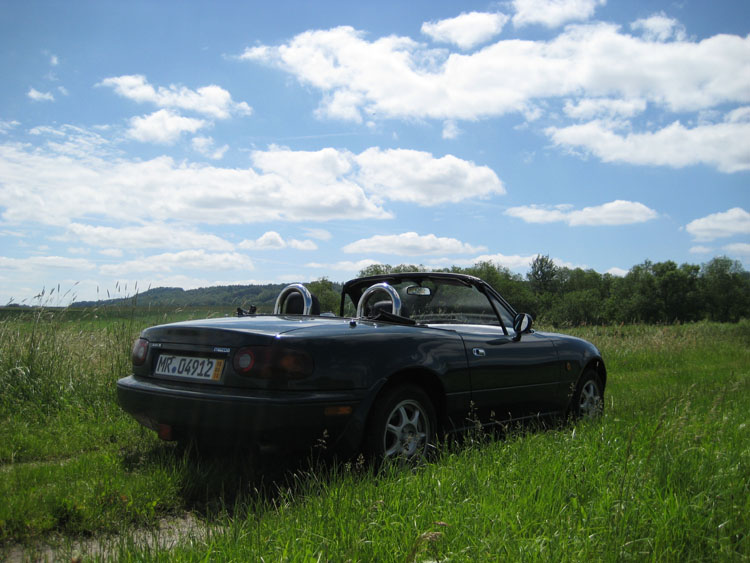

Hi fellas,
since i joined Nutz a while ago and promised pictures here we go (just copying posts from Clubroadster for the start).
That's the car as a bought it:
(at the german coast)
(just where i live)
I'm gonna try to keep the car as JDM as possible.

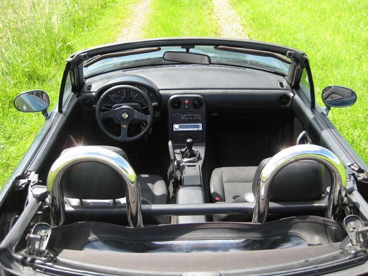

Yesterday i started fitting Miata side markers and S800 mirrors, did the Eunos Roadster rebadging and also removed the silly "rollbar"
