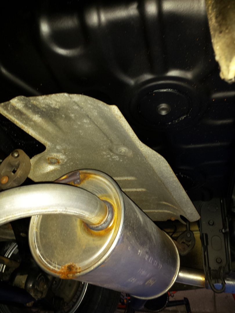

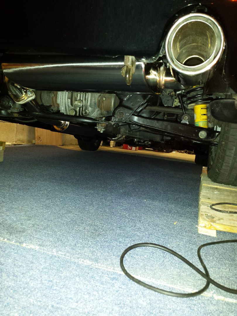

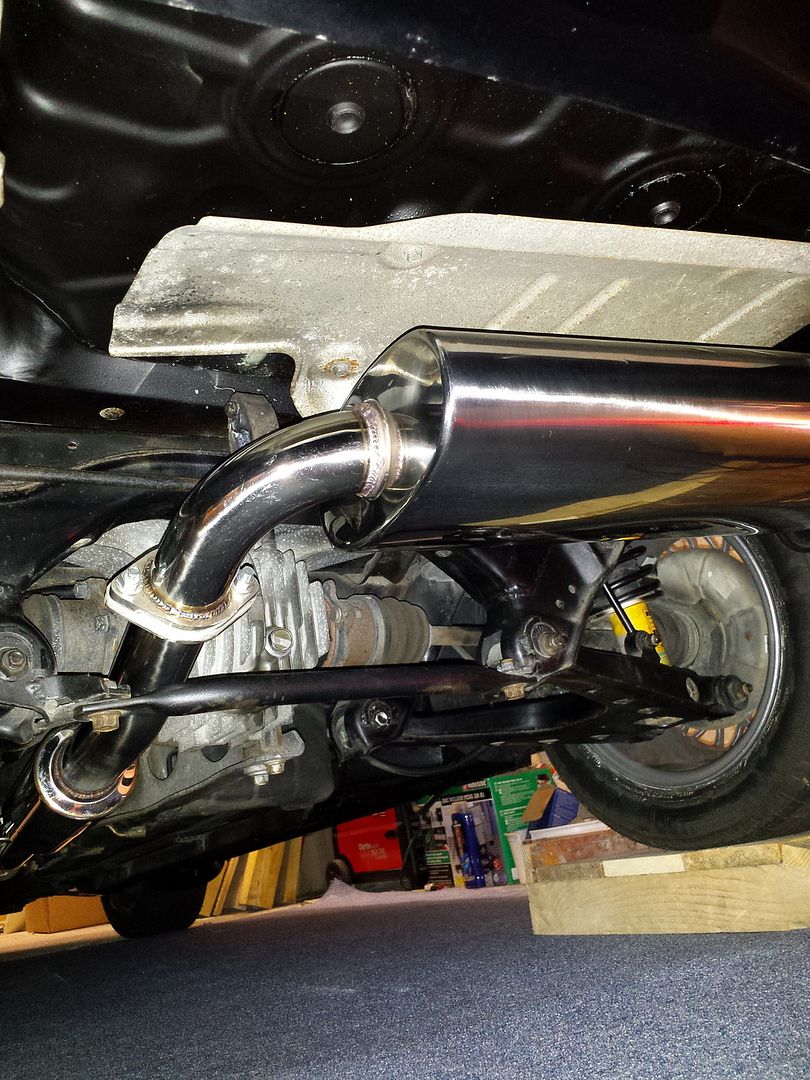

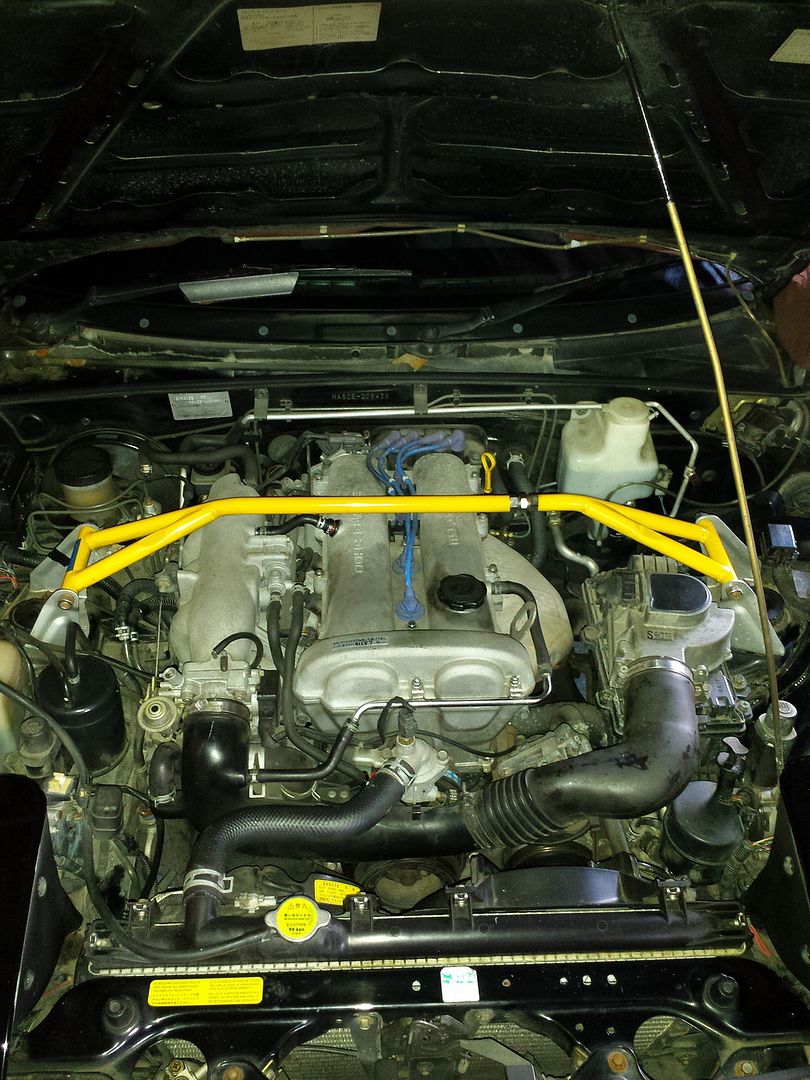

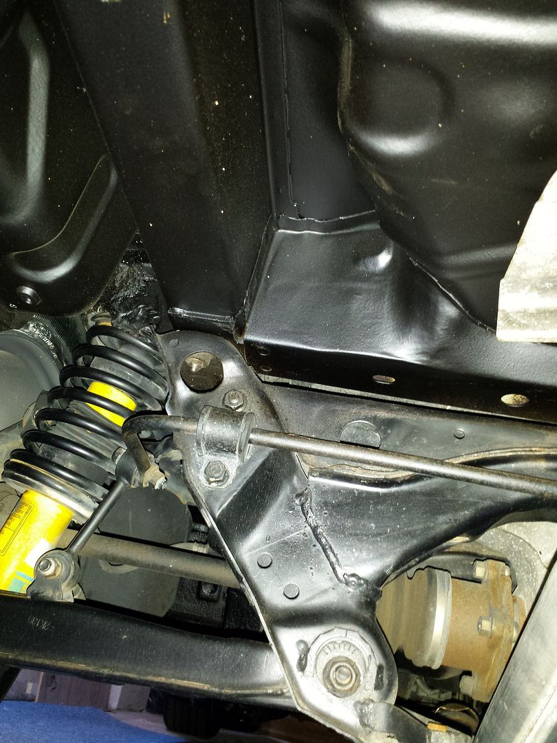

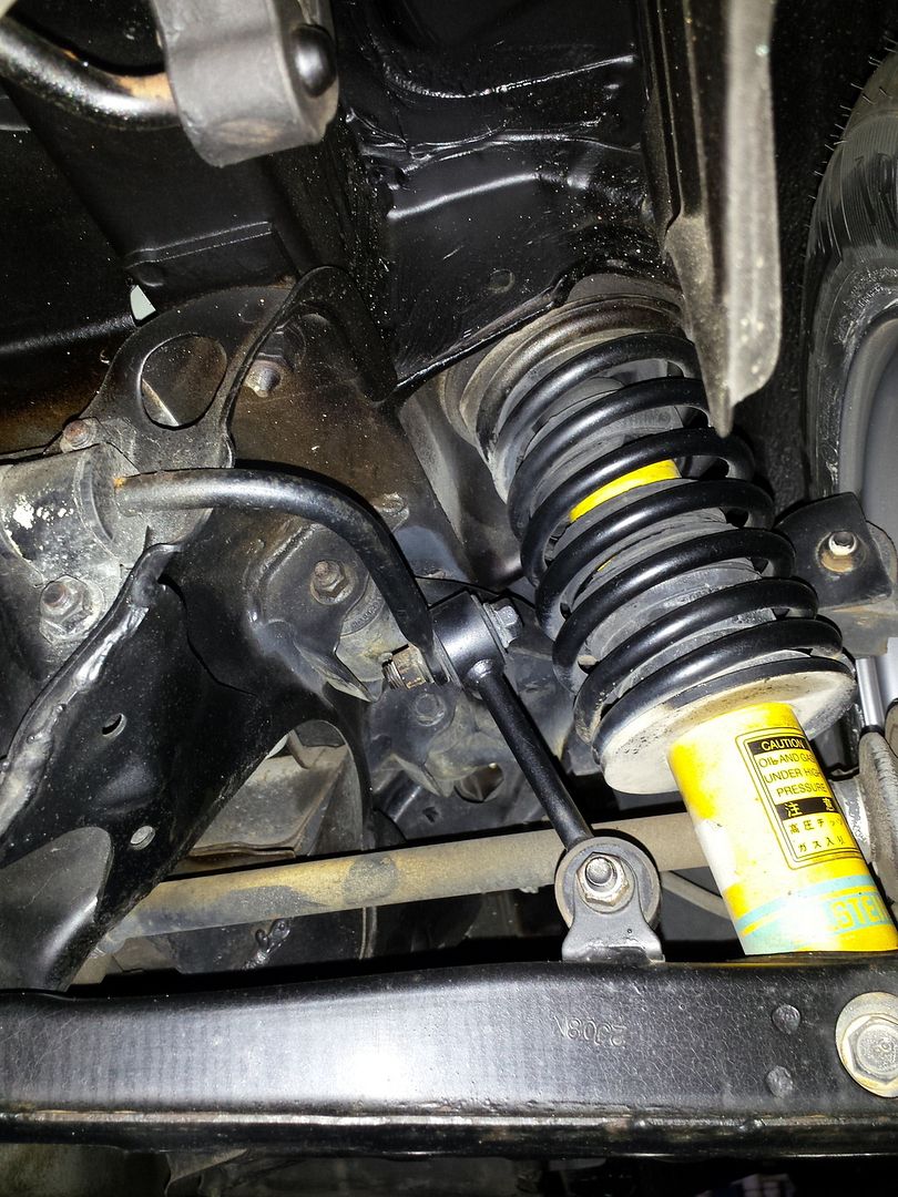

Just updated a "what have you done" thread so thought I'd post a few pics up here....took the 5 out for a quick run today then took some random pics of rear suspension /underside/interior/engine bay....I think the next job before the car goes back into regular use will be dynax ub the wishbones etc....read a thread on it here and it seems to get a good write up....up till now I've just been giving them a wipe over with wd40 etc.....the car doesn't really see much rain but it would be nice to do it anyway ....we'll see what happens.....please excuse the crappy camera phone pics of the interior. ...they make it look grubbier than it really is!

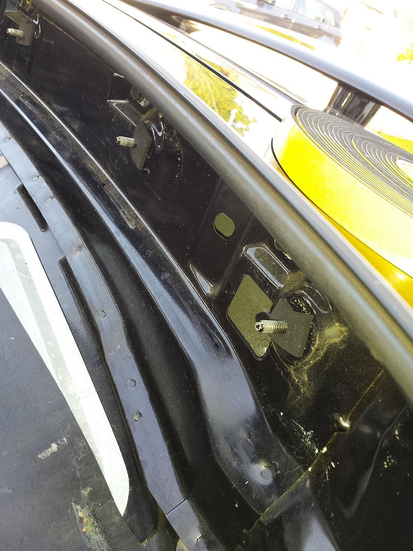

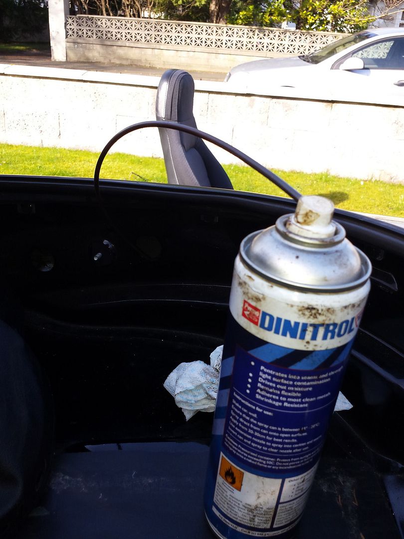

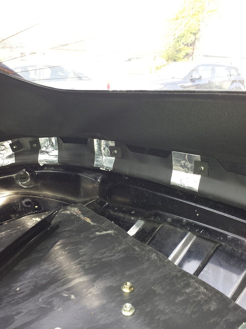

The rain rail had a couple of drips coming from where two of the bolts were....turned out there was some fabric washers missing....thankfully what little water there was just sat on the back deck....could've been a lot worse....so the rail came out for belt and braces fitment of washers/tape and silicone...the rail is in 1st class condition but it was out anyway sooooo....before I refitted it sprayed some leftover dinitrol into the rear arches/lips to try and preserve them for a while yet
Neoprene ordered up and cut to size for filling washers between rear deck bolts and rail...silicone added as well but not in the pics
Then Dr MX5 silicone washers on the inside....yyou can see the silicone sealant oozing through for a good seal

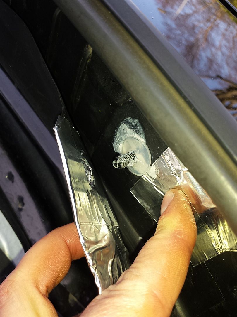

I siliconed then taped over all of the unused rivet holes so they wont leak..
Then hood on...close over rail and more of my home made neoprene washers on the inside....bolt up...job done! Nice and dry now....

Fitted the Meister CRDs today (well someone else did....I kind of watched and learned how it's done...)....I have to say these are a great bit of kit....the ride height will be adjusted in due course once everything settles itself but even out the box it's pretty much where I want it. ...just a bit of fine tuning required then it will be off for a four wheel alignment....had a bit of a play around with the adjustment. ...as it is it goes round roundabouts rather well!....a decent improvement over the old billies....the ride around town/uneven roads has improved greatly....no longer the horrible teeth clenching thumping affair with the billies....not quite oe softness but I'm happy with it...
As it's a recent import the bolts came off no problem and were in brilliant condition....my techie was amazed at the condition of them!
