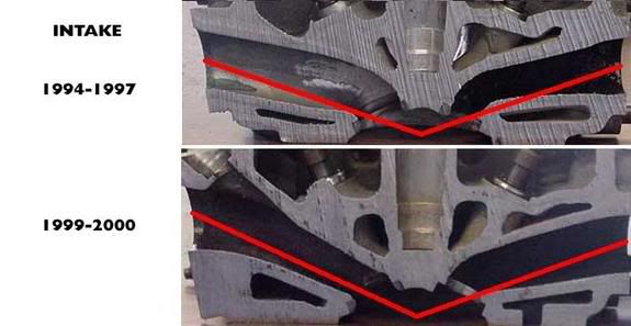

Is 99 the only year that they produced the head that flows best out of all of them? I don't suppose it falls into anyother years?
What would you have to pay to get one?
If this was fitted to a std 1.8 bottom end with a MS DIYPNP that enables removal of the maf what bhp could be expected?

iwas also the intake thing which made a differnce.
As the man says the intake path is straighter on the later heads.
The VICS system in the intake manifold also helps gain some low/mid range.
These heads were fitted to 99-00 1.8's.
You'll need the head, intake manifold and fuel rail.
Price no idea.
I've seen em go for ?100 and i've seen em go for ?300.
Power gain i'd expect 10-15bhp from both mods with a decent tune.
