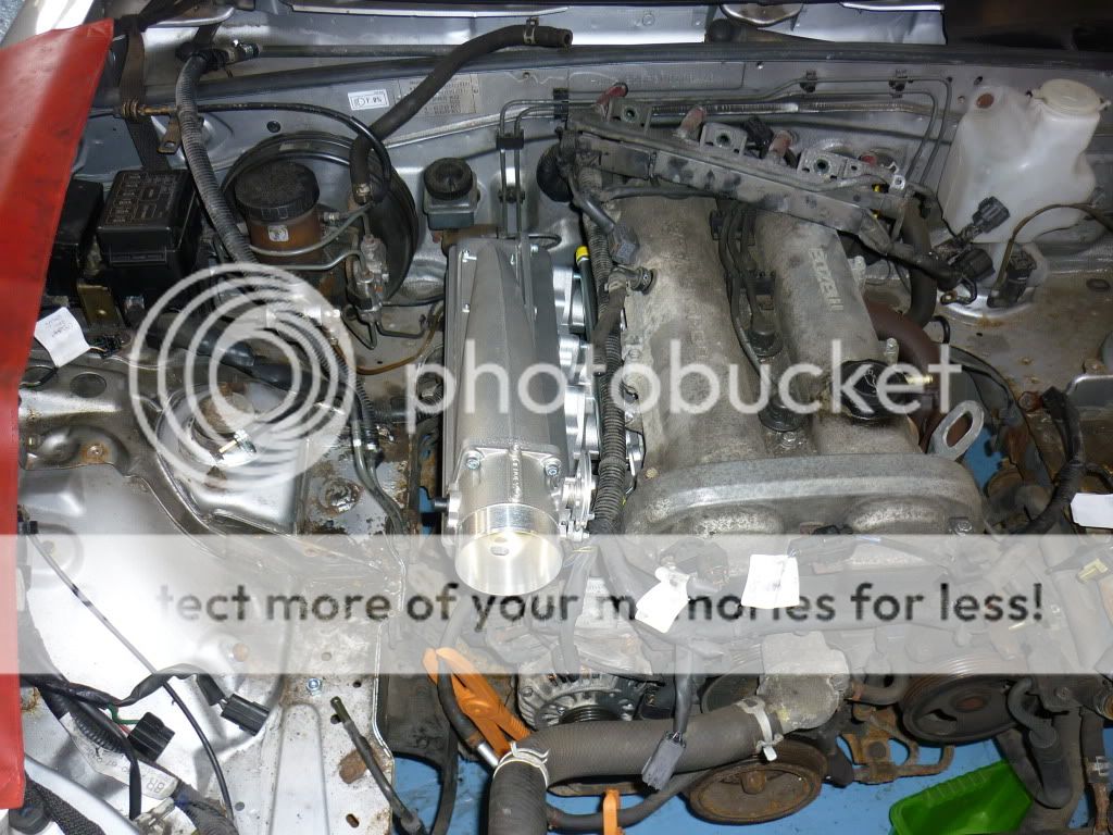

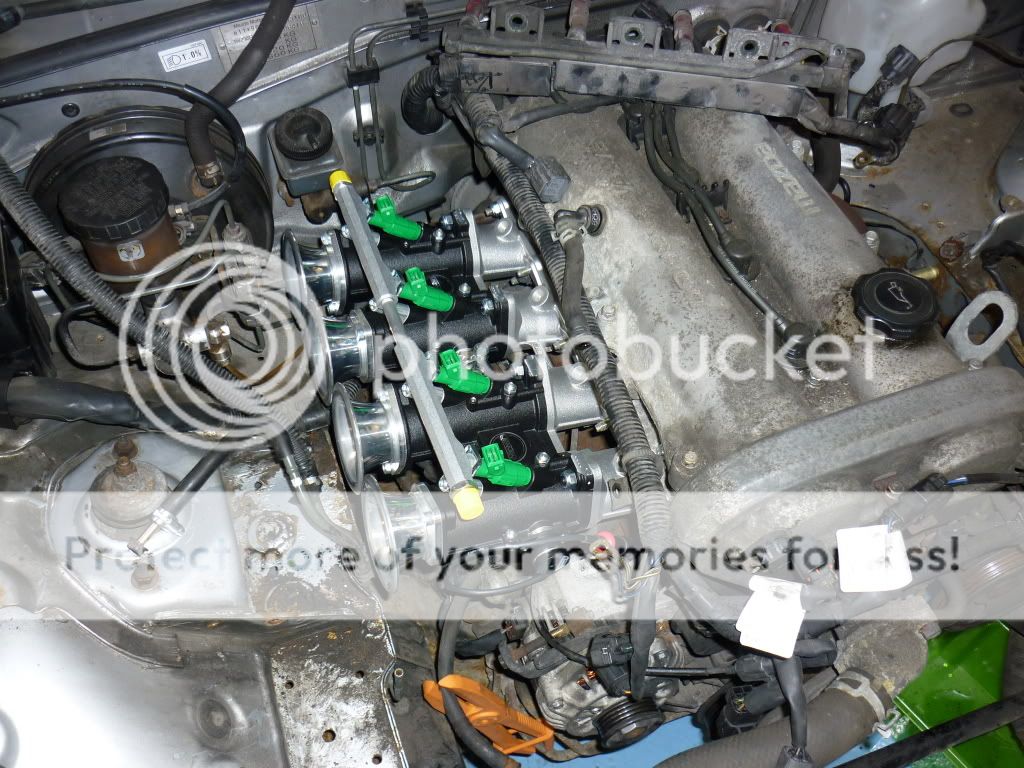

Ok, here we go!
Today I had a good chat with Simon from Jenvey who has my inlet manifold and TB set sitting on his desk! :woohoo: He has sent me a couple of pictures of what Jenvey are now offering as a standard kit so this is available to all and sundry from now on. And the great news is that there is a kit for FI cars as well as NA cars.
The first picture is of a NA kit on a 1.8 development car.
The air horns are 40mm air horns to obtain clearance from all the standard bits you find in the engine bay. Because I don't have anything to worry about in that regard I will be using 90mm air horns to gain a bit more power etc. :whistle:
For you FI guys Jenvey have made this set up
Not being an FI chap I don't know how this compares to a typical set up but the injectors go in the inlet manifold instead of the head which I beleive to be an improvement and also the plenum chamber is designed for FI rather than a NA one converted to FI.
Cost wise both kits will be £611 plus vat and include manifold, throttle bodies, fuel rail, and air horns. Also included will be the plugs to bung up the injector ports in the cylinder head. For us NA chaps, the TBs are 45mm bodies and are good for flowing for 250 bhp.
I weighed the OEM full induction set up on my 1.8 engine and it came in at about 12 kgs. With this set up I am expecting about a 75% weight loss item for item. Works for me. :goodjob:
Some other developments that Jenvey are working on include doing a 1.6 engine set up in the near future so don't feel left out if you have a 1.6 over a 1.8 engine. I also know that Jenvey are working with OMEX the ecu guys to do a complete package of inlet system (as above) and ecu electronics to replace the OEM ecu so no more piggy backing ecu's. Don't know the cost of that yet but I am sure if you spoke to Simon at Jenvey he can guide you as to the latest developments of that package.
Oh and one last exciting this..... If you are a Nutzer or MX5 OC forum member, Jenvey will give you 10% off the prices I just mentioned above. :goodjob:

Cracking stuff, certainly looks like well made kit at a decent price from Jenvey as ever...
Only concern on the FI stuff. I used to have a TB's and FI'd setup before on a Pug 106, and it was a nightmare to setup and get drivable.... the throttle was VERY sensitive due to opening 4 TB's instead of one all at once, made slow speed driving hard to modulate the throttle on.... Looks nice though! ^_^
Regards Bez

The FI plenum has a single TB doesn't it :confused: Looks that way in the pics :paperbag:

I would say you have it right Jon, a single TB for FI applications.

Great news about ITB's and seriously capable price! That quality looks great!
Malcolm you said that you will be using 90mm air horns? How will the #4/closest to brakebooster fit? I had maybe 20mm space between the horn and brakelines in my fuji racing ITBs, you dont have brakebooster?
