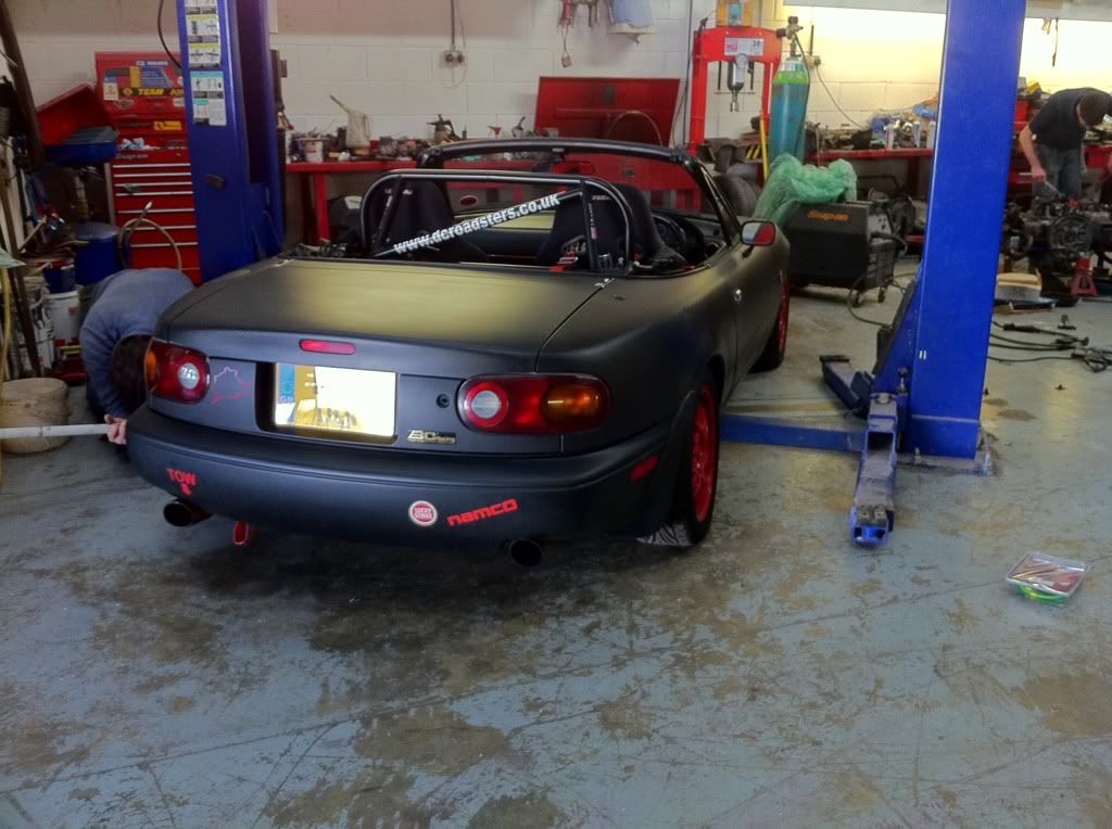

A 375mm x 165mm plate fills the Eunos plate recess entirely. Like this.

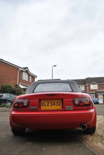

this is 12x6.5
