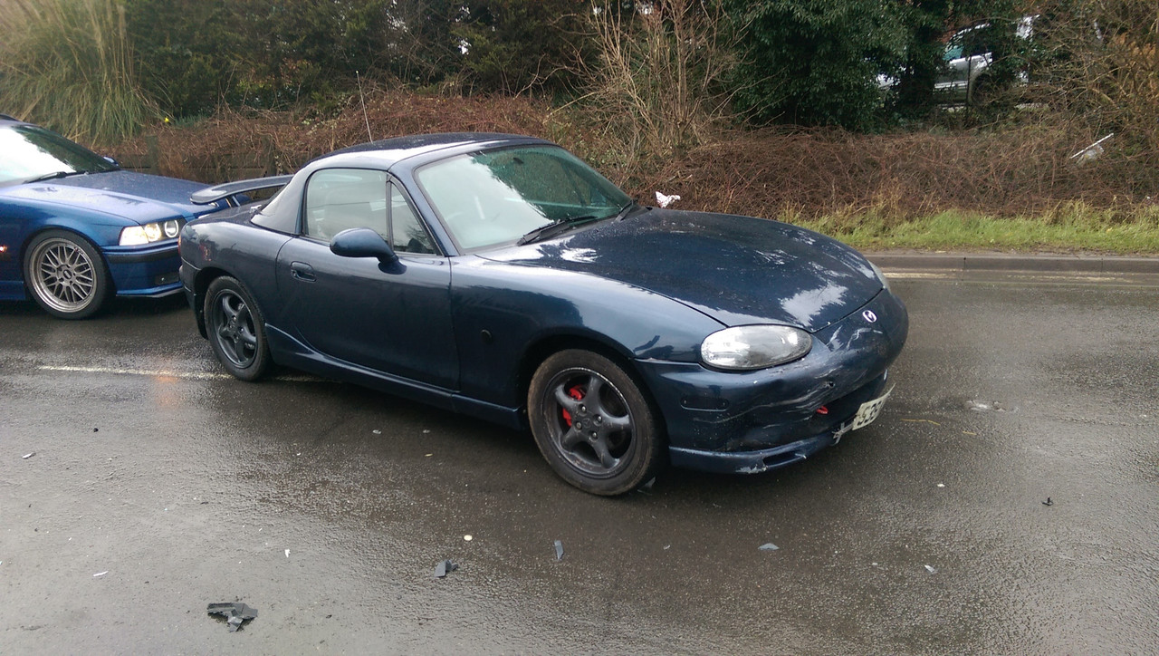

Also, I would hold off as I wager the car will be written off for those panels unless you can get them to agree to using used parts. The small amount of damage you see below was calculated at over £3500....
What exactly do you need to paint? The inner plastic is easy, you remove any screws, bulbs and rubber, bake the light in the oven to warm the adhesive then pull the lens off. You can then remove the inside and paint it. I would recommend against tinting the lens if that's what you are asking, but to do it you would just sand the lens to a smooth finish in 2000 grit, then spray a 2k clear coat over it with a small amount of black mixed in.
