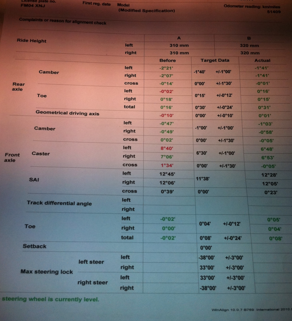

Fitted my suspension the other week, went in slot easier than the original stuff came out. Quality looks fantastic, hope to give them there first test in a couple of weeks time at an airfield day to hopefully get them fully settled before a full geo down at WIM.
couple of quick questions, what damping settings are people using? My car is a track only car, so no on road driving so am wondering what people are using so I can have a bit of a starting point to work from.
Also what ride height would people suggest to have an optimum track height, ie level wishbones, think the settings above are a little low, looks good though, car is not at home ATM so cannot measure, did when they first went on but didn't write it down, pretty sure it was as above though 310 and 320, thinking it should go to 320 front 325-330 rear, sound about right?

#19 · (Edited by Moderator)
Andy here's my geometry from WIM
Will figure out what the dampening was set for when I was on the track and post that up
